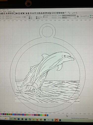

I’ve been reading, watching videos, and trying various things for 5 days now, and just can’t get this. I know it’s me, and I sure will appreciate some help. I’m so confused about this that I’m not even sure how to ask the question anymore. I am trying to make a Christmas ornament with a dolphin jumping out of the water. (photo attached). I am hoping to have the laser cut out the “sky” area above the dolphin and water. I made the ornament, and traced the dolphin for the cut lines. Lightburn wouldn’t weld or join (boolean and weld are greyed out) the dolphin to the ornament, so I tried tracing the dolphin, saving the trace as a separate file, and just joining the dolphin itself without the trace to the ornament. Weld and boolean tools are still greyed out. The photo here does show the bottom part of the water showing on the ornament which I thought welding or boolean would get rid of, but since they were still greyed out, I then tried cropping the dolphin/water into a circle the same dimensions as the ornament, but that didn’t work either. Are y’all as confused now as I am??? Thanks for any suggestions as to what I’m doing wrong. I’m sure this must be really easy for someone.

You cannot weld or join an image to a vector object.
James is correct, Trace the image first, then you will be able to use the produced vector are with the boolean tools in LightBurn. I provide a few resources to assist. :slight_smile:

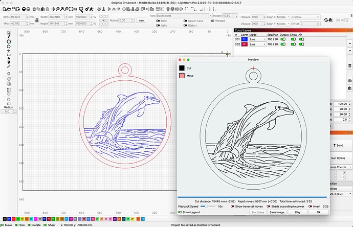

@lschaerer, I took a wack at it. :slight_smile:
(Just the art in line form, you will need to do the cut settings that best match your laser and needs.)

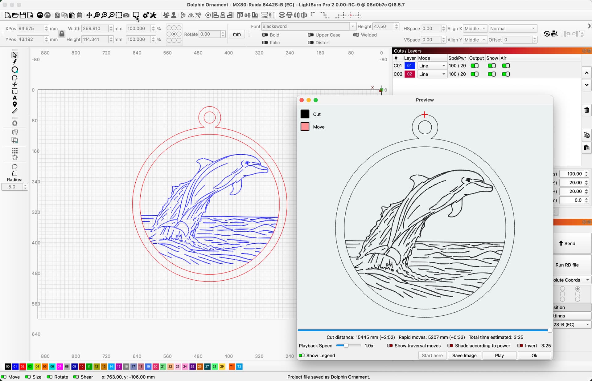

I traced the dolphin picture to produce a vector version, deleted the original, then reproduced the ring with hanger hole and used Boolean Tools to connect the vector dolphin to the ring, which trimmed out the undesired waves.
Dolphin Ornament.lbrn2 (612.8 KB)
@Rick Thanks for all the trouble you went through doing that. I think I may have done that once, but didn’t delete the original. Three questions: Two of the responses above indicated that a vector object can’t be joined to an image. Does that mean that the Christmas ornament shape is a vector, and you had to make the dolphin into a vector to join them? (Sorry, there’s a reason I didn’t go to computer programming school. This is so much like math to me which I barely passed in high school many years ago). Secondly, how do I now get lightburn to make a cut line to remove the “sky” behind the dolphin…trying to make a 2 layered ornament. When I tried that earlier, the trace/cut lines were everything in the dolphin and waves. I’m hoping to have lightburn/laser engrave the dolphin and water, but cut out the sky behind, so that I can glue it to a solid ornament back with a sunset scene. And last, in watching all the videos, I saw that people downloaded photos from places like Canva to make layered ornaments, and would join the different photos to the ornament shape. What made my dolphin photograph different than shapes downloaded from Canva so that it wouldn’t work?

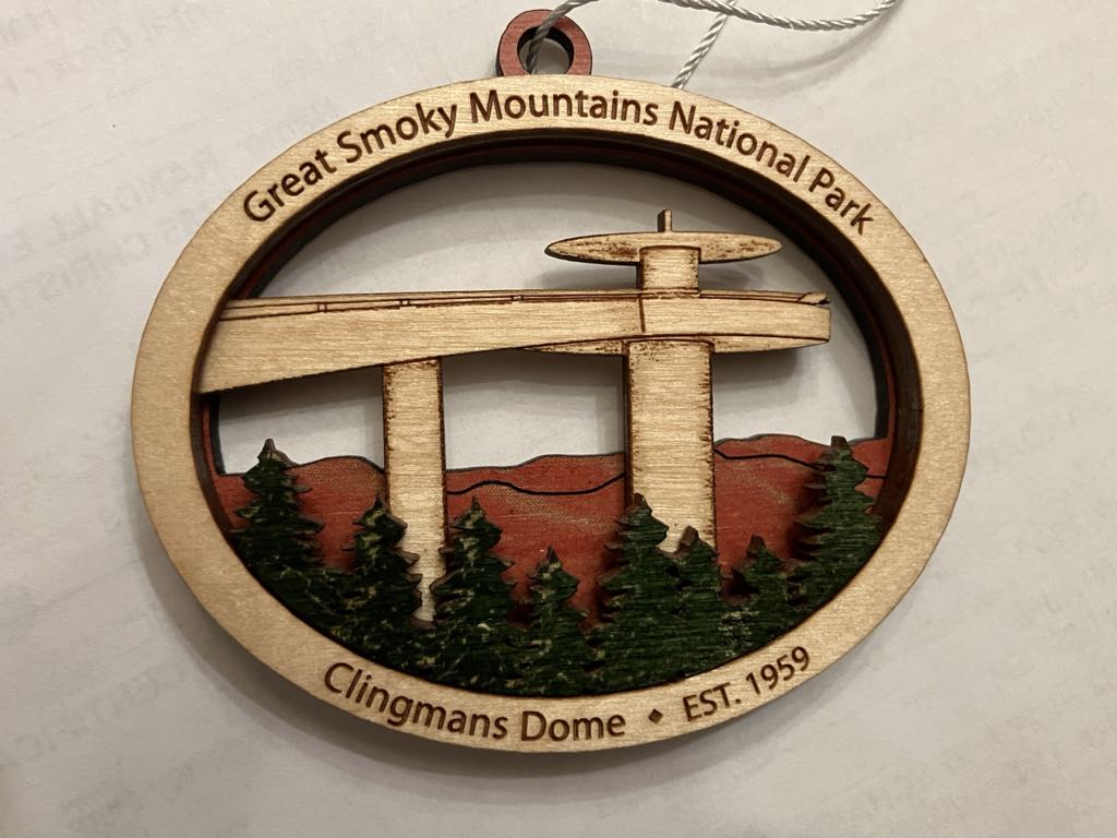

This is what I’m trying to do with my dolphin ornament. This particular ornament is 3 layers, but I am just trying to do 2. Maybe more layers would be easier, not trying to group so many things together to engrave and cut at one time??? I can’t tell for sure, but it is possible that the bottom layer is the ornament with mountain background, the middle layer is just the ornament shape cut but with “Clingman’s Dome” cut out separately and glued to the mountains, then the trees glued onto the top of Clingman’s Dome with the top ornament shape glued to the middle ornament shape. I was assuming that each ornament layer and it’s image were each cut and engraved as one piece. Did I make that clear as mud?
Hi Laurie

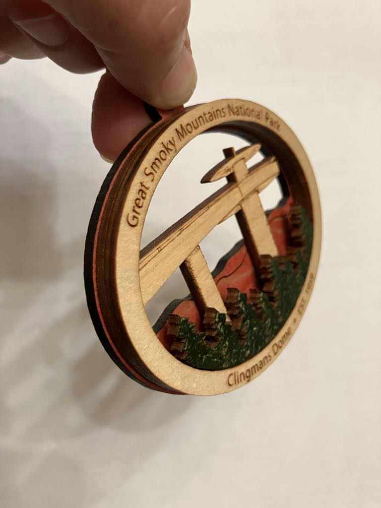

If you look close at the photo above, you will see the ornament is three layers glued together.
