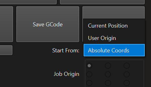

There should be functionally no change between Core and Pro - the only difference is that Pro enables the control of DSP and Galvo lasers. Did you add another laser to your workshop that requires this?
Alarm:2 is the error for machine traveling outside of the boundaries set in firmware. If you home your machine, does everything home as expected?
Can you Save Gcode in the Laser window and attach it to a reply to this thread, so we can look at the code that’s causing the error?
Alarm:11 typically indicates that the maximum number of characters per line in the G-code has been exceeded, which should be visible if we open up that gcode in a text editor.
I would suggest turning on Absolute coordinates, and see if you get the same error:
