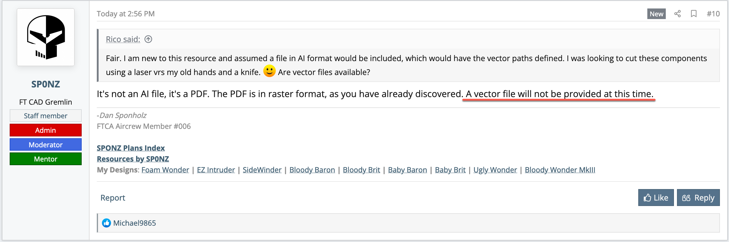

Unfortunately it’s as I suspected: This one is a raster format PDF rather than vector format. You might be able to perform a centreline trace in Inkscape or similar vector graphics app which will then enable you to do what you want.

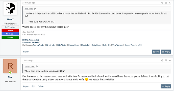

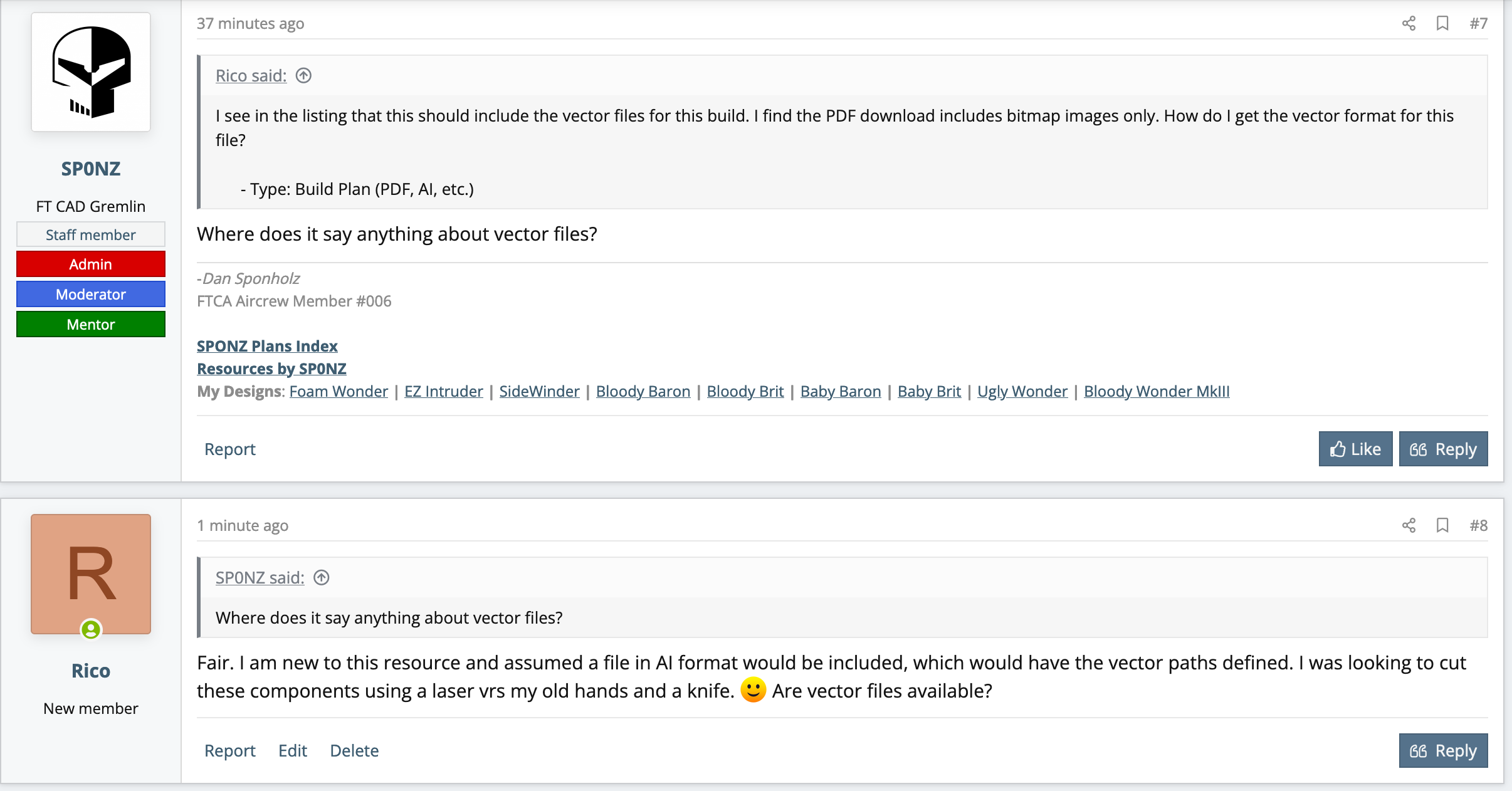

I had not registered, nor downloaded or reviewed this file directly. I have now, and note, I too am not finding the vector version of this build in that download. Odd, as they do say it should be included. I have posted on that site asking for an explanation and how we can access the vector version of this build.
Will update once I receive feedback. :slight_smile:
Update:
Thank you, we look forward to a reply from Sponz
You can post to that thread as well. Might help to show there is more than one wanting to cut these using a laser. :wink:
Update:
