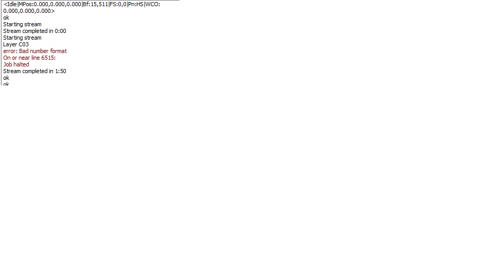

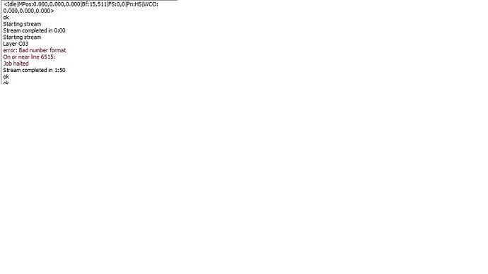

When the Job Halted error message comes up, select and copy the text from the Console window where the error message appeared and paste it into a reply here.
Then, in LightBurn click File, then save GCode and save the file somewhere handy. Change the filename to end .txt and attach the file here or send it to me as a direct message here.
It should be obvious when I look at the line of code. If the error doesn’t occur or if it’s not obvious then it may be some noise or static electricity causing data loss.
Thanks John, will probably be next weekend before I can get to it but I will definately get the info your asking for. I had a suggestion from another site that recommended I replace the usb cord to the laser with a higher quality one then what came with the Genmitsu. That may be cause of the noise you mentioned, so I will try that also.

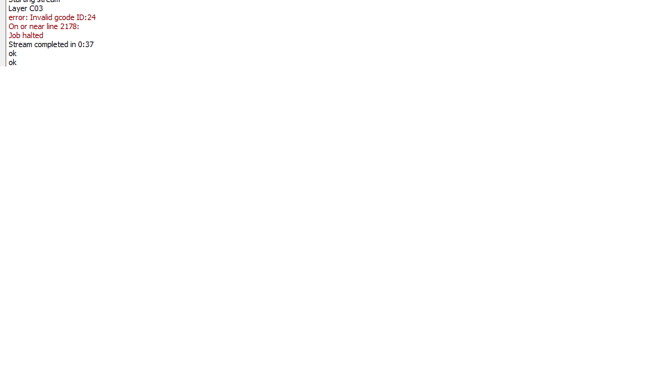

here is screenshot of error code, it is not always the same line number. Also the gcode file.

looks like it only changed the message, but same results. I attached copy of message again and the gcode.

The saved GCode file looks fine. It’s possible the sent data is dropping a letter or a number out of the line. If the Genmitsu forum recommended a better usb cable that could be related to data loss as well.
With a GRBL profile selected, we have access to a Device Setting to control the baud rate (communication data rate). Click Edit, Device Settings and if it’s set 230400, test with 115200 or even as low as 9600. It shouldn’t need to be that slow but it’s good to test. Click OK at the bottom of the window to save the change.
If that doesn’t address this behavior, or if the engraver won’t down-regulate and communicate more slowly, changing the cable would be a great next-reasonable step.
