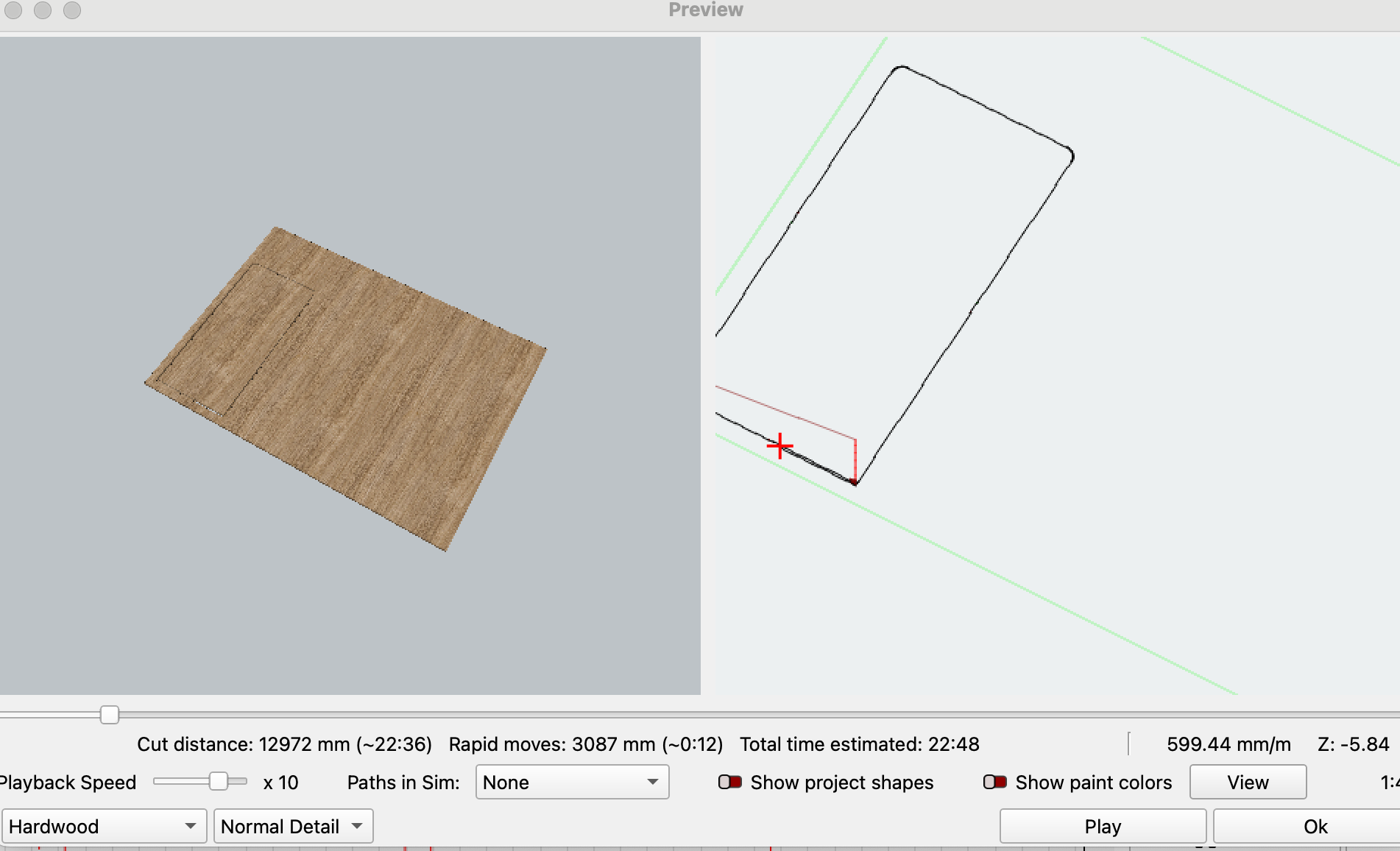

I’m unsure how to show where I want the starting point to be. But its in the bottom of the rectangle. Ah, here is a partial screenshot. There is an arrow at the bottom line of the outer rectangle. I appreciate any ideas.
Thanks

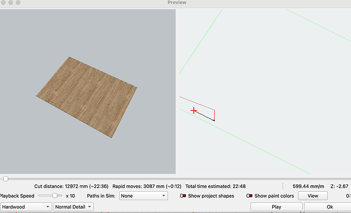

Something else I just thought of. Perhaps a screenshot of the Preview will help. Interestingly, the preview shows the starting point NOT where I manually placed it but where MM places the starting by default.
Here is the preview running more so its clear to see the corners of the rectangle and where the insertiong point it. The insertion point is clear NOT where I told it to - or atleast thought I told it.

In your image, I do not see a node at the location of the blue arrow. MillMage need a Node at that point. Did you insert one there before trying to assign it as a Start Point?

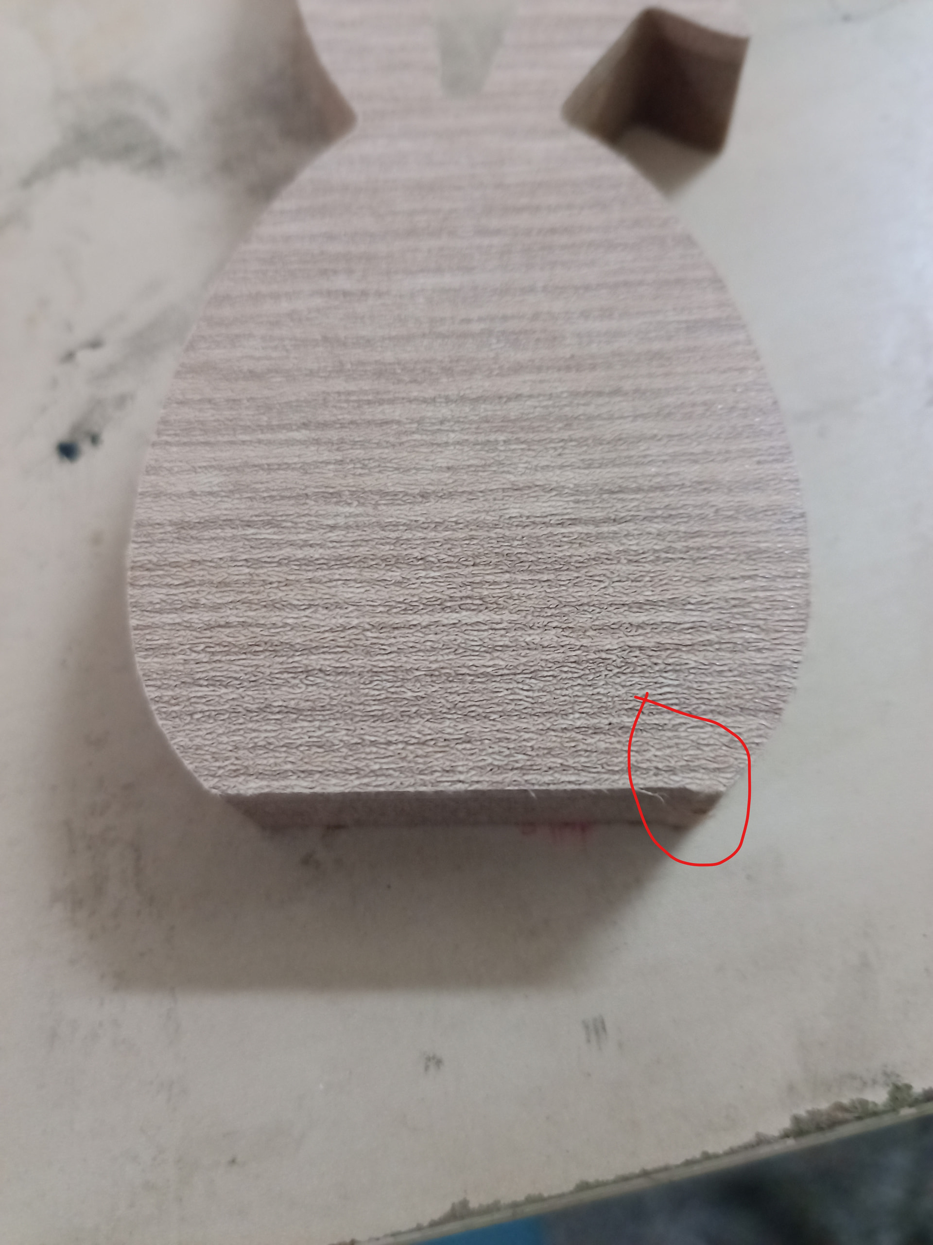

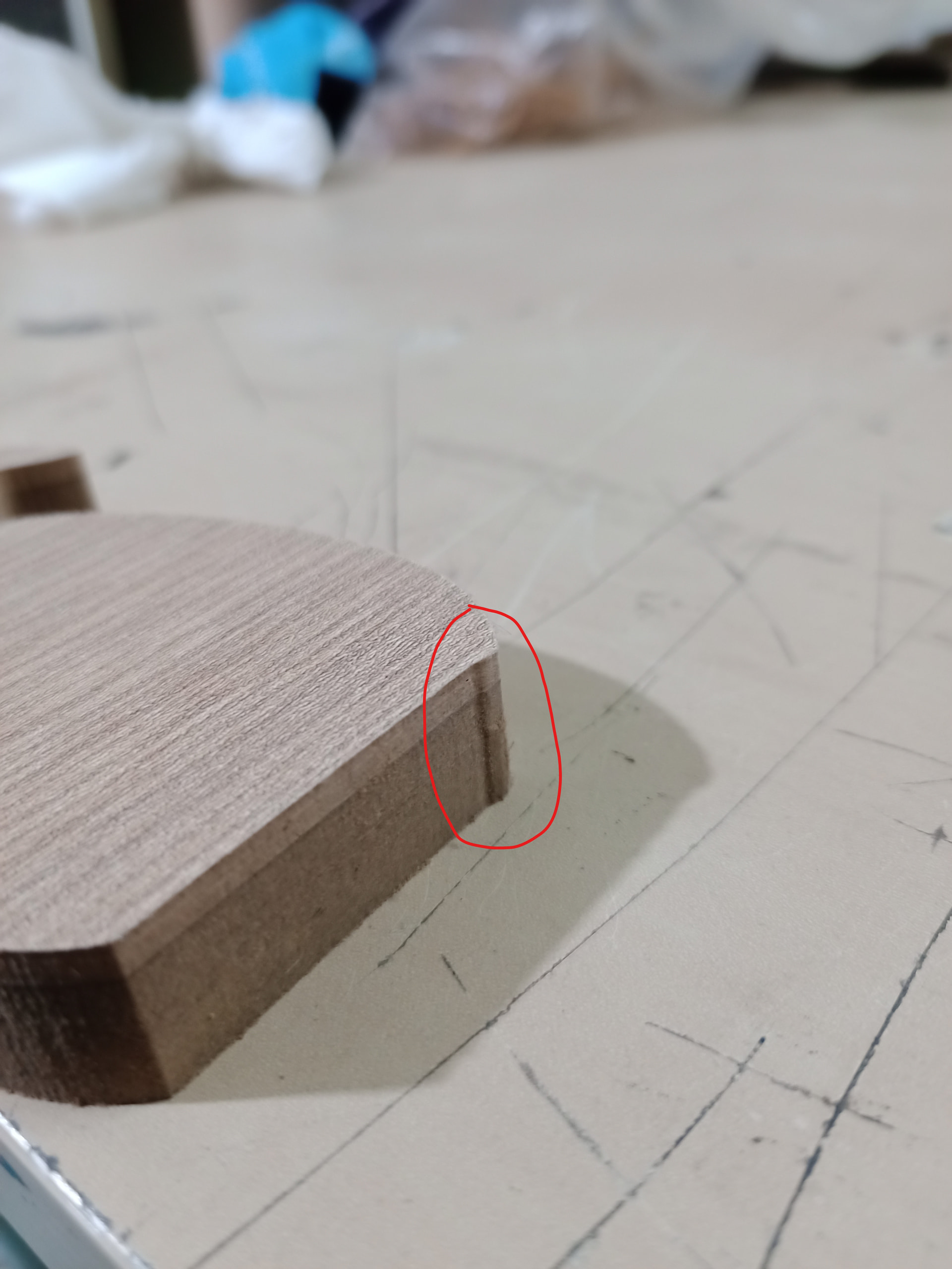

the problem is not the start point but in the program algorithm. I cut the same piece with mach3 (with code from Aspire with zig-zag and it came out as it should). When I cut I use Spiral. However, the program is still in beta and in this way it gives me three passes instead of two with Spiral.
Have you tried it with Vectric? Aspire is a 3D program for $2K, and it would be difficult to make a 1:1 comparison. MillMage is a 2.5D program, so we should use similar programs for comparison.

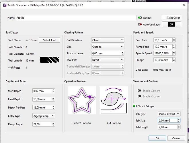

@fotis Your settings are very unusual; 1.5mm tool diameter, 12mm tool length, 16mm depth and 16mm Depth Per pass - are you using a different tool than specified in software?

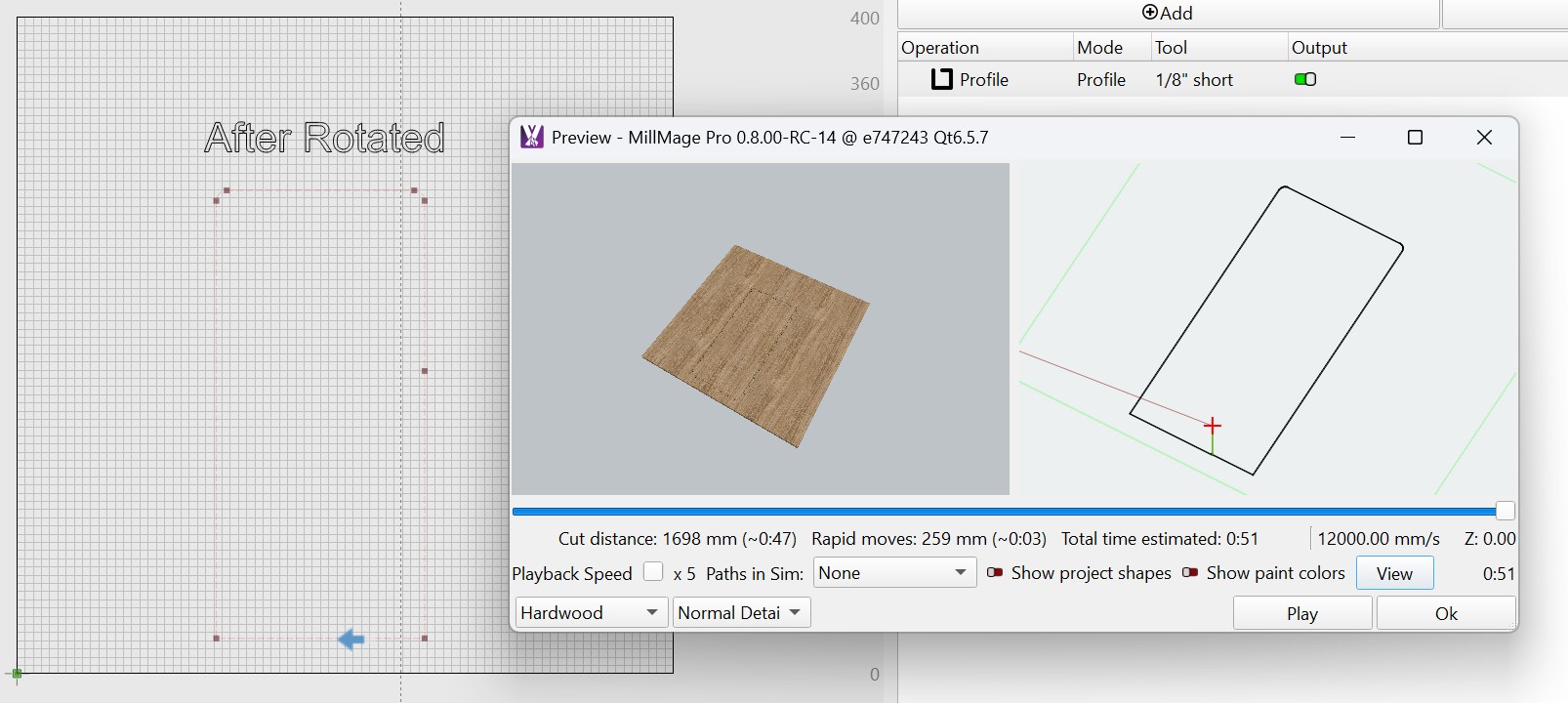

I copied your left outer box to a new instance, added a similar tool, and played with it. A lot. I thought it was Tabs, but that was not it. I played with new Start Points, was not that either. But when I rotated the rectangle 90 degrees using the period key, the Start Point showed up in the correct location using Preview. However, when I went back into your file, rotating it had no effect.
I am guessing the algorithm that computes the cutter path overrides the moved Start Point due to the multiple shapes in the drawing. Why it does this is beyond my pay grade.
