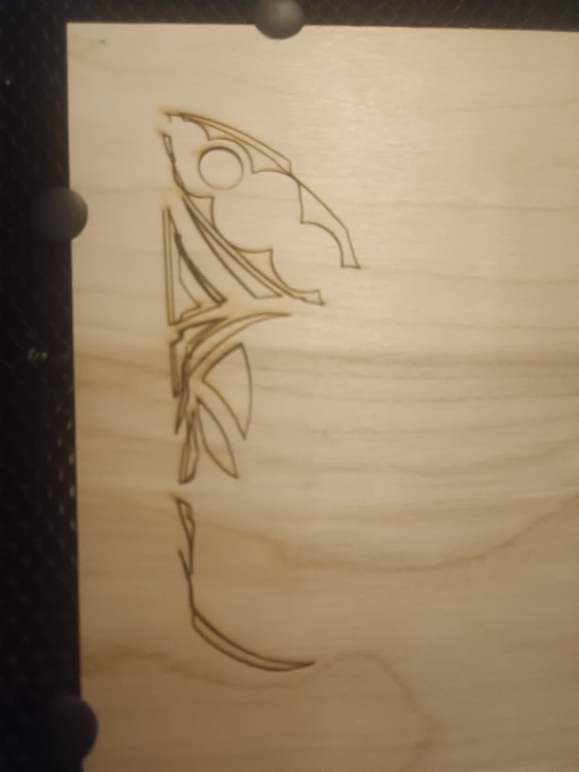

I have a big problem with my lines. I assume that it is the laser but how to fix it? I’m running on T2 from TwoTrees

It would be helpful if you explained what the problem is, because a blurry picture doesn’t provide much information.
AFAICT, the machine has mechanical problems, so checking for loose screws all the way from the motor shafts to the laser head will probably help. Make sure the belt tension is correct, neither too loose nor too tight.
This guide was written for Sculpfun lasers, but gives a good indication of what to look for and how to verify the results:
