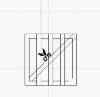

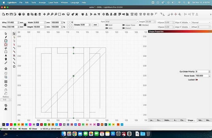

I have a few squares and lines and now want to cut different lines with the scissors, but it doesn’t cut, it just extends the line to the edge of the work surface in Lightburn.

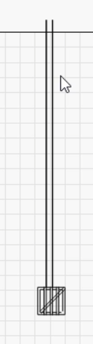

After cutting with scissors, the lines extend to the edge of the work surface.

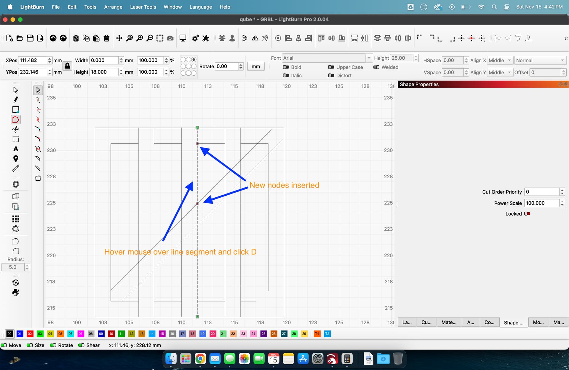

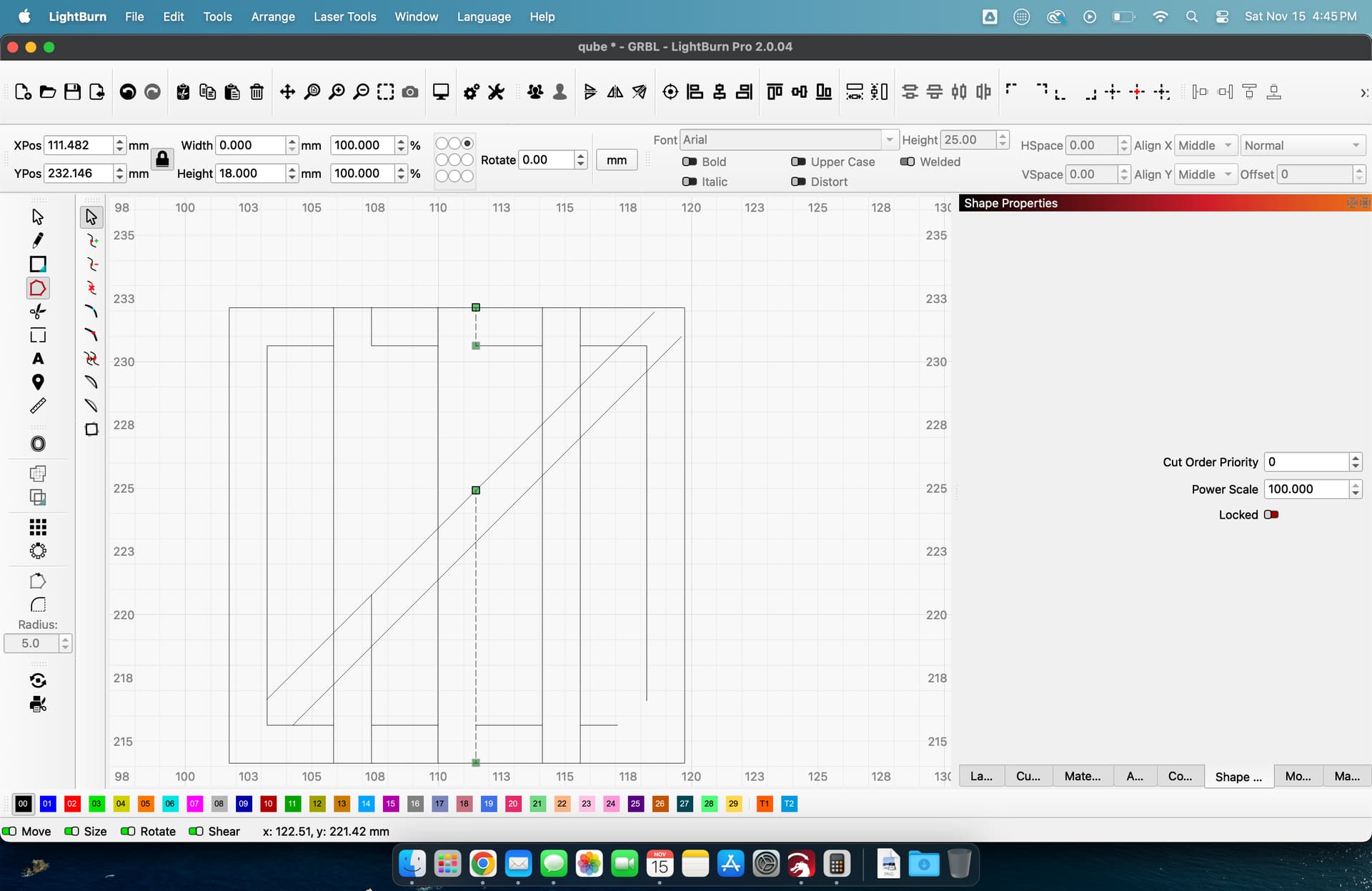

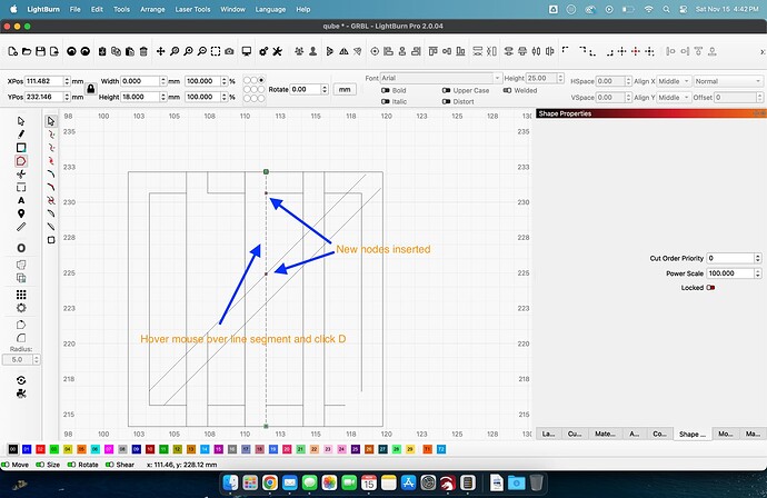

I can verify that it’s doing what you say. I cannot explain why. The workaround is to use the node editor instead of scissors. Select the line you want to work with, click node editor, hover over an intersection and press the I key to insert a node at that point, insert a node at tne nextr intersection point then hover over the section you want to delete and click the D key.

Thank you very much. I did exactly as you described, placing dots and then deleting the line with D. Another solution was to restart the PC, then start Lightburn and redraw the object, and then it worked with the scissors. However, I keep encountering this problem with the scissors when working on larger projects, and then I have to set points with I and delete the line with D, which sometimes takes a lot of time. Have a nice day and thank you very much.
I have reproduced your problem here and will investigate. I can tell you that the code for the Scissors tool is surprisingly complicated, and getting all the weird math cases to behave is challenging.
So the reason this is failing is a bit complicated - The line shape was scaled horizontally to zero. (at some point you probably selected it and typed 0 in the width).
We are trying to do the snipping in the “space” that the line is in, and because of that zero scaling, the math no longer works - there isn’t a single answer.

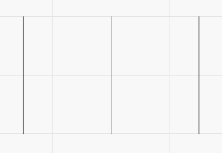

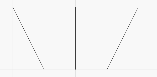

To give you a vague idea of what that means, draw these three lines as individual shapes:
If you then scale each of those shapes to have zero width, they look like this:
They are now identical - So three different shapes, scaled to zero width, all produce the same result. That means that the “opposite of” scaling to zero width has many answers, and so it breaks the math.
