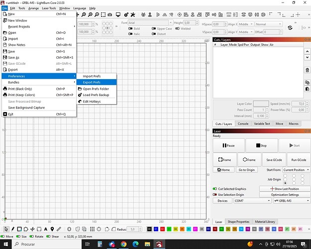

Save and keep software settings and preferences, as well as machine parameters, updated in a folder.
You can update the software if you want. If something isn’t working as it should, you have the settings and preferences saved and ready to load. Whether it’s the version you just updated, or a previous version you decided to reinstall because you couldn’t adapt to the latest version.
I have been doing it like this.:wink:
Gracias por el consejo, Kuth, pero como hago para guardar configuraciones y preferencias? Hay algun sistema directo desde LightBurn, o tendría que guardar una a una cada parámetro?

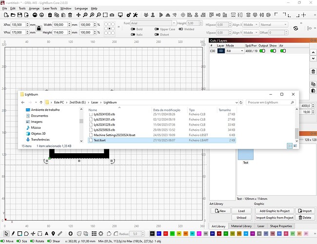

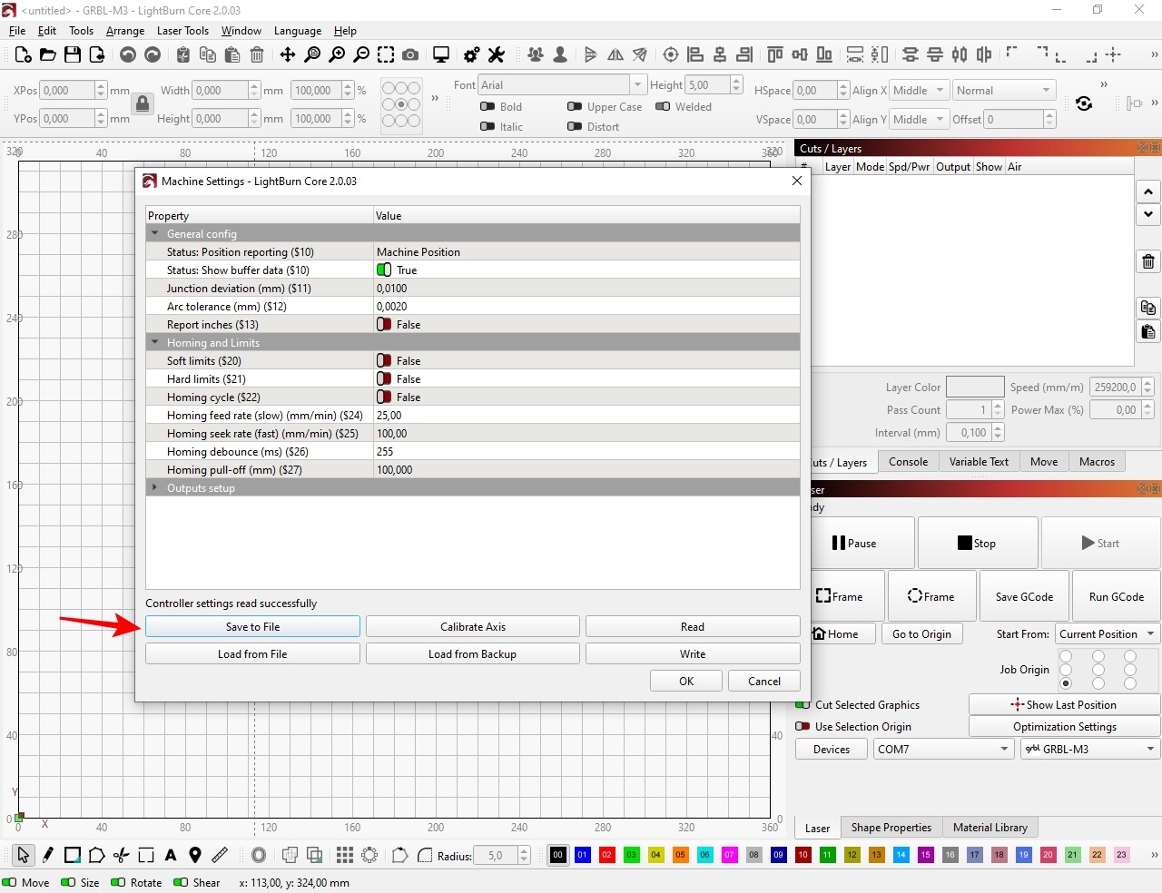

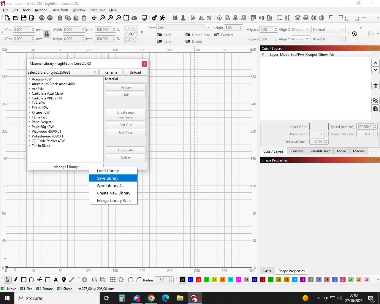

You have to save it separately.
Here’s an example:
Software prefs and settings
Machine Setings
Library/Material Settings
The Art Library you have to locate the file(s) and save it from the folder.
