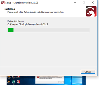

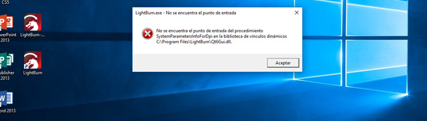

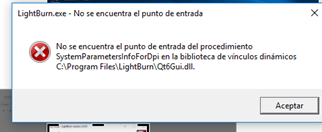

PROBLEMAS DE INSTALACIÓN

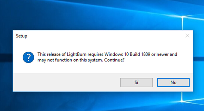

Which Windows version are you using?
LightBurn version 2.0 is not supported on Windows 7 because of the upgraded Qt6 version.
We provide a final legacy release of LightBurn 2.0 for users with earlier Windows. Please find the link to that download on the 2.0 release news page here: What's New in LightBurn 2.0 - LightBurn Documentation
