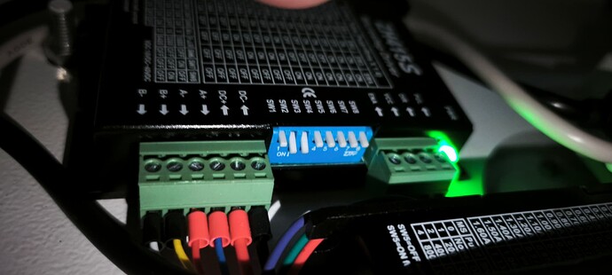

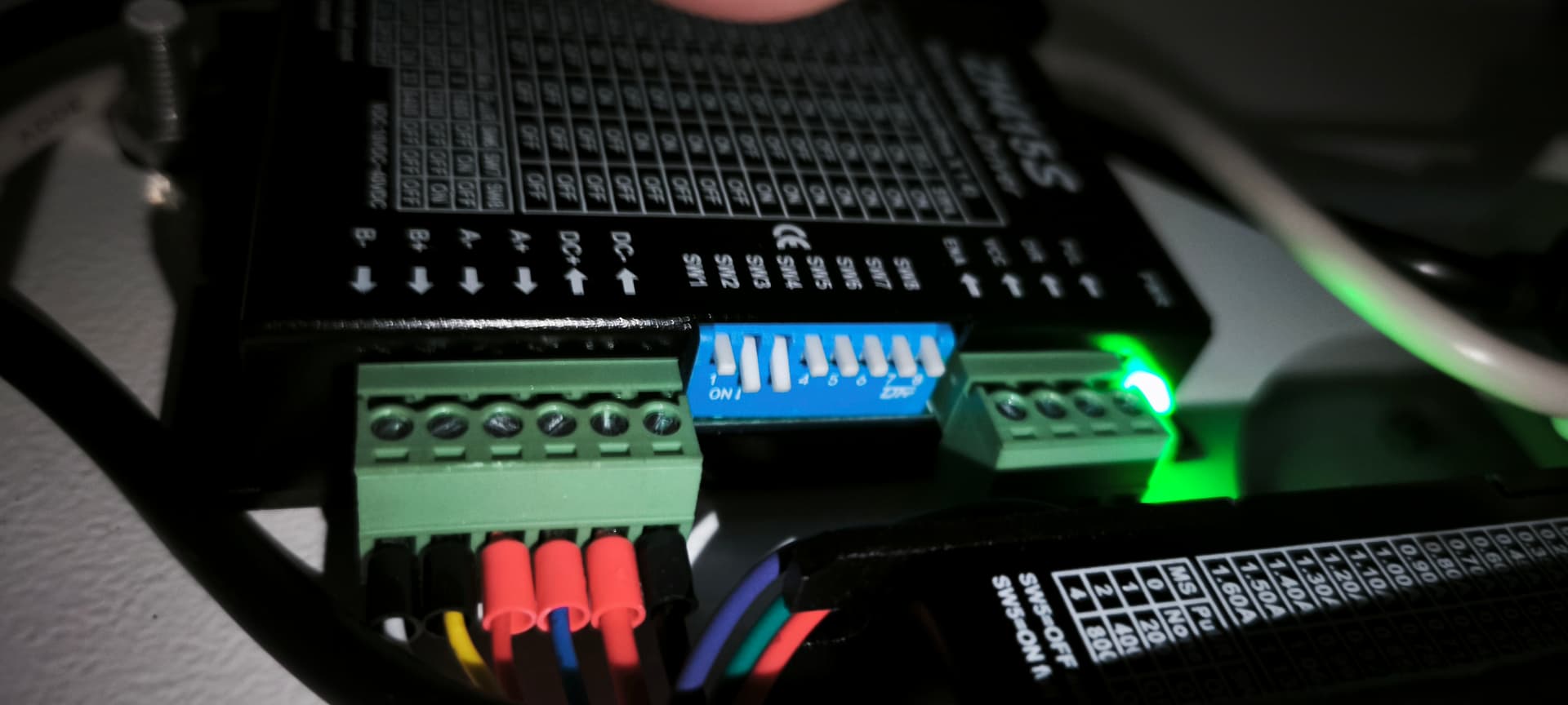

Hi Bernd,
I entered your settings into my machine, but apart from changing the “Home” from top left to bottom right, the problem persists.
I think it’s more of a Ruida motherboard configuration issue because when driving the motors directly from the machine’s controller, the X motor stops at 200mm to the right and the Y motor at 150mm.
I’m wondering if the motor controllers are configured correctly (see photo of the black case). If you have the same ones on your machine, can you tell me if the jumpers are identical?
I’ve attached my Ruida settings in case you suspect something, but given that with your settings I can’t access more than 200x150mm, I don’t think that’s the problem.

Unfortunately, I think that our controllers are not identical, there are many different ones and in order to use the whole lbset, the machines/controllers must be 100% identical. It was also meant more as a comparison file for “fine tuning”.
My Ruida clone is a “KT332N”, I’m sure there will be others here in the forum who have “your” setup and they will be able to give you information about the correct jumper settings.
Find your controller type/number, it will be a little easier for others to help.
…it will probably work out in the end :wink:

Hi, Bernd
I finally found the solution to my problem.
Actually, the motor step length in the Riuda program didn’t match the step length of the motors installed on my machine.
“Desc”: “Step length (um)”,
“ID”: “0x21”,
“Value”: 6.31
I changed the value to 3.15 to double the speed of my motors.
So everything works perfectly under Lightburn with a 600x400 working format.
