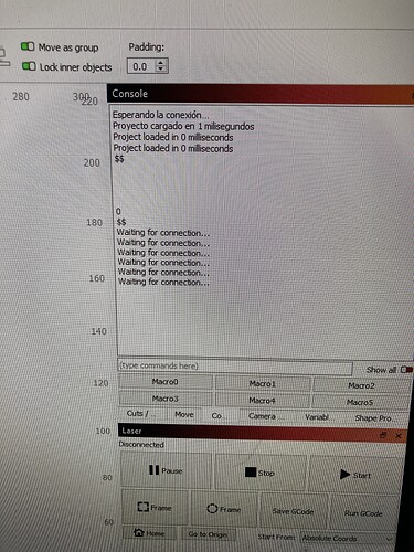

Waiting for connection appears in the console… could that be the problem?
You will need to connect in order to run a job, yes.

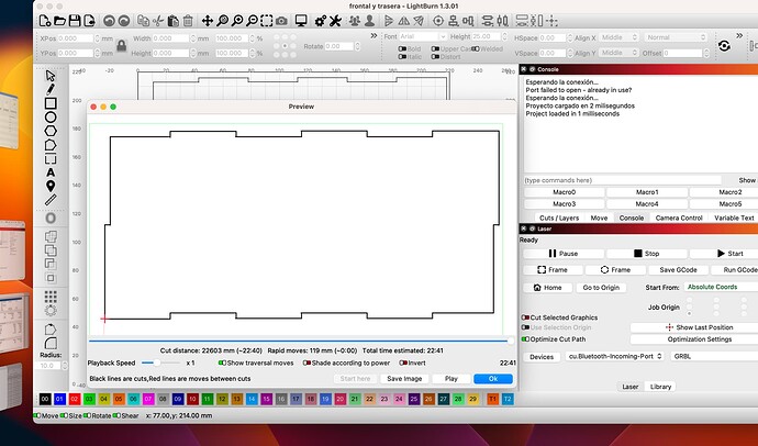

What does your job look like in the preview window? Preview Window - LightBurn Software Documentation
I think the work in the preview window is fine, I share a screenshot with you. I appreciate your help
Ok, so it appears to be generating the gcode correctly, the problem is a connection issue. Has anything about your laser cutter and connection changed between yesterday and today? Have you tried restarting your computer?

Captura de pantalla 2023-06-26 a la(s) 10.36.25 p.m. (crop laser window)
In the Laser window, at the bottom middle button, please select an option with USB Serial or WCH as an option. Watch the Console window for the connection message.
