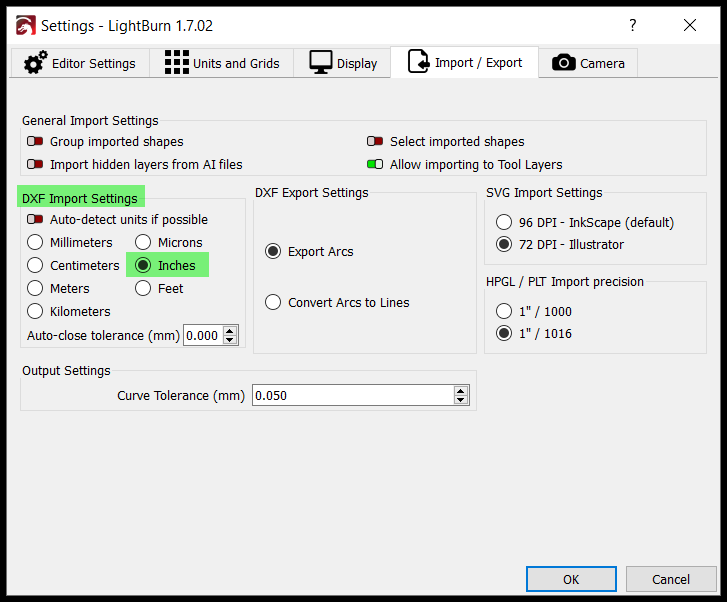

When importing dxf files, the lines become curved. Below are two screenshots, the first is Lightburn, the second is EZCAD. I would be grateful for a solution to this problem. Thank you all in advance.

It would help to know what version of LB you are using. I import DXF into Lightburn, and it works for me. I always have the auto-close tolerance set to 0, because I create polylines in a CAD program - lines and arcs that form connected shapes.

You have unnecessary fills in the DXF file. But, when I import it into LB, I get the result you wanted.
I understand. I will try to delete the program and install it again. Maybe it will help. Thanks for the answer.
No need to delete. I think I just found the problem. I had the units set to inches on DXF import and it worked correctly - shapes looked correct. When I set the units to mm on DXF import, the shapes looked bad.
Use this setting on DXF import.
Excuse me, but what size did you get for your rectangle? I export in millimeters. The rectangle size is approximately: 3.9 mm by 1.45 mm. If you export as shown in your settings, the detail will be much larger. And yes, there are practically no artifacts. But if you zoom in on the drawing, the rounding on the edges of the letters is still not correct
