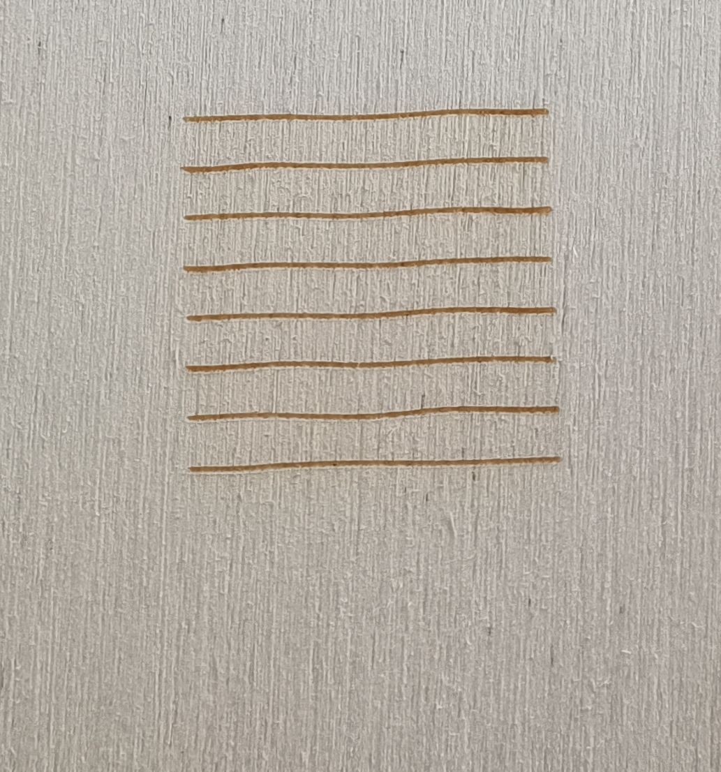

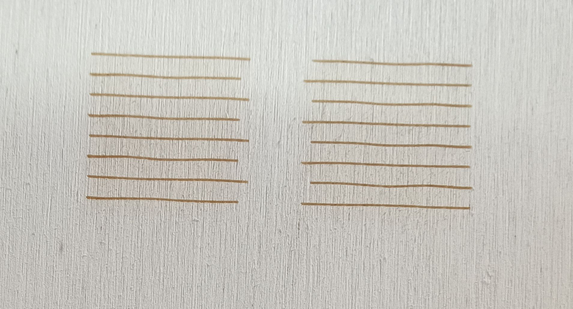

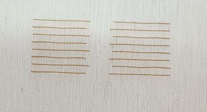

I have a problem with the scanning settings. If I put a single square, it’s fine. If I put two squares, it’s not even in the middle
Unfortunately I don’t think either of these are fine, you appear to have some rather severe mechanical issues: Troubleshooting: Mechanical Issues - LightBurn Documentation
