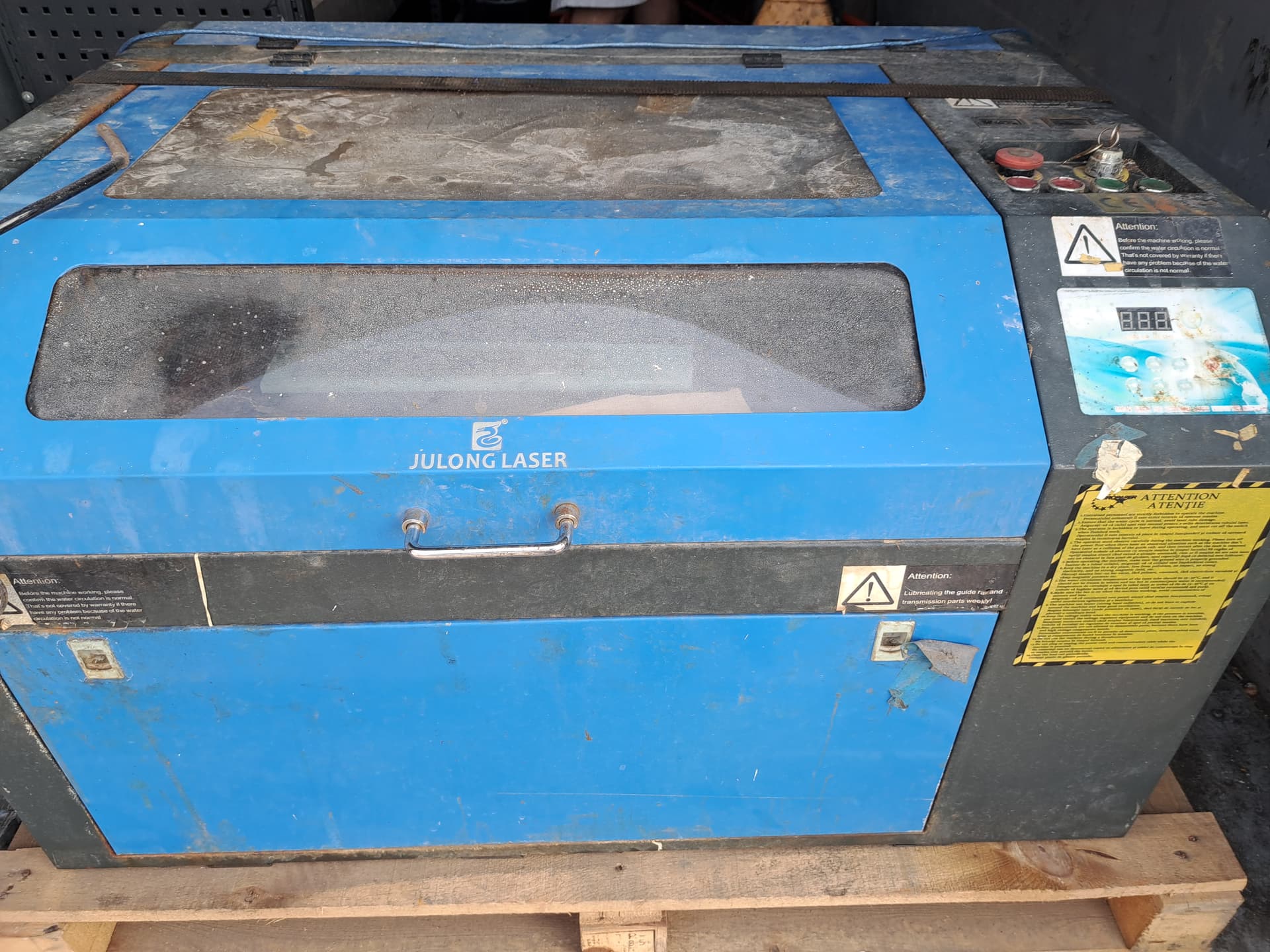

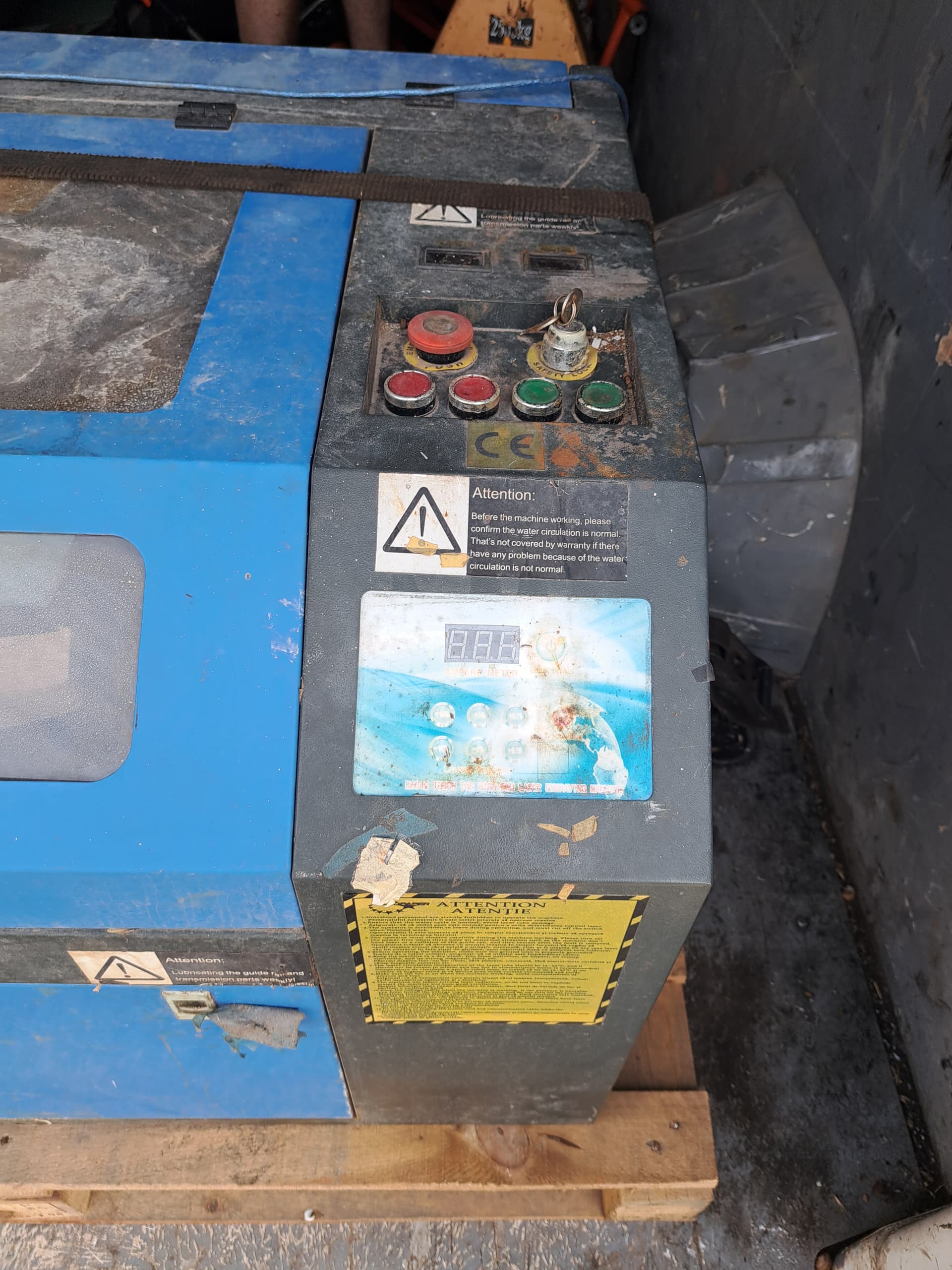

Depending on the evolution of my works, I will come back … this is how the device looked immediately after I received it, now I have just finished cleaning and oiling/greasing it. I will try to post some pictures.

From the photo this looks like one of the common “blue/black box” CO2 lasers. In its stock form it uses a Nano2 / M2 Nano controller, which unfortunately isn’t compatible with LightBurn — that board only works with the bundled LaserDRW software.
These machines also usually don’t have proper limit switches or homing. The motion buttons on the front panel just jog the head manually, so the controller itself has no sense of position.

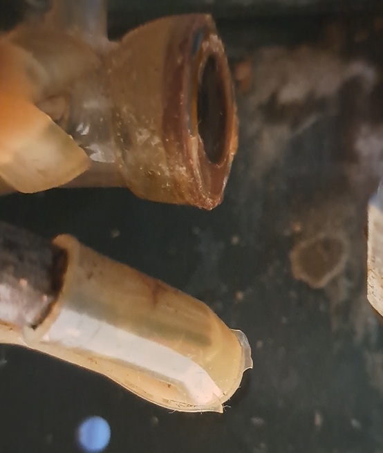

p.s. if the last photo is the end of the laser tube, I’d recommend replacing it.

Yes, indeed my 60W (CO2) Julong laser is an older model exactly of the “blue/black box” type and it is in its standard form and as far as I can tell it uses a Nano2 / M2 Nano controller and I think the software used is LaserDRW, the person who donated it to me also gave me the USB-dongle that this device works with.
I received it in a pretty bad condition and I am trying to reactivate it, I cleaned it, wiped it and then greased it and the 60W laser tube has the metal cooling part detached from the end. I realize that this defect would require me to replace the laser tube with a new one, but since I found colleagues on the forum who did this repair, I will try to glue it myself because first I want to figure out if I can make the entire device functional and I hope that with the help I received from colleagues on this forum I will succeed in this.

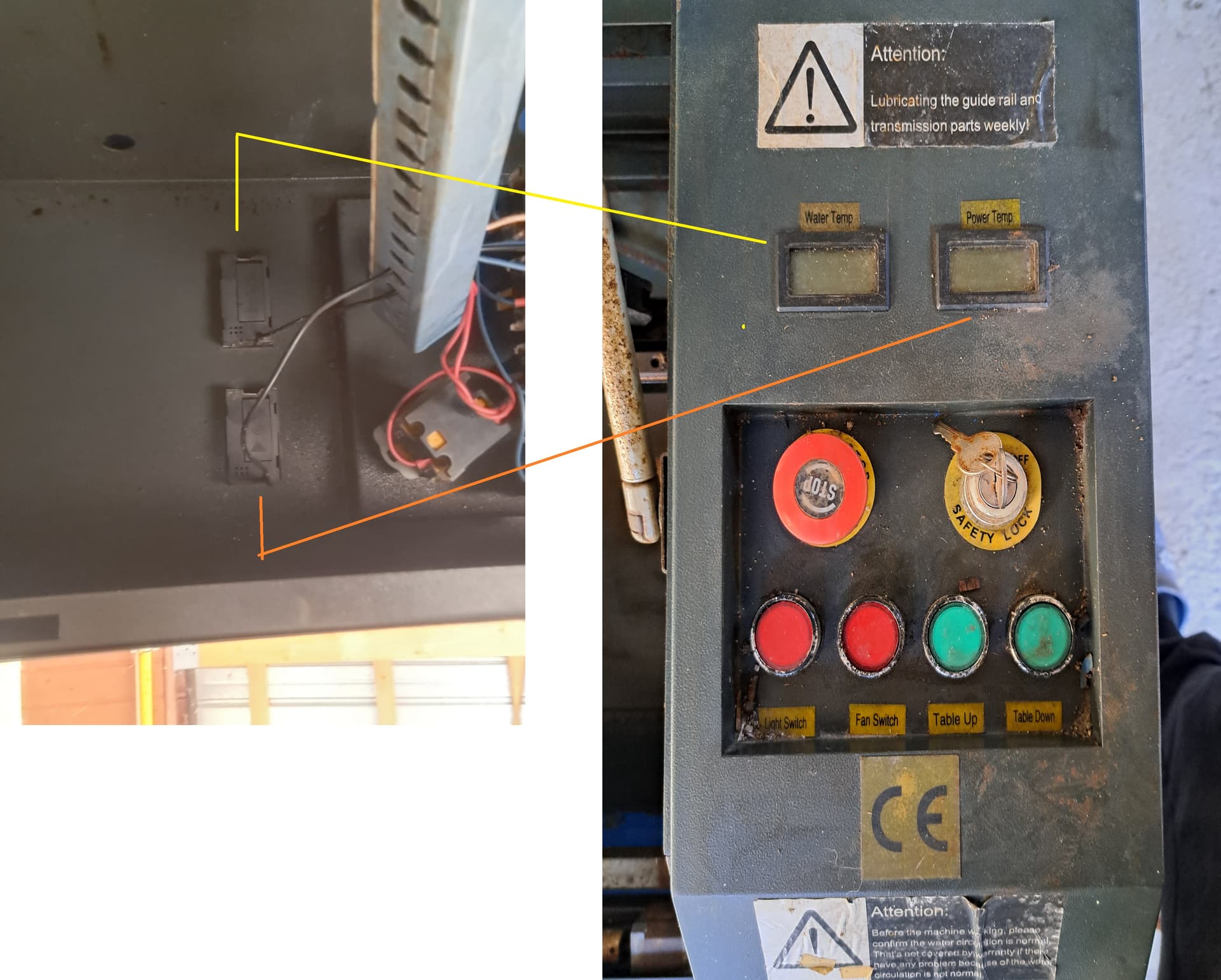

Speaking of repairs, I saw that the displays (from the laser) that indicate the water temperature and “Power Temp” each have a black wire on the back … is that OK? shouldn’t there be two wires for each digital temperature indicator?
