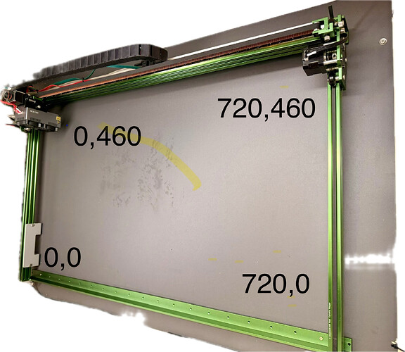

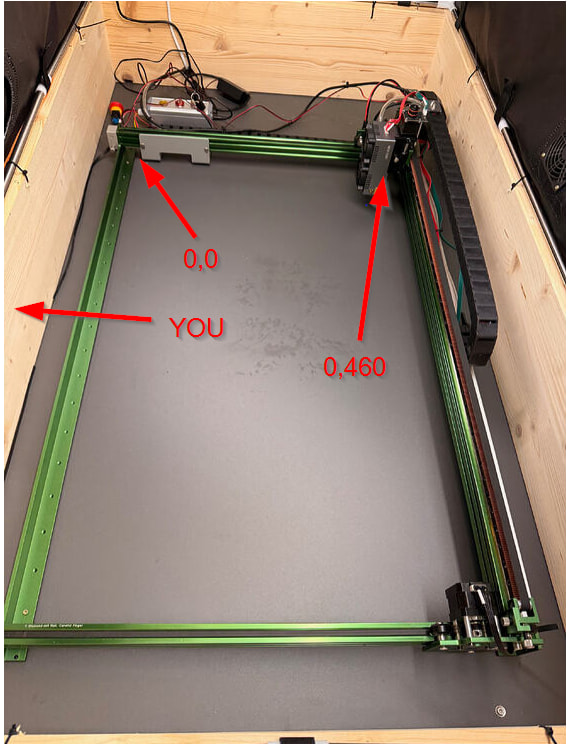

We will get it sorted. In your image, the laser homes to the bottom-left, correct? Be aware, that’s not bottom left of the laser!
It’s completely misconfigured. The bottom left corner of your laser is bottom-right in your picture. But then, x and y sizes are swapped.
So, lets start from scratch. Where are the limit switches located? Which position do you want to define as origin? Bottom-left of your picture?
Open LaserGRBL (NOT LightBurn). Set $3=0. Now use the arrow buttons. Where does the head move to?

In my previous image the laser homes to the bottom left.
The long axis should be x the short axis should be y. At least that’s stated on the NEJE website.
I homed the laser in LaserGRBL. It moved to the top left corner.
If i set $3=0 the y axis movement is inverted (top click => down move) with $3=2 (inv. y-axis) the actual movement lines up with the pressed buttons.
Home Position top left and origin bottom left is fine for me, but I take everything as long as it works :wink:
OK, then you are standing on the left side in your picture? If you set $3=2 (inv y), then everything works as expected. After homing, the laser reports 0,460?
This is correct, because you are homing to the top-left. The origin of the laser is still bottom left, 0,0. So after homing, if you send the laser to 0,0 (or 5,5 to leave some space), the laser should travel to the bottom left (top left in your picture). Right?

No. It does home to 0,460. You think that is 0,0, but it isn’t. It homes to the top-left. But the origin is bottom-left. Everything is ok. It’s defined like that in your firmware settings.
You need to stand at the side that I noted in the image. If you want another side to be the front, we need to switch motors and directions.

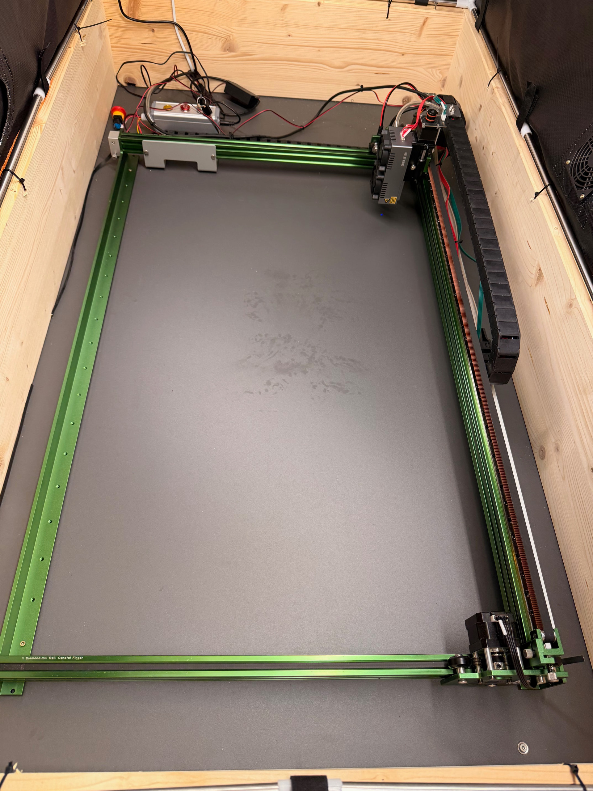

It once homed to to top left in LaserGrbl and stated 0,460 that was fine.
After that I started LightBurn and it homes to front left in lightburn and states (0,460) but that should be the origin with (0,0).
If I click origin after home it crashes in the front rail.

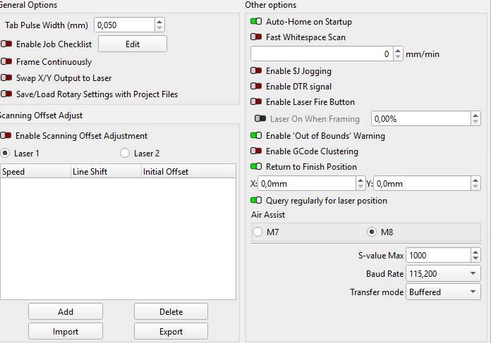

In my understanding the following values should be the right ones:
