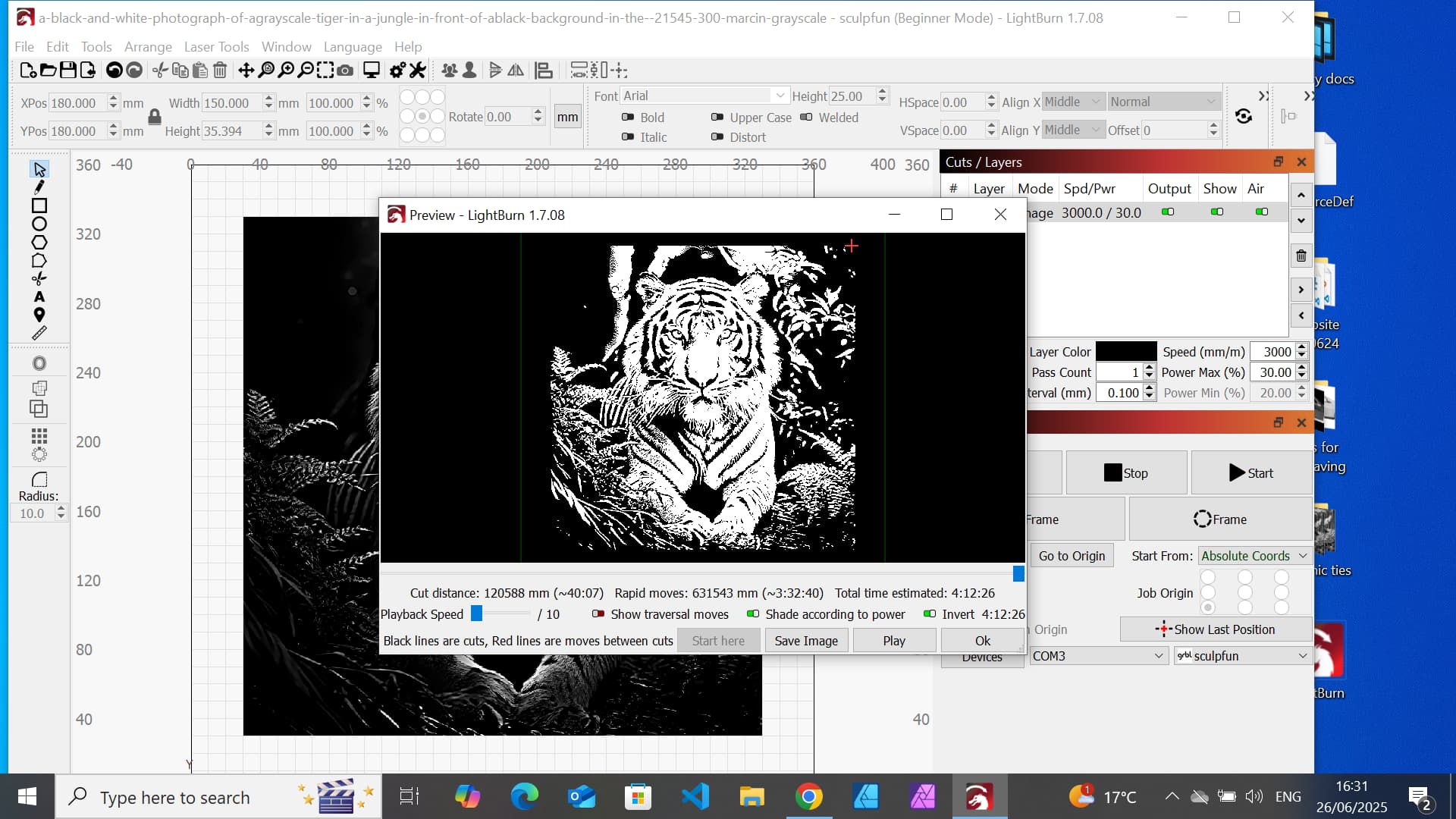

My set up is scilpfun S30 pro 20W.
I have been using lasergrbl but have found that problematic with engraving tiles.
(the tiles are painted white, gold and black). I’ve inverted the image and I’ve been using 3000 @ 30% which sometimes works and sometimes doesn’t! The maximum time has been 1hr 50mins. In Lighburn’s preview this setting gives me a time of 3hrs 54mins.
I’ve messed around with speeds and %'s for example going to 8000 and 80% (10,000 per 10%). That gets the time down to 2hrs 2mins. I haven’t done a test print yet as I have two questions:
  1. I’ve heard that when changing figures it’s as simple as i’ve shown (10,000 per 10%). Is there a formula for increasing speed and strength that gives a more accurate ball park figure for a test print?
  2. My understanding is that for maximum detail the engraving speed should be 3,000 or less. Is this the case? If not is there a maximum speed before loss of detail is noticed and if so what is it?
What I am wanting to do is to reduce the engraving time without loosing too much detail and to hav a a range for carrying out tests.
I’ve attached a screen print showing my settings and the estimated time in lightburn,

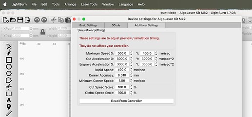

The time estimate is provided by a simulation and not directly from the controller. It’s a solid estimate. The simulation settings are under ‘Edit’ then ‘Device Settings’. When the estimates are off, it can be caused by an incorrect setting or an unexpected controller behavior. The settings can be fiddled with to produce adequate reults.

In the screenshot you’ve shared, the first thing I see is 'The Penalty of Speeding Up". The engraver spends time accelerating and decelerating after each line so it can change direction. It’s travelling almost three times further to slow down and stop and come back up to speed than it is travelling to engrave and produce the art. Acceleration is limited by machine rigidity. If the Force (mass x acceleration) causes the machine to deflect, it will mess up the engraving.
The preview is showing 3:32:40 (~3.5 hrs) of Rapid Moves. This is the time spent changing directions. If you turn on the ‘Show Traversal Moves’ switch in the Preview window you can see the Rapid moves (In Red), and any other non-engraving moves like the move from your ‘Start From’ to where the engraving begins.
The total estimated time is 4:12:40 (~3h 30m + 45m). The engraver is engraving for 45 minutes.
If you cut your engrave speed in half, the amount of time spent with Rapid moves should be halved (~1h 45m) or less.. The engrave time will double to 1h:30 but now you’re down to ~3h15 from ~4h15.
The next target is ‘dot size’. Most people believe that 600 dpi or more is great but the reality is, the engraved marks from the laser are more like drilling holes of a specified size. If you stack the holes too close together you just get one bigger hole. Folks will throw away all the contrast that would be available to them by not leaving enough space between the holes.
For the next step, pop open the Cuts / Layers settings and capture the screen to share it like you did previously. I’d like to know what was selected for Line interval or Dot size. Increasing the dot size or Line interval slashes time off both the Rapid move and Engrave move totals. It also enhances detail by not piling all the holes on top of each other. :slight_smile:

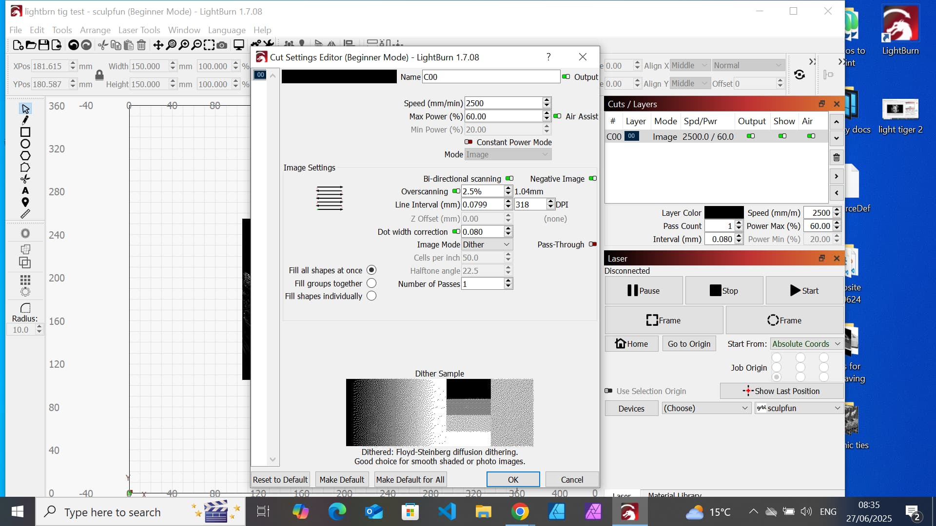

My dot size was set at a default of 0.01. My machine is 0.08 so I changed it to that. That cut my time down to 1:20. I settled for that and did a test at 2500 and 60%.
There were two problems, the image is too dark and there is some banding :grimacing: With regards to the darkness: I will reduce the speed and if that doesn’t work I’ll play arround with the image settings.

I’ve attached a screen print of the new settings. It’s down to 1:45. The result was very dark but I can adjust speed and picture settings to solve this.

I’ve attached a screen print that shows my settings.
With regards to the banding. I’ll try a few things out today. If that doesn’t work I’ll raise it as a new topic.
I’ve just spotted that the line interval setting. I have no idea if that is correct or not. I’ll read up on it. 0.0799 and 314DPI

Go to Lightburn Documents and search image mode.
You can see it in the pic you posted above, You are using/set to ‘dither’ in this case. If you click the down arrow you will see a list of other options for Image quality.
“Image Mode is a special engraving mode for images, which works similarly to Fill Mode, but allows you to select an additional image processing mode that affects the appearance of the engraving.”
Well worth exploring!
Also in LB Doc’s
“5 Steps to Perfect Image Engravings”.
This should really clue you in…look for “Dot correction”. There is also a brilliant video by ‘If I recall correctly’ Russ Saddler, Its posted somewhere here on LB forum but you should find it on YT. He explains it all very well.
