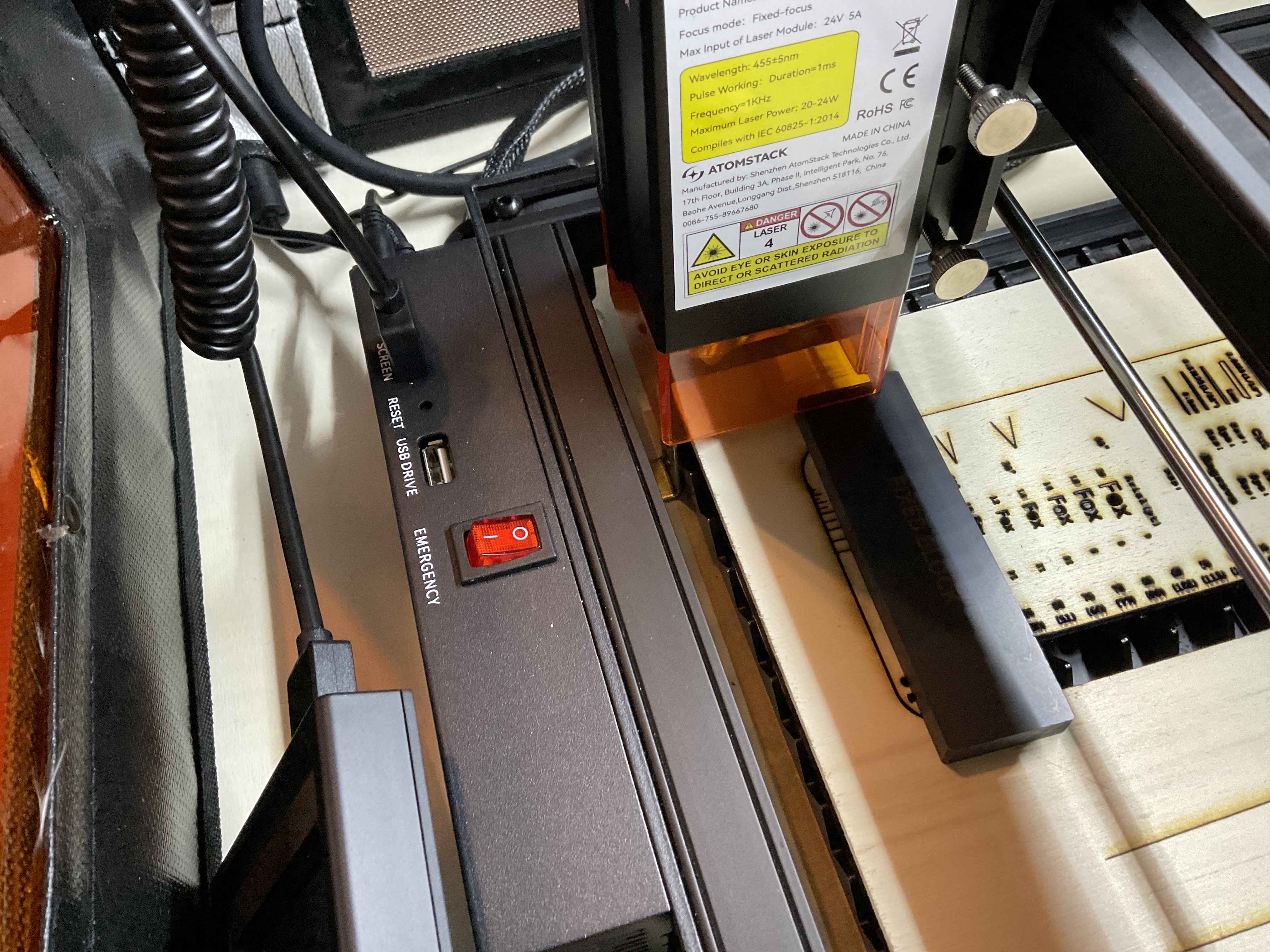

I tweaked a bit with the settings and this is the result on 4mm plywood (pucs show back, front and settings). It seems MikeyH
settings are in fact the best ones (lines 1 and 2) but the first line is still “smokey” on the back, is it normal or do I have to do something else?
PS: i have a matrix panel, not a honeycomb, to support the wood. They said it’s better
PPS: and the machine is atomstack 20w

actually, the cutter came with a thick spacer, about 8mm, and I place it on the wood panel, then lower the laser until the orange plexiglass protection around the laser touches it,
PS BUT I don’t know if it’s a long or short focus. I tried lowering it below the spacer levrl, about 1mm but it’s not that

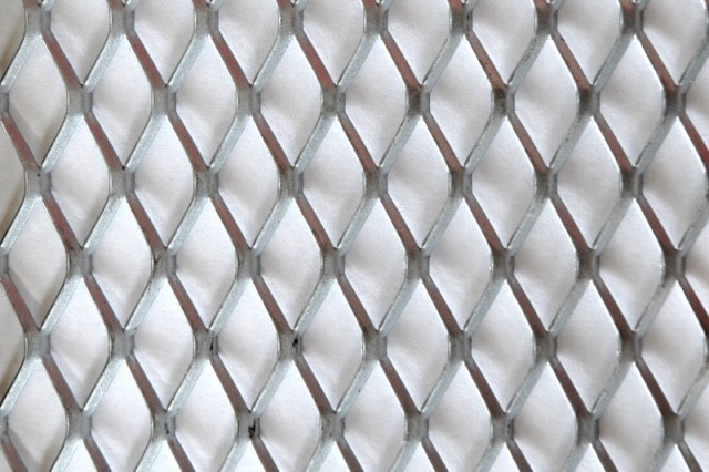

I have similar results and found out the reason is the metal part the product lies on → picture. It had the smoke and dirt from further cuts on it and where it was already used I also got these marks when cutting again.

The wood is touching the matrix support very little because it lies on blades with saw teeth, the contact points are really small. Also I vacuum and clean after every job.
No, I don,t think it’s the contact points, it’s the smoke coming out from below and staining the wood.
