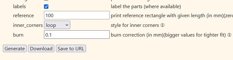

The problem occurs when the wrong setting for corners in boxes.py is selected.
Many of these I’ve gotten from boxes.py are not always closed objects… Sometimes the lines don’t even meet.

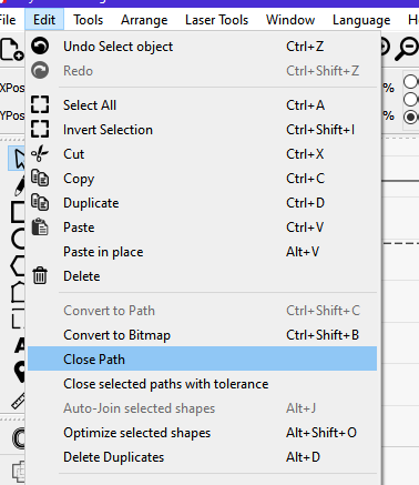

All shapes must be closed for boolean operations. If you Edit → Select open shapes
it will show that all of your shapes except the eclipse are open.
Here you are. I selected the shape that has the ellipse overlapping it, ungrouped it then selected ‘Close Path’. You can then select the ellipse and you’ll see you can perform boolean operations on them.
Hope this solves your issue.

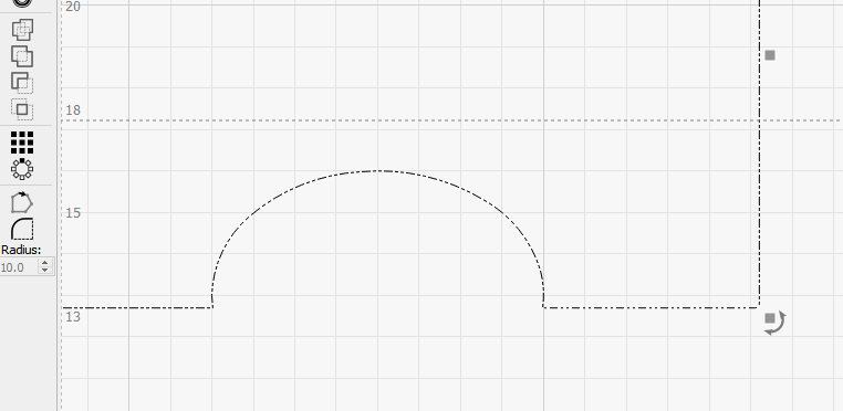

Jack and Marcus, that solves the riddle! It was right in front of me. Now after closing shapes I have a new puzzle but let me try to work it out… see below:
Yes, I noticed those. IIRC it’s to do with your inner corner selection on boxes.py.
Put the cursor on the loop and press the D key to delete that segment.
