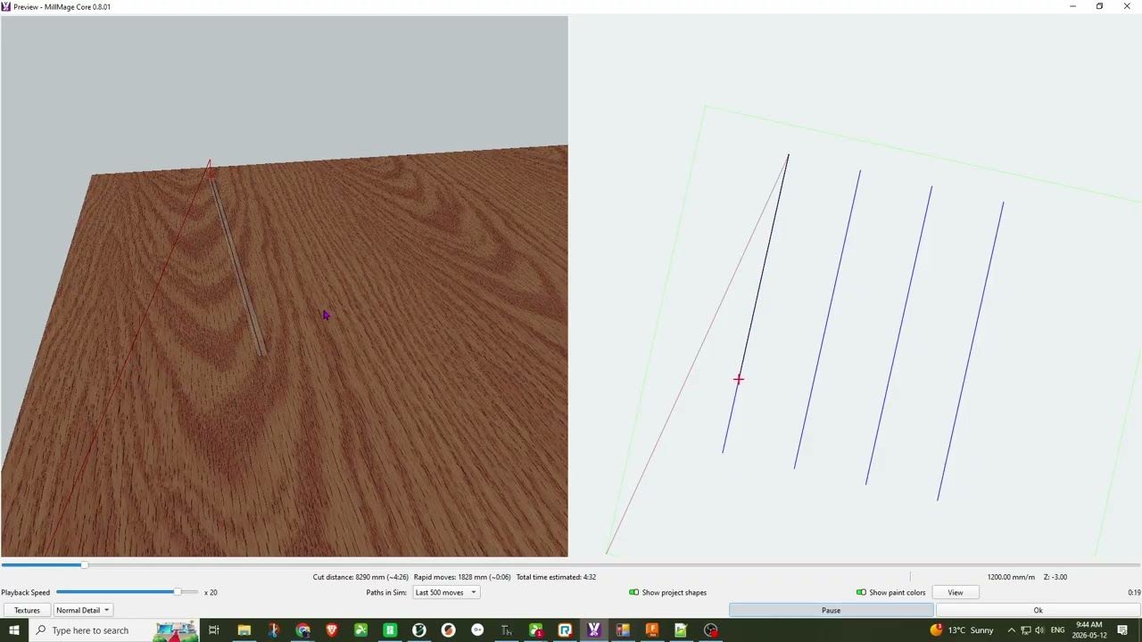

In the my first setup you can see in the video that the toolpath using a stepdown of 2.4mm you can see that its going to lift the bit and come back to the start of the line and then go down 2.4mm and run the line again and then lift the Z come back to the start of the line and go again. This creates alot of extra retraction and travel.
So in the next trial I set the bit depth per pass at 8.5mm and set the ramp angle to be 0.8 and you can see that it goes about 3/4 of the way across the line with a steady ramp and I think it would work well for the bit but it then cuts full depth for the last 1/4.
So I tried to lower the angle further 0.2 and in this example the ramp is just ignored and the bit plunges to full depth and cuts the line.
So my broad question is what is the best way to reduce travel in the instance of this cut?

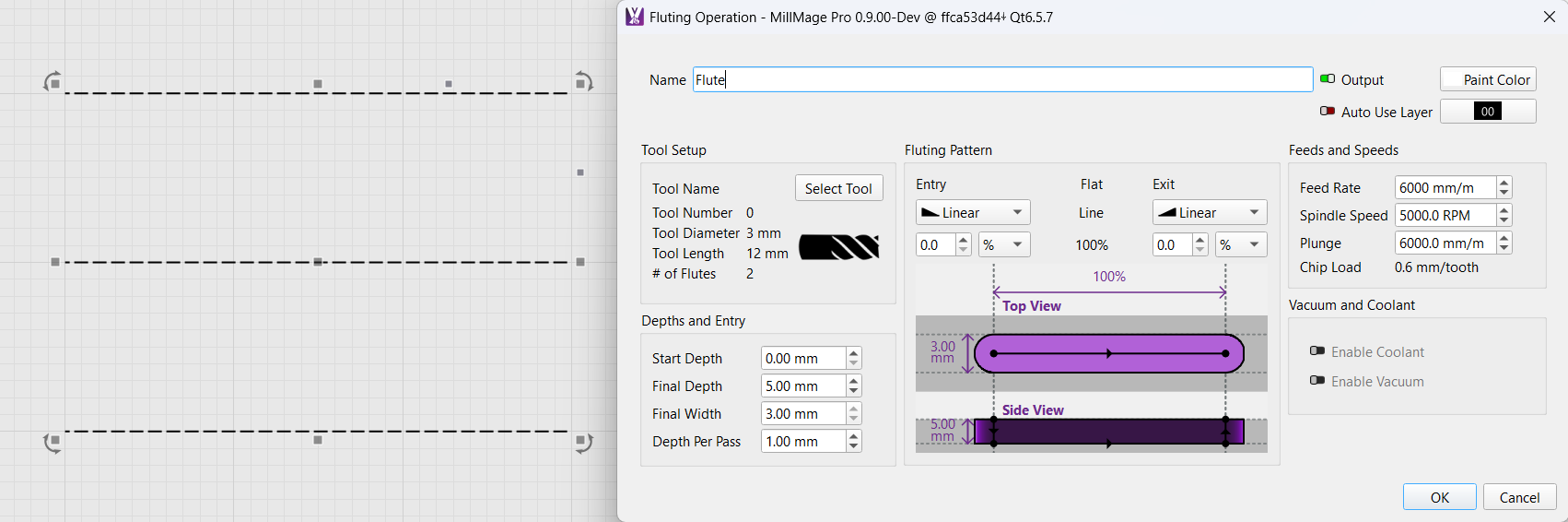

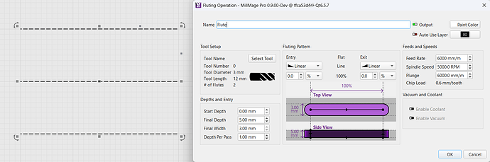

Actually - you could use a Fluting pass, set to plunge at the start and end, instead of using a Profile. Fluting always travels ON the line. Set it up like this, with 0% entry/exit ramps:
It’ll do a straight plunge at the start, move to the opposite end of the line, do another plunge, and so on.
Perfect workaround for now. Thanks!

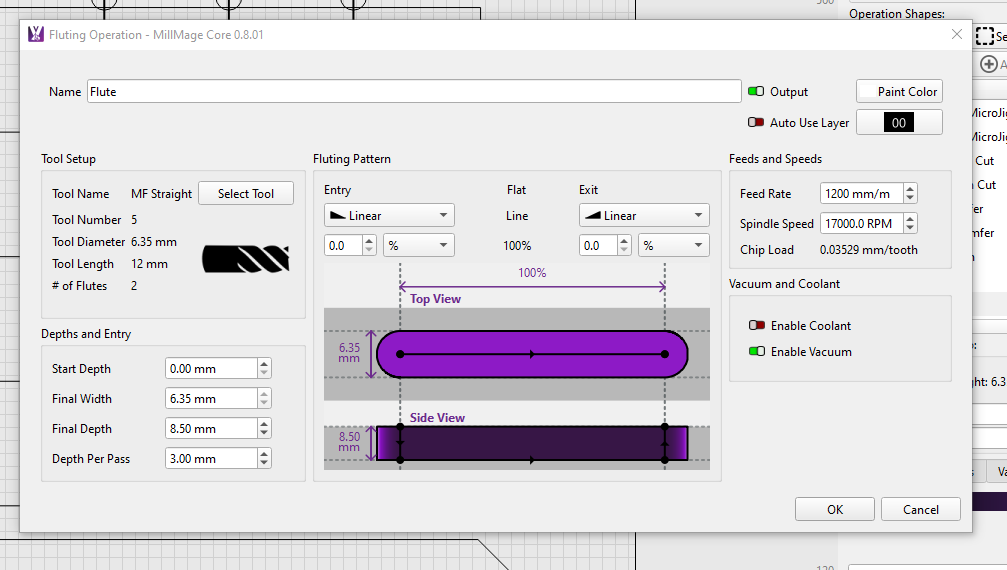

I tried to setup the Fluting operations but it looks to have a similar movement profile when doing several step-downs. Perhaps I missed an option or checkmark.
At Posting #2, @LightBurn explains how to use Fluting to get what you want. Is what he described not working for you?
Your settings in the video are too blurry for comparison.

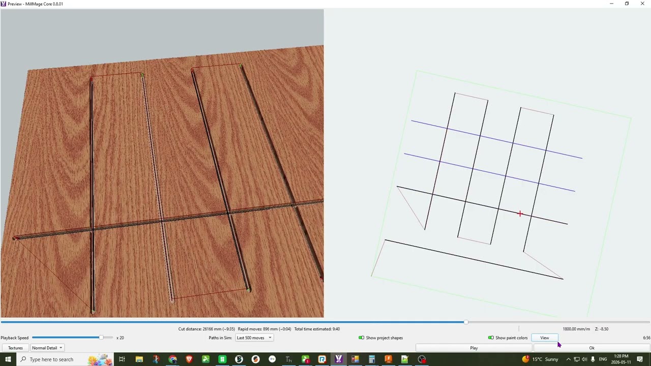

Strange not sure what YouTube did there but here is the screenshot:
Correct, when I setup the Fluting Operation it looks to be doing it the same as a profile. The bit lifts at the end of the cut line and goes back to the start of the line moves the Z down to the next stepdown level and starts the cut at the new depth and repeats.
Vs starting with in my example, a 3mm deep cut going from one end to the other, then down to 6mm and come back the other way and then 8.5mm and back once again.
Other than basically tool differences, it looks the same. My guess is that @LightBurn is using a later version than you have. Please remember what he said is a work in progress.
