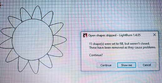

Dose it crash all of the time or was I just unlucky?? I don’t use a computer of any kind much I’m usually on the tools I do a lot of woodwork and got a laser to engrave some of the wooden items that i make. I’m trying to engrave this sun but it will only engrave the circle only
what dose it mean when it said they weren’t closed?? all the lines are touching each other I have zoomed as far as ican zoom in and they are all touching the centre circle I have tried to weld them all together but nothing happens

A closed shape must not have any breaks and joined to form a loop. A single line or segment does not constitute a closed shape.
