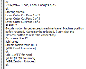

THE PROBLEM. This just started out of the blue. Was using LR v1.1.0 when problem started. Updated to v1.2.00. No changes. Using a small rectangle for the project, no matter where the laser and rectangle are, START causes the “out of bounds” error message shown below. Laser is shut off. Fire doesn’t work.

Error message after START:

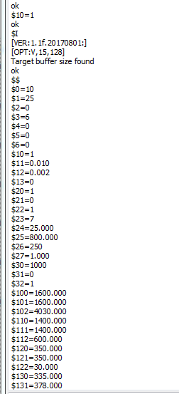

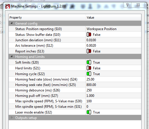

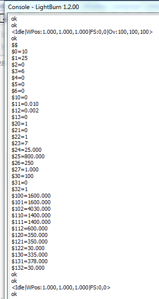

GRBL settings:
GRBL settings

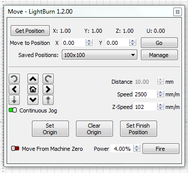

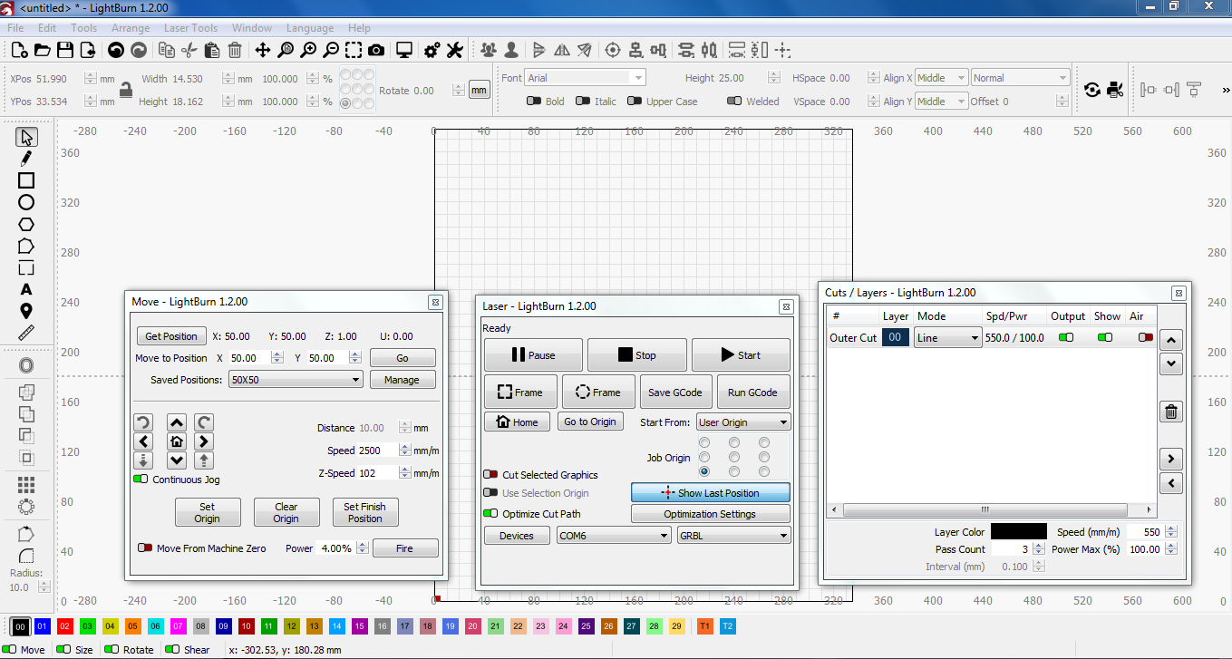

Move window after homing:

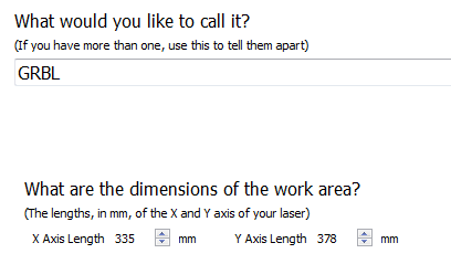

Machine settings:
Machine settings
Laser window:
Laser window

  3. Your $30=100 value is unusually low. Is this deliberate?

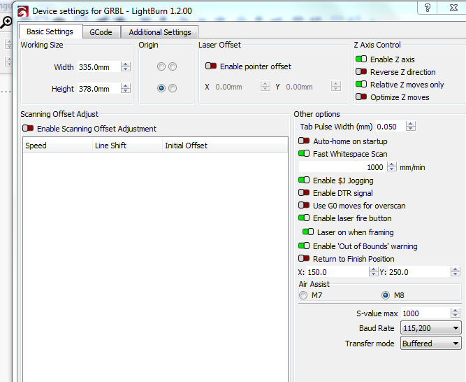

Can you provide the following:

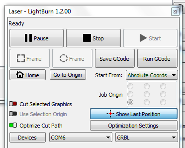

  1. Screenshot of Edit->Device Settings
  2. Full screenshot of LightBurn

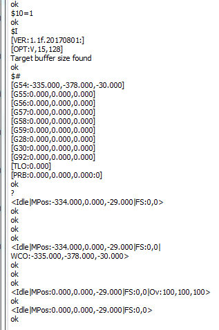

  3. Complete a homing cycle and then run the following. Return the text back please:
$10=1
$I

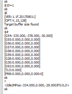

  1. Jog laser head to top-left and run ? in Console
  2. Repeat for top-right
  3. Repeat for bottom-right

    3 $30 = 100 is my mistake. May have thought it was 100%.

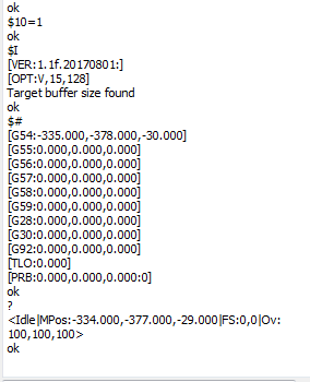

    1.2. See screen shots.
  6. Hope I ran the tests as requested. Before each corner test, ran the setups.
    Each test is just numbered “#n”. I didn’t repeat the $$ each time. Couldn’t get it all on the screen at once.
    Really appreciate your time and effort looking at this. It must not be a simple problem. Just hope it has a solution. Phil

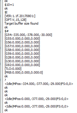

Test 1
#3 part b
#4
#5
#6
Okay. Based on what I’m seeing most of your setup should be correct. I’m not following that your machine is working in Quadrant 3 but let’s make a few changes and run some tests.
Let’s fix this. Run in Console:
$30=1000
I’m going to guess you don’t need to do apply this each time. Af for $32, do you use this machine also for CNC operation? If so, you may need to toggle back and forth between laser and CNC operation.
Let’s tweak your offset by 1 mm. Please run in Console:
G10 L2 P1 X-334 Y-377 Z-29
$10=0
Then home the machine and then run in Console:
This should be 0,0.
Then move machine to top-right and then rerun ? command and return results.

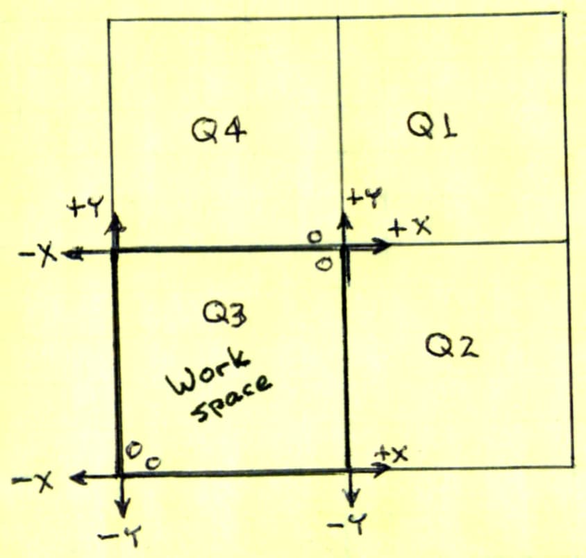

I’ll start by explaining how I came up with Quadrant 3.
My first laser engraver was an Ortur belt driven gantry. Changed to my laser and a WoodPecker controller board. When I tried to run a project, the laser went up to the right/back corner and jammed. That implied to me that +X,+Y must be beyond that corner (Q1 - more to the back/right). Then I found an article from the Lightroom people that said that in that case I would have to set up a macro with G10 … X-x Y-y. That shifts the positive numbers from LightRoom down into the work space. You know that.
See drawing: The x,y are from LR if negative numbers could be sent. Q1 without G10. Q2 to the right of work space. Q4 back of workspace. And Q3 works with G10 shifted x,y.
Changed $30=1000 Now matches the S-value max in Devices Settings.

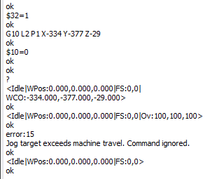

Ran G10 L2 P1 X-334 Y-377 Z-29
$10=0
Home then ? Ran twice to make sure I didn’t make a mistake.
Move 1
Test 1
Error when JOG
Tried to use JOG to move to corners. The 1st JOG caused the error 15. No more moves.
$10=0 What does that set the Status Report to? 1 would be Machine Position and 2 is Work Position. Could that make a difference in what numbers are being used somewhere?
One more question. $3 sets the motor directions. And $23 sets the Homing Cycle Direction. Seems like that should be the same. Same motors - wired the same. I spent a lot of time coming up with $3=6 and $23=7.
I hope you are not spending too much time on this. But I do appreciate what you have done. Maybe something will pop up that is not right. Phil
Ah… I’m following you and agree. I was just thinking that with the offset you’re no longer working in a Quadrant 3 manner. With the offset you’re effectively working in Q1. I don’t know if there’s a convention that determines the true quadrant.

$10=0 actually sets status to report working position. 2 actually enables buffer data.
The intent of Work Postion in this is case is so that it’s reporting coordinates with the work offset (WCO) accounted for.
So value after homing is good (0,0).
I think the issue may be with Z axis. Can you disable Z axis in Edit->Device Settings and see if it works? If so, you may need to remove the Z portion of the offset:
G10 L2 P1 X-334 Y-377 Z0
I don’t think these necessarily have to be the same. GRBL by default I believe homes toward the positive value direction for each axis. I think this is a legacy from CNC where you’re typically working in negative coords. As long as your jogging controls work in the correct direction and homing works in the correct direction you should okay.
