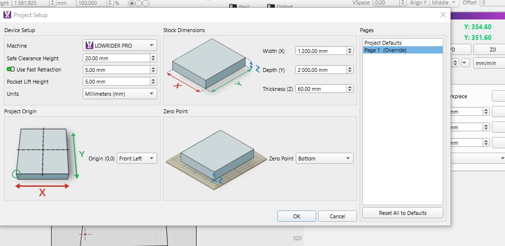

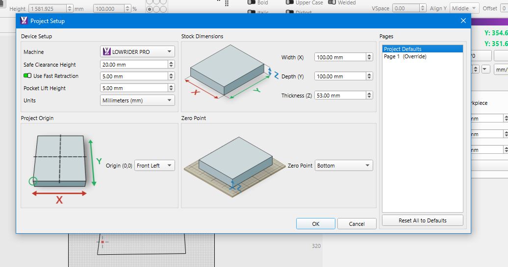

with the new page set up if i click on icon and alter setting
is it meant to update main seetings from file >project setup edit , it dosent on mine
im probing from bottom. with them different heights when starting job z goes to table to start job , if i make them the same it starts above material like it should
slab 1.mage (11.5 KB)

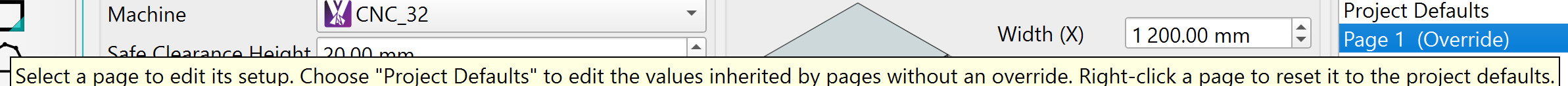

Maybe this helps:
If you hover over the Pages description you get a ToolTip
as there is no docs yet on multi page I’m interpreting how i would assume it should /could work
you can change page set up which includes material thickness,
as shown below , previews show correct material thickness and cut from top
even playing preview it looks right showing dif material thicknesses

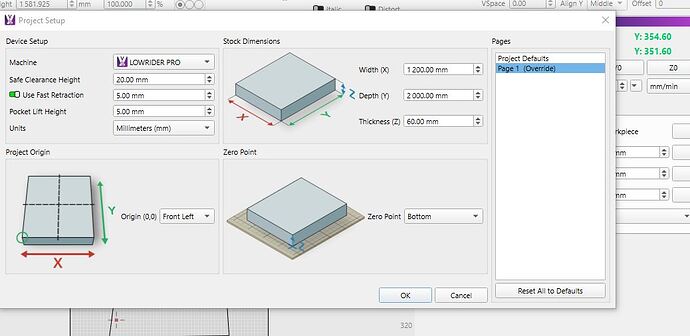

but when actually running project it takes probe as top of material not bottom as in setting
if having to change / correct default setting for ever new page you want to cut what is the point of being able to alter settings for each page
so is it a bug , something that was over looked , or am i looking at it wrong ?

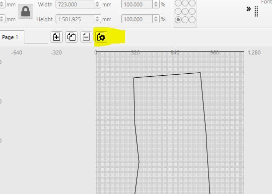

From what I understand after watching the video, multipages will be used to create double-sided projects, left and right sides, perhaps tiles…
It´s a “baby” option that needs some refinement for special use case like yours.
Regarding the random slabs and to better understand, let`s say the stock is Z=10mm and probing on bottom, if you set a 3mm Pocket Op are you expecting a 10-3=7mm pocket?
hmmmm didnt think of it in that way , i was looking at it from the point ,say you design a kitchen , backs can be 4,9 or 16 mm, carcass’s generally 16mm ,fronts 18mm , in freecad once ive designed kitchen i move all parts into tech draw different pages for different thicknesses. than import them into MM as dxf, so i went ok its like excel you have 1 main file with various tabs and each tab holds its own information
no still only expecting a 3mm pocket, as far as the operations are concerned they all cut to correct depths etc as long as default is manually changed to match override ,to me the word override means it will be the page dictating what the default does

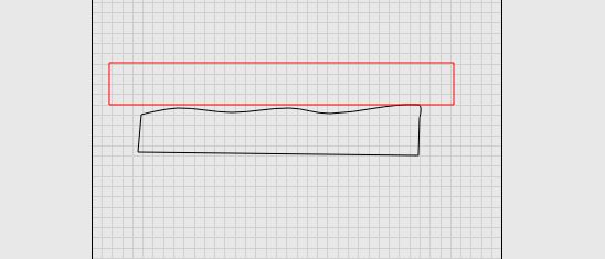

every slab gets surfaced prior to final operations on, the way i do it is say black is slab red is straight edge finding highest point of slab measure to table that is stock thickness, as some stock is that hard can only do a .5mm pass
for final operations i put start depth as final surface height, i know can be done other ways,
i really create new operations i use pre-sets from operation library, all i have to do is change start height . I find this is quickest and less chance of error, 1 box 1 change , done
