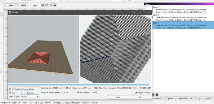

as there is no docs yet on multi page I’m interpreting how i would assume it should /could work

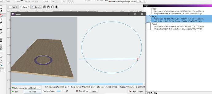

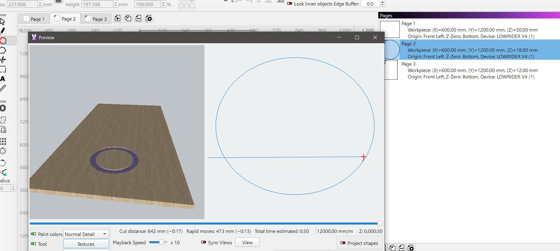

you can change page set up which includes material thickness,

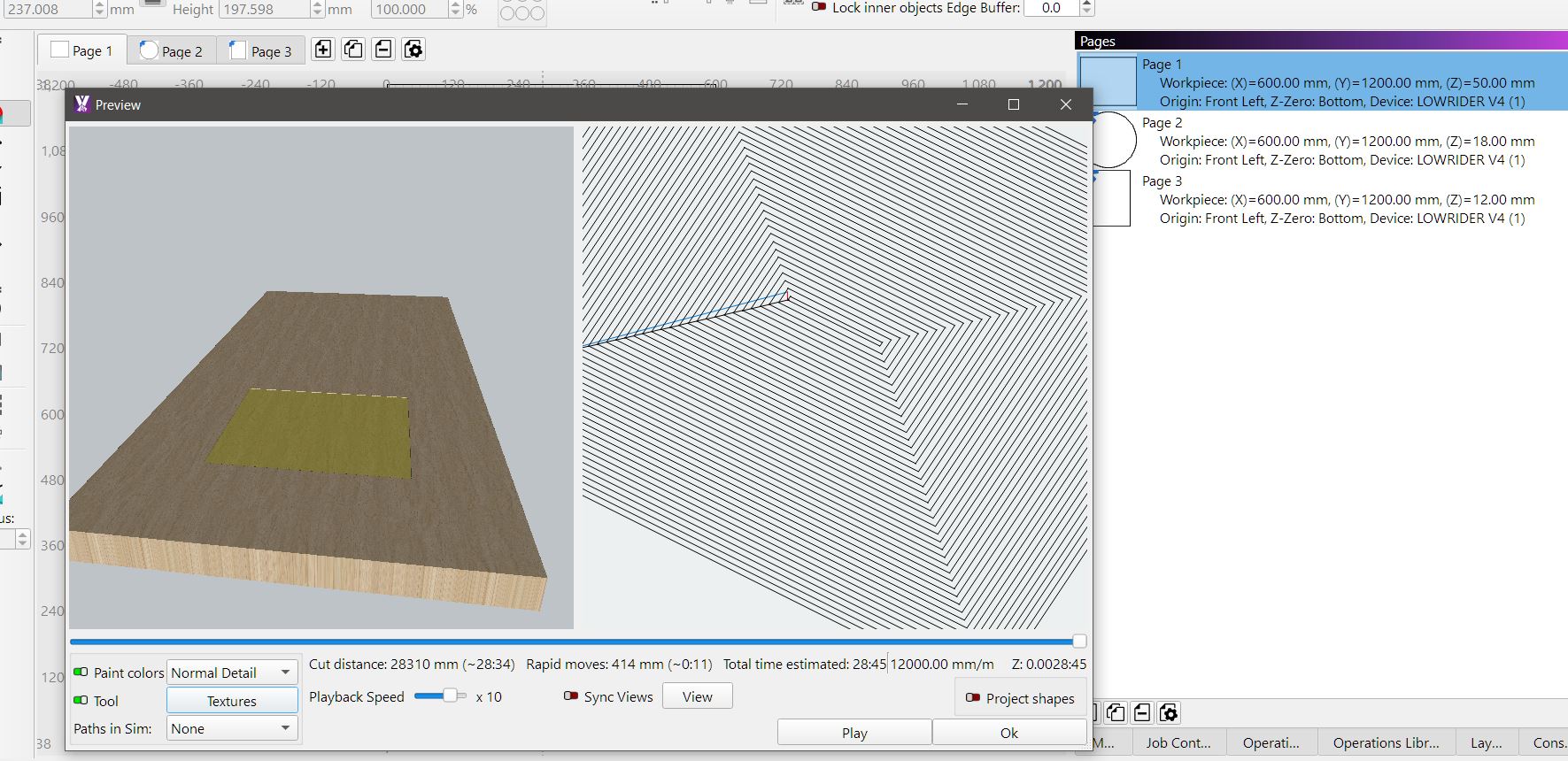

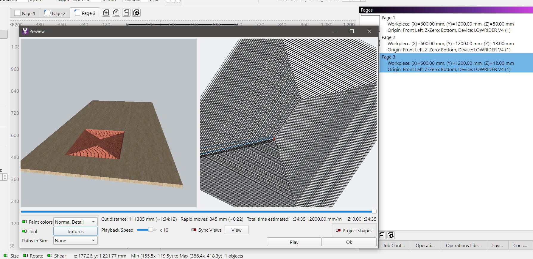

as shown below , previews show correct material thickness and cut from top
even playing preview it looks right showing dif material thicknesses
but when actually running project it takes probe as top of material not bottom as in setting
if having to change / correct default setting for ever new page you want to cut what is the point of being able to alter settings for each page
so is it a bug , something that was over looked , or am i looking at it wrong ?
the reason i have change to bottom probe is working with lot of random slabs at present,
so its just not practical or impossible to control MM to probe when say im at opposite end of table if that is where i want my probe height if going from top
some will say move xy set new zero probe from top etc , that’s still lot hassle , easier to throw slab on table trace it set op and run some slabs i have less than 5mm between tool and top,
