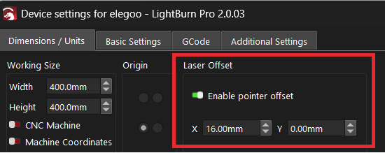

when i frame my project the frame looks fine on my project board, but when i start the head moves to a different location to start. If I zero work space after framing at the “framing stop position” then it will start at relative correct starting position. i have the “positon” “workpiece” tab unselected
do you have a pointer offset enabled?
that tab is not available in my ver of MillMage
