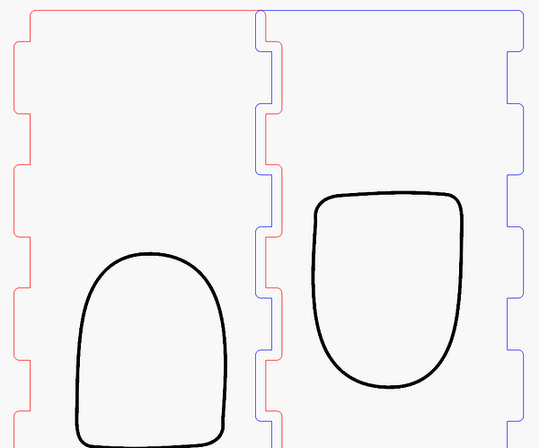

So I have a file that I spent several days aligning the lines of the objects to overlap each other so one single cut would make finger joints for both parts and in the lightburn software i went into optimization settings and selected to remove overlapping lines and the distance is set for .025mm.
When the laser is cutting it is going over the cut lines twice instead of once like i wanted.
What did I do wrong? i am new to lightburn and not experienced with it.

What’s happening is that because you have a kerf value applied, the 0.025 mm value for removing overlapping lines isn’t sufficient to detect the overlap.
Realistically, you wouldn’t be able to nest these pieces if you were trying to apply an overlap in any case.
If you still want to remove the overlap then either remove the kerf or increase the overlap tolerance. Doing the latter may get you slightly wonky pieces.
If you want kerf to work properly you won’t be able to nest the pieces like you’re trying to do as kerf necessarily will cut larger than the original shape.

I don’t think I was sufficiently clear. There’s physically no way to simultaneously nest the parts, and yet cut each shape larger (which is what a kerf adjustment would do) than its current size. If kerf is applied, each part would intrude into the space of the other. If kerf is not applied, then both parts can share a single cut but as you say, each part will be too loose to hold together with a friction fit.
I’ve exaggerated the effect of the kerf here for a visual. You can see how the kerf would result in each shape intruding into the other.
By not nesting but with a kerf. So each piece is cut separately. This will necessarily result in some waste between pieces. You could try to redesign your sheet layout such that non-joining parts are directly next to each other but that mating sides have nothing next to it.
If you want to be very fussy with layout I’d suggest not using the kerf adjustment and directly offsetting each shape. This will allow you layout flexibility but at the cost of “hard-coded” kerf adjustment. I’d suggest taking a backup of your design at nominal sizes before modifying to apply the manual adjustment.
