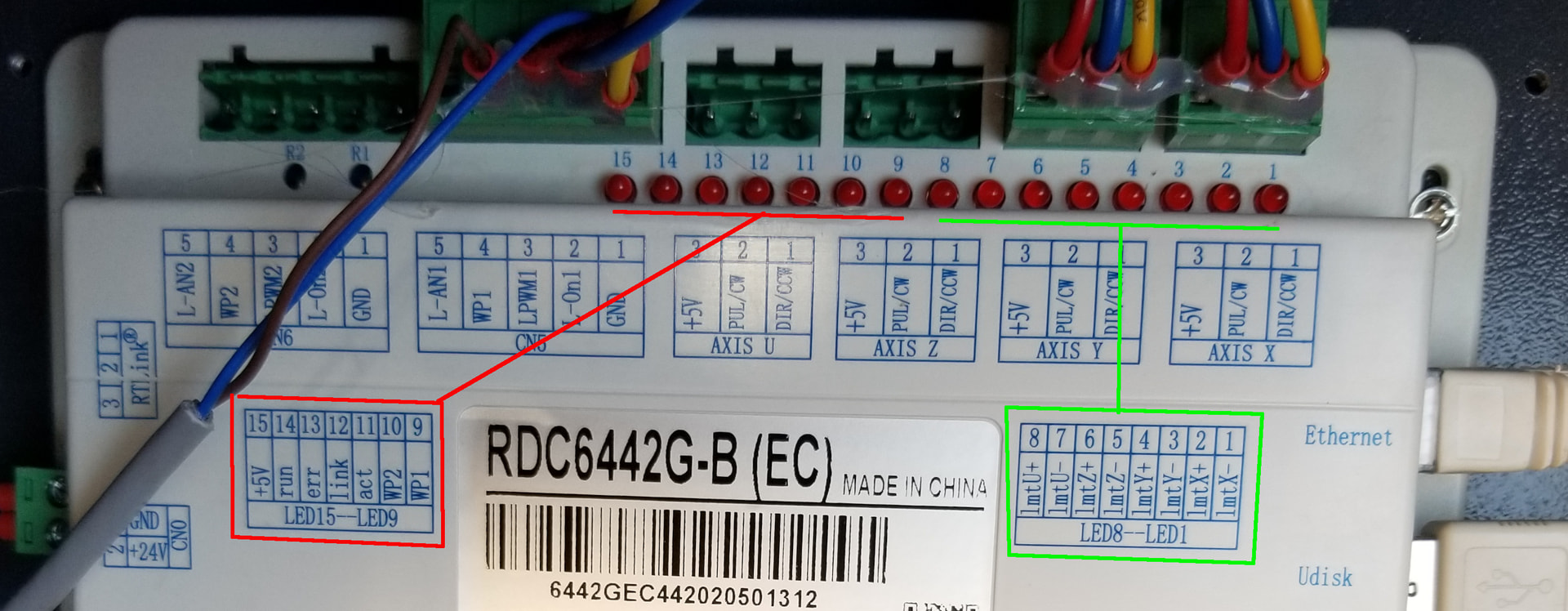

One day I turned the laser and it started doing homing procedure as usually. It came to the top of the working bed and then it started grinding against the right end of the working bed. I stopped it, turned it off and then on, I stopped the homing and put piece of metal to the both sensors to see if the red light would appear, and it seemed they were working. I tried again to do homing, but again the same thing.

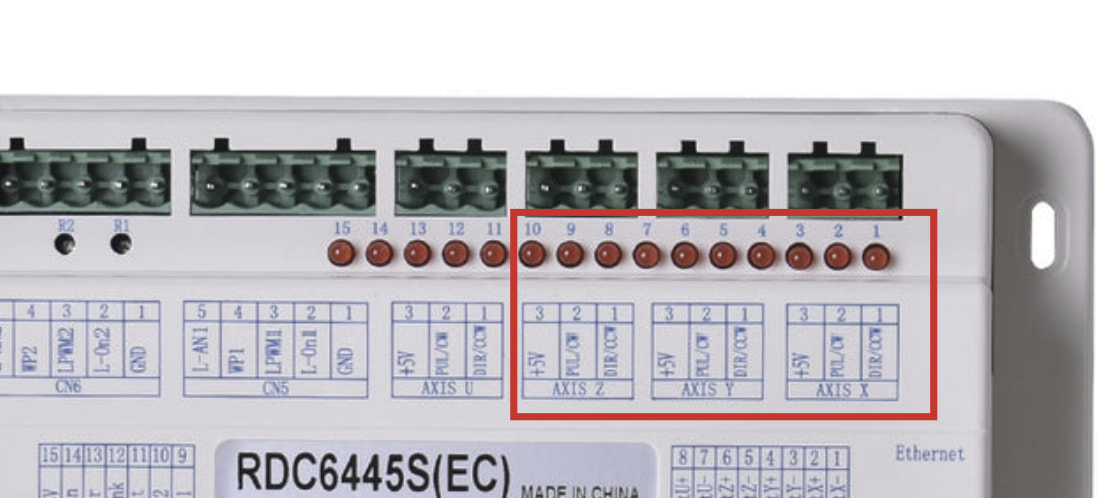

Did you check the limit switch status lights on the controller?
On a RuiDa, that would be here:
Maybe he can better determine what he wants from this photo. Red box and lines, along with green box and line, shows the represented leds.
Once you <esc> out of it. it doesn’t look at the home inputs any more, so you can lay a piece of metal on it without worry.
Make sense?

Yesterday everything was working perfectly fine, today same story as at the beginning. I checked the main board, I stopped the homing process and then put a piece of metal on the sensor. The sensor is glowing, and on the main board the first LED in the red line (the red line you had underlined), the second LED is flashing at the red underline part, and the last one in the green line is glowing while metal part is on the sensor.

First led doesn’t tell us much.. since you may normally read right to left…?
Give us the number of the led or it’s mnemonic, that’s much more helpful.
All of these also have a name (mnemonic) on the id label of what they led represents.
They also have a mnemonic, such as 5V, run, err, link, act wp2 and wp1. Both of the wp (water protection) inputs are for coolant flow. 5V indicates it’s producing 5+ internally, run flashes all the time if the controller is away, and link indicates if the Ethernet hard is connected, not if it’s talking. Usually I notice mine flashing as it’s dumping data to the laser.
What you most likely need to look at is your LmtX- and LmtY- inputs to see if the machine is getting the correct signal. Putting metal on the X axes sensor should light up the LmtX- (led 1) input of the controller.
