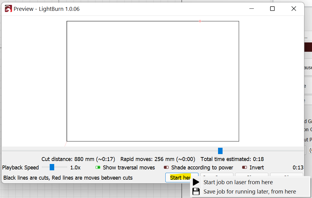

LightBurn doesn’t have a method of starting on a particular line of Gcode but it does have the ability to start in the middle of a job.
There’s a button called “Start here” in the Preview tool window that allows you to start the job from the point in the simulation. It’s visual rather than code line based.
If you need line based start from I know that laserGRBL offers this capability.

You can issue commands into Console one at a time but the gcode for the job is not in memory for you to execute from the Console. So there’s no option to start from a line of the gcode.

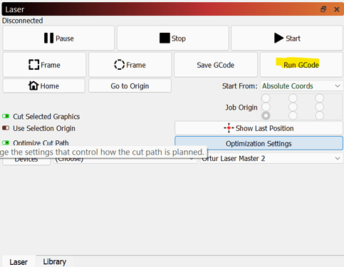

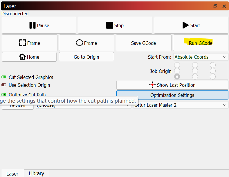

Sí guardo en formato GCODE un trabajo, lo edito con un editor de gcode y elimino las líneas de código, que no me interesante hasta que empieze dónde quiero, ¿Puede funcionar? ¿Que opinas?
If you’ve edited it outside you can run it in LightBurn using “Run GCode” in Laser Window.
