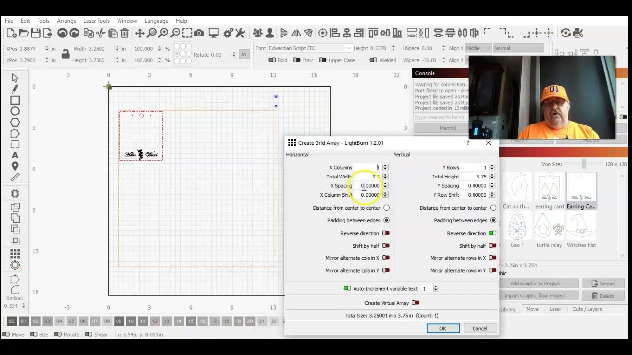

Hereā€™s a customer video about Removing Overlapping Lines.
This is faster.
