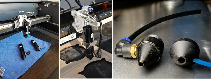

I wouldn’t have a use for a lens under 50 because it wouldn’t pass thru the nozzle. I like the nozzle because it protects the lens and is I great way to direct compressed air. Beyond the nozzle restrictions I can’t think of a reason why a 25mm lens would work better.

The actual tubes allow for different placement of the lenses by flipping it over.
Jack, thanks for pointing out various ways to mount various length lens while still being able to use a nozzle. The original question was why would you use a lens that has a focal length of 25mm?
