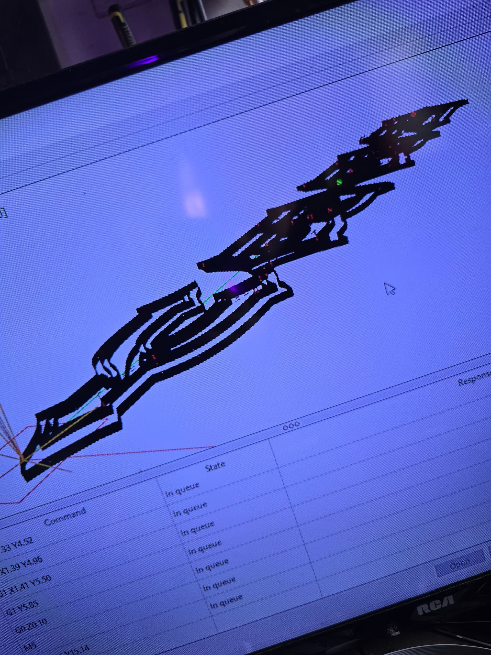

The issue is the software states it supports cnc machines which is false as we need to clear the height of the material during travel moves , we need a new feature just 1 , go to start height before travel as a button option , this would literally make cnc routers work as intended because at the moment im just breaking my machine hitting into parts during offset fills and certain lines
What we need: * Add a “Z-Safe Travel Height” Option
  • Before any non-cutting move (G0), lift Z to a safe height, then move, then lower Z back down.
  • Auto-Raise Z After Each Cut Pass
  • After completing a cut, LightBurn should have an option to return to the set Z height before moving.
  • Fix “Offset Fill” Behavior in CNC Mode
  • Offset Fill should recognize that travel moves shouldn’t be at cutting depth in CNC mode.
