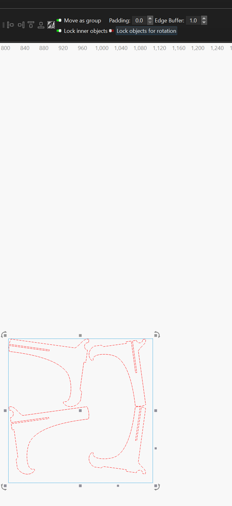

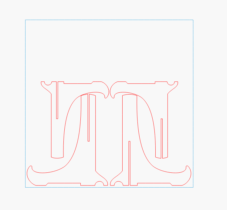

When I use the quick Nest tool I get this:

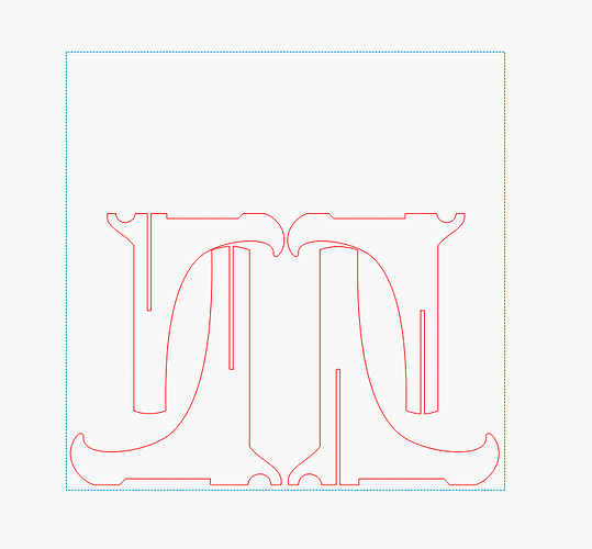

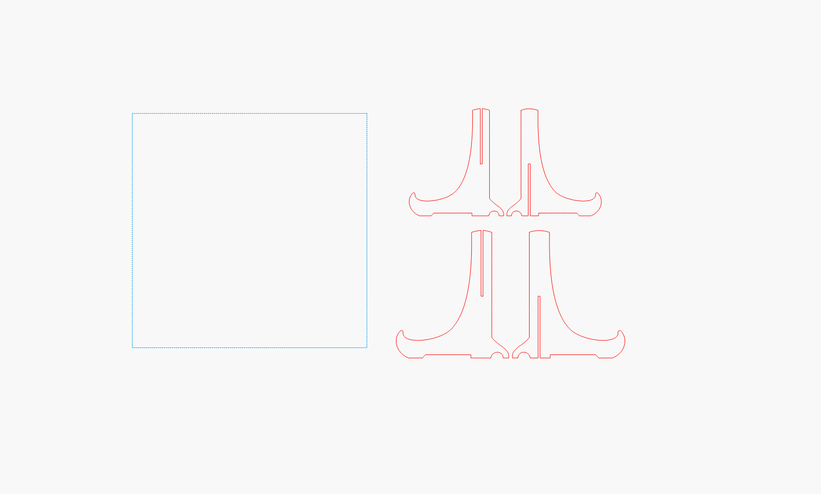

Now I will admit I think it was nice that the tool saw my easels were too big for my project size and so it created a new piece. This was a handy feature I did not know was baked into the tool. So I resized my easels to fit and used the tool again with this result:

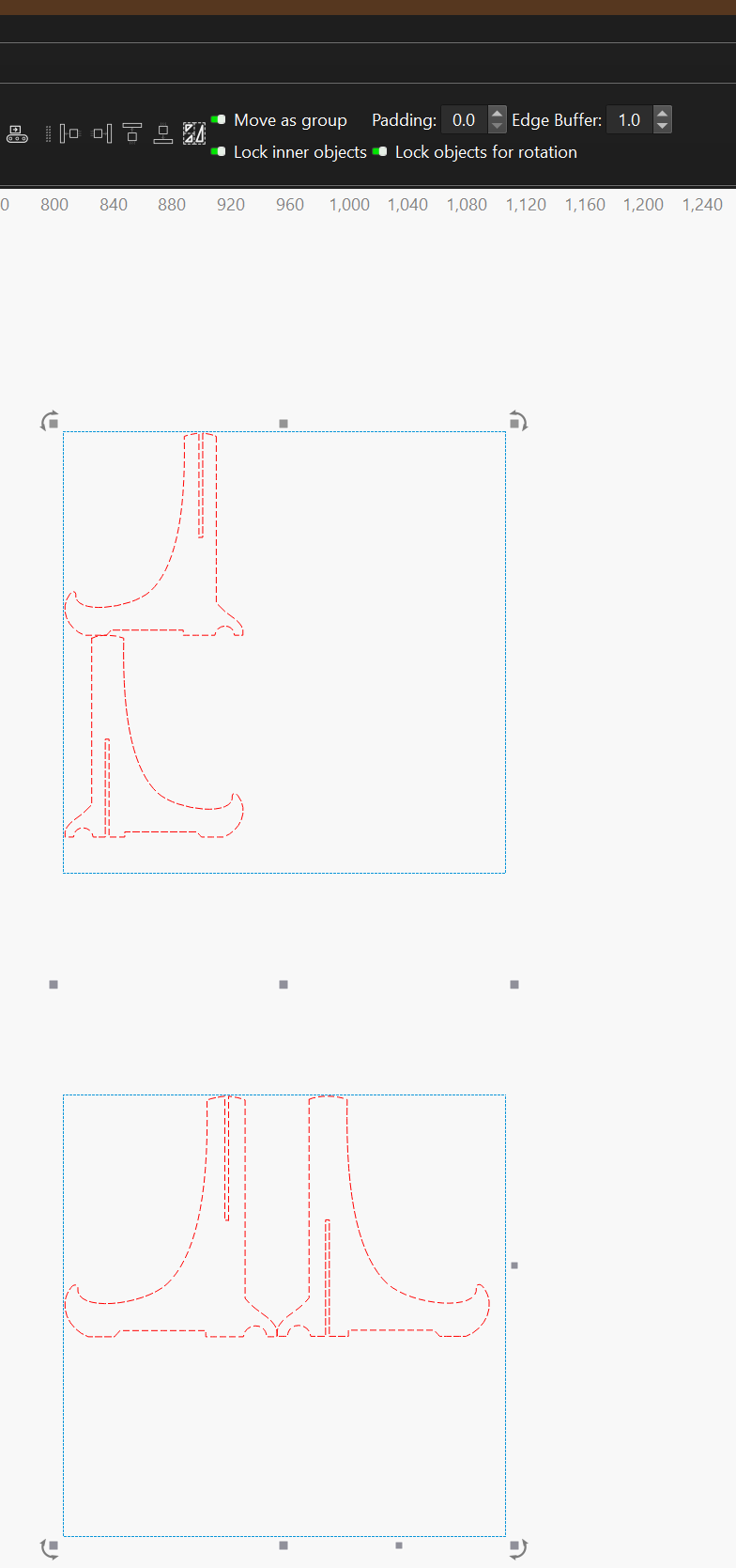

Problem with this option is I am not maximizing my space. What I wanted was something more like this:
This is achieved by simply rotating Items. I do this often and was hoping that this tool would have either done it for me OR I use the tool again to get a different layout (which did not work) to use the layout I found I wanted.

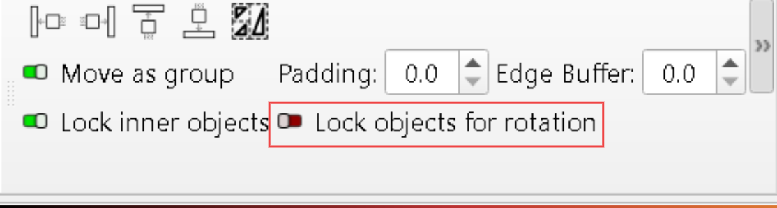

You can toggle Lock Objects for Rotation
I thought in one of the pictures I uploaded I did have that toggle on and another one where it is off. However, I did attempt to toggle each of the 3 settings on and off with different combinations and would not get the expected result. I would only get the result where Lightburn did fit things into the square but it generated a lot of wasted space and the result I wanted was different. I hope that makes sense.
Quick Nest uses the bounding boxes of the shapes to nest parts - True Nesting is likely coming in 2.2.
