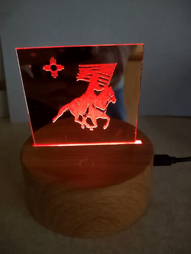

Got a few gifts to make this year, and I happen to know a guy with a laser :wink:.
Prototypes success. Have some round mirrors arriving Monday.
3” mirror from amZon
Lighted base from jp plus supply.
Finger prints are all mine :stuck_out_tongue:
3000 mm/m
90 & 100% power 10w Ortur
.12 interval, .1 spot size

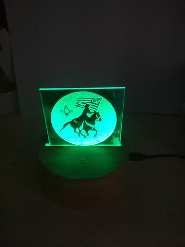

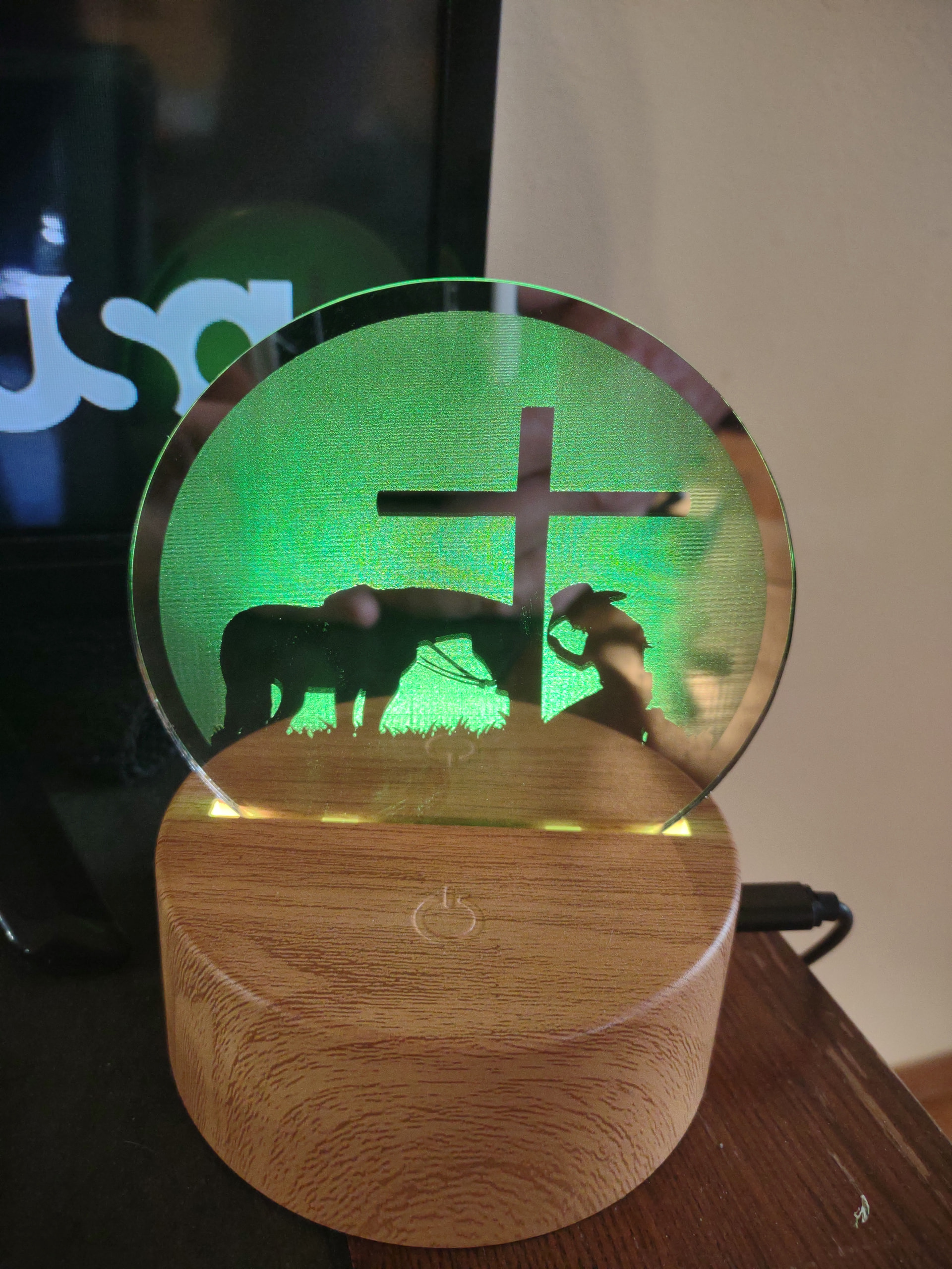

Got the round glass in. MUCH happier with these.

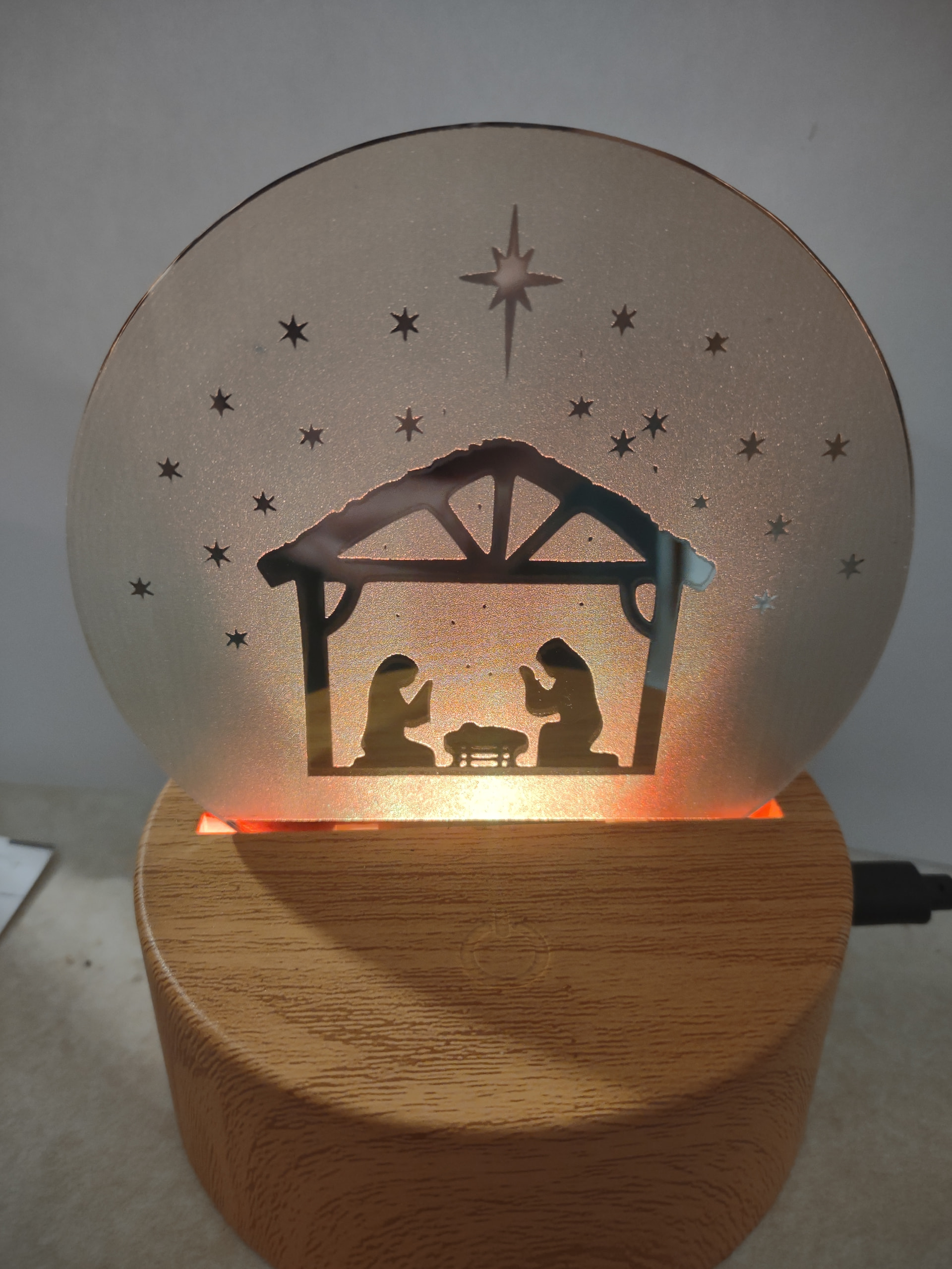

Another round of night lights this one is Daughter-in-law gift.
