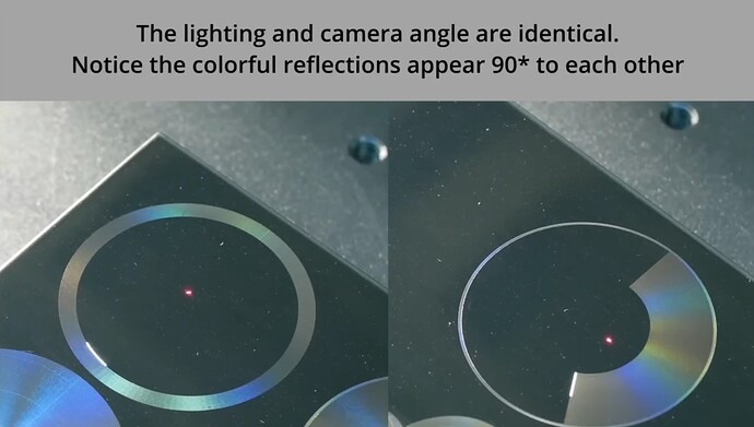

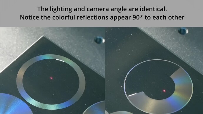

I saw thid video in YT :
At 15:41min of the video, you can see that on the left side the circle is filled with concentric toolpaths created by offset fill (as far as i learned already).
How can i create the ā€œradial fillā€ of the circle(s) shown on the right side? Its not ā€œoffset-fillā€ and not ā€œfillā€ right?
How can i create this radial fill please?

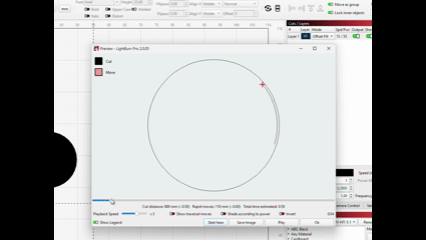

That does look like Offset Fill to me.
Using the Preview (Alt + P):
Untitled video - Made with Clipchamp (16)
Hey Aaron, as described i am asking for the radial version, not the concentric/offset-fill way.

Oh, the one on the right side. I missed that part.
I’m not sure, if that was done in LightBurn. I’ll ask the team!

My bad, didn’t see you were working with a fiber. TLDR: I gave an answer for a diode gantry laser. Sorry bud.
Off the top of my head, there is no direct way to make a circle from the center to the edge…aka radial fill. You laser spot is a known size, say .1mmx.8mm (common diode size).
You will have different overlap as you move outward from the center as the endpoints diverge on the circumference.

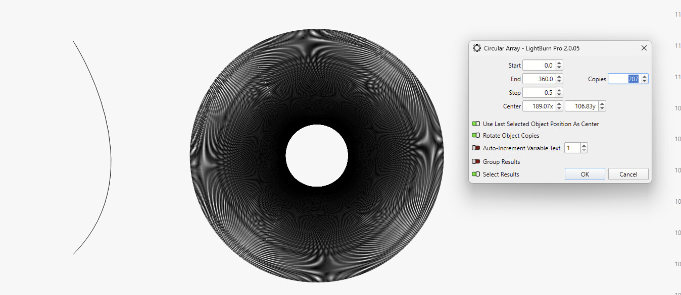

One inexact work around would be to make a line the diameter of your item, then use the circular array tool centered on the middle of that line to duplicate that line on a small offset, many, many times until the array makes a 180 degree turn.
Leave that layer on LINE setting. This is a very very time and machine intensive method. I predict the results will not satisfy you on a large circle, but the effect will be as you described.

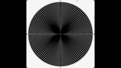

@FreyRS While there is no direct ā€œConcentric Fillā€ option, there are a couple of ways that will work using Line mode!
I wonder, how Ben created the designs shown in the video, but here are some things worth a try in LightBurn:
It also works with curves and weird shapes.
The star-shaped MoirĆ© patterns are a result of the sampling and won’t be in the actual engraving, but a similar effect could show in the diffraction patterns you are aiming for.
Copy Along Path also works!

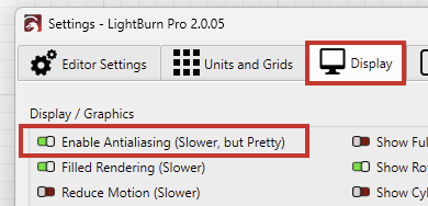

You will want to enable Antialiasing in the Settings:
Fun! Here’s what the marching ants on 2000 lines look like:
circular array

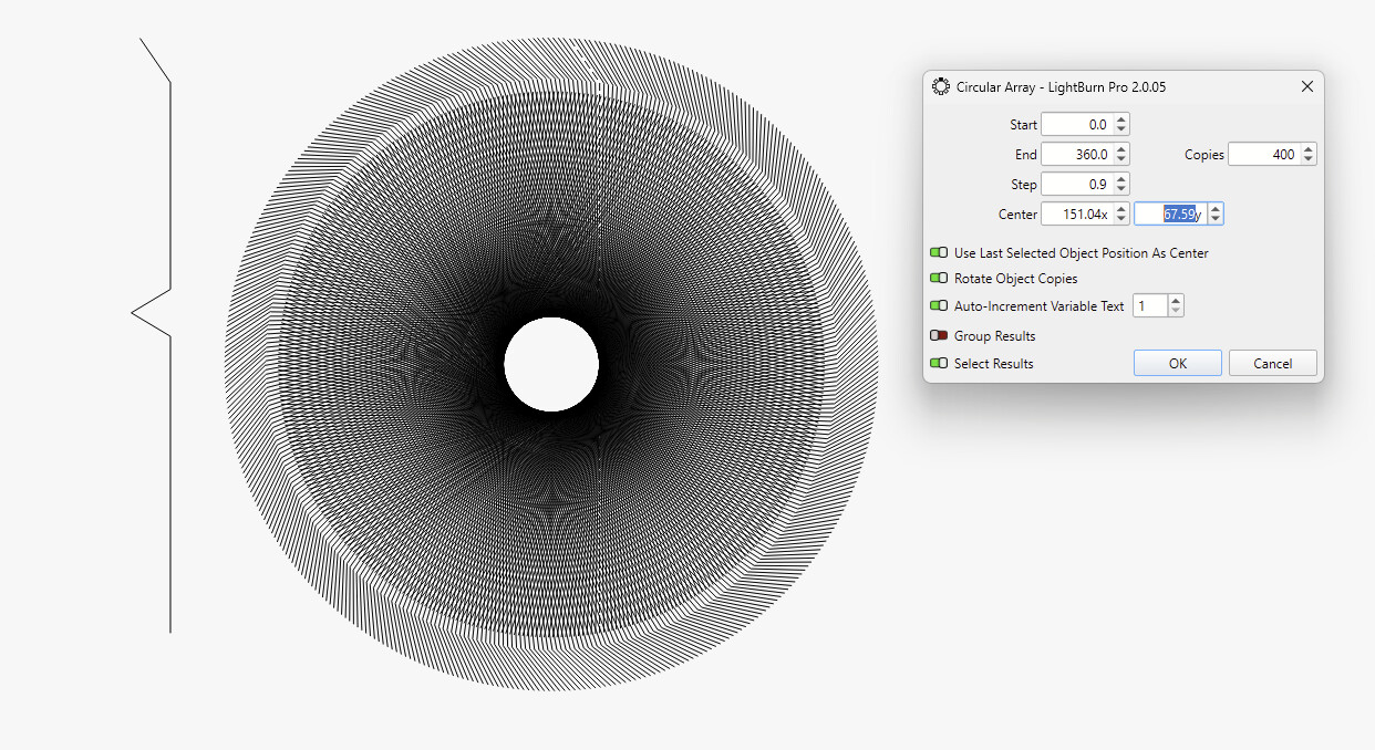

This one looks promising! :smiley:
radial "fill"
Here’s my project file. (Rename to .zip and unpack the .LBRN2 file):
Galvo-Diffraction-CD-Tests-2.txt (828.2 KB)

Thanks a lot! Thats what i already had in mind too to do it manually, i just did not know if it would work since i wondered if it would work with ā€œlineā€ mode path engraving.
I will test! Thanks a lot mate for your fast help and ideas and even file shared :head_shaking_vertically::raising_hands:t2:
