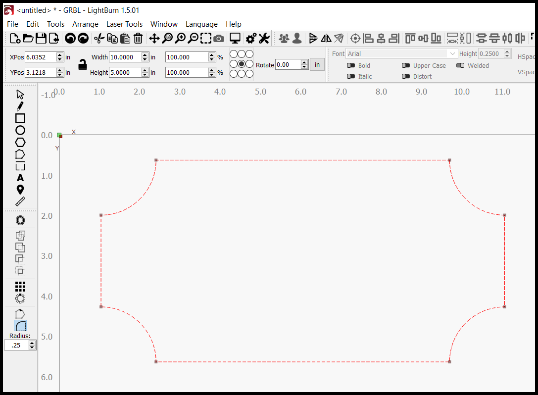

Found some weird behavior with the radius tool. I created a rectangle, and used the blue dot to create negative corner rads. Then I converted to path.
When I select the radius tool, I get mixed results. It appears if I click closer to the radius where it meets the square corner, it sometimes removes the radius and extends the corner. I couldn’t find a pattern to it.
