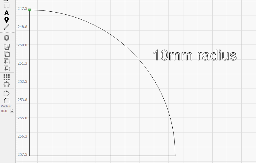

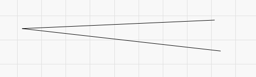

The radiused corner tool will not work on curves, only straight lines, and the lines have to be connected, and long enough to create a corner at the chosen radius. For example, I can’t create a 10mm radius corner here, because these lines are less than 20mm apart (radius 10 = diameter 20):

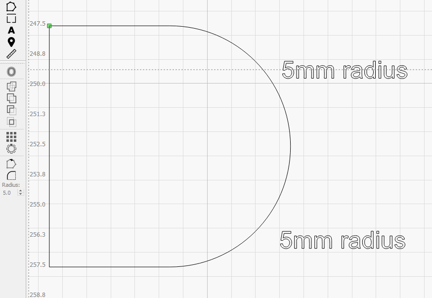

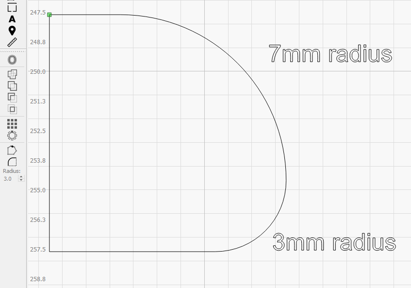

The radius tool also is limited by the size of your rectangle. If your side is only 10 mm, a 10 mm radius will extend all the way down to the next corner. That will not leave any room to radius that corner as the full line has been used. You could also use a 7mm radius and a 3mm radius because the total does not add up to a radius longer than your line.
OK, that solves the puzzle… the radius value was too big…
