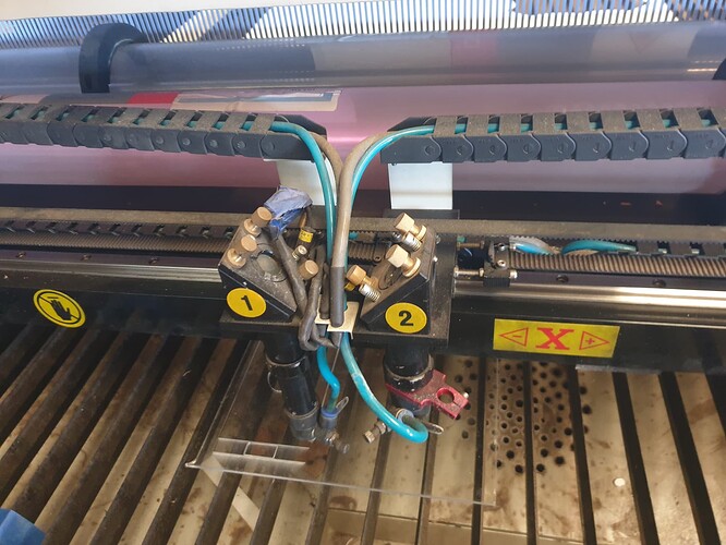

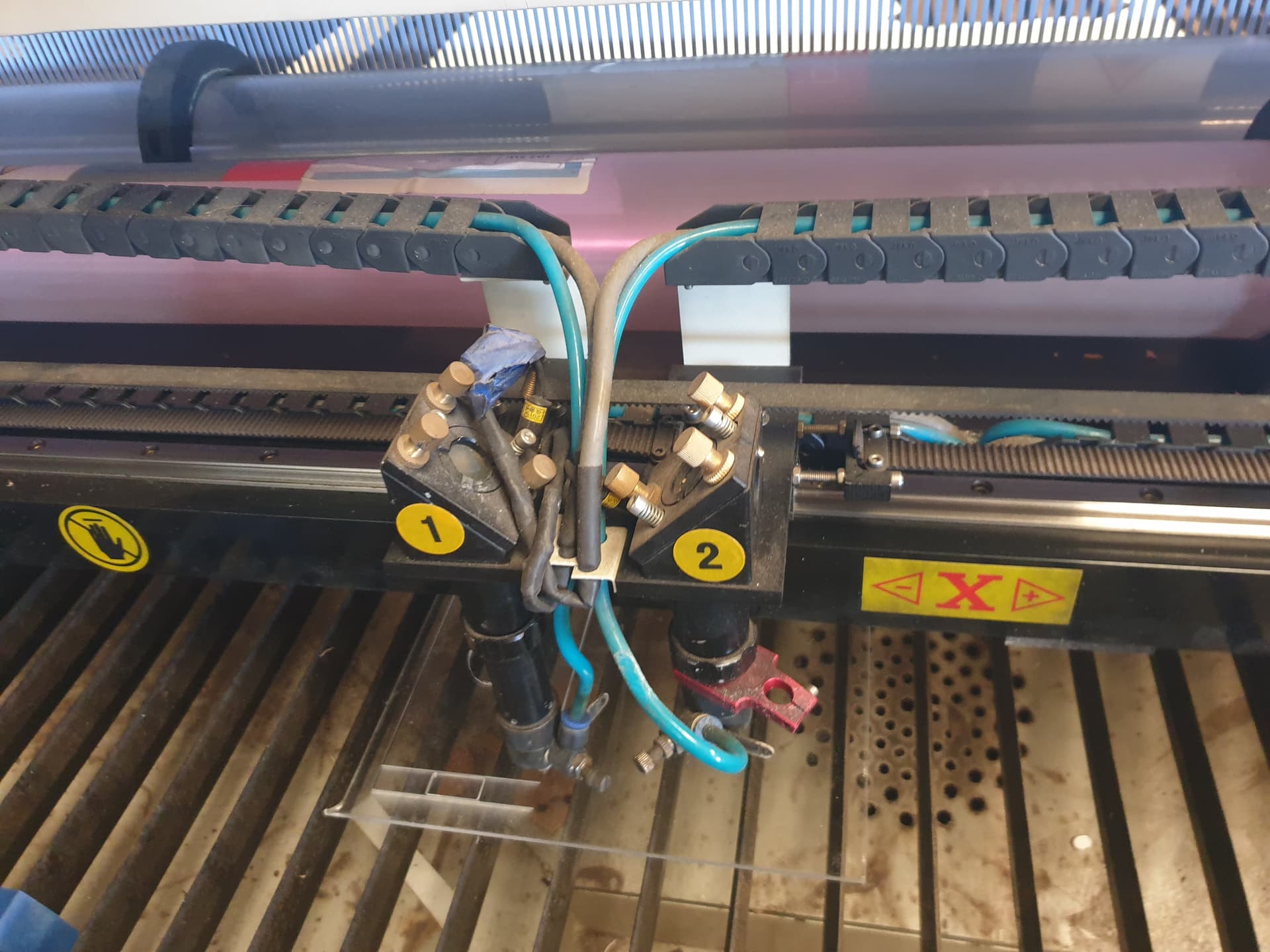

The X stepper is smaller than Y, as it only has to move the chain and double heads, whereas Y has the whole gantry, 2 tubes, water and all, to shift - much more interia.

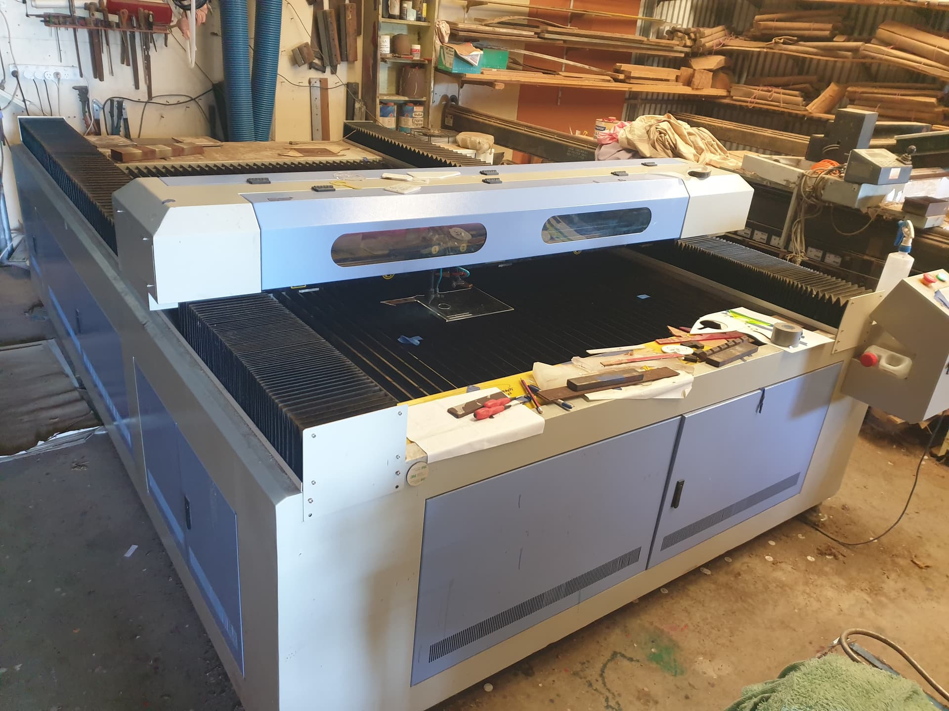

Here you are, Jack - photos as requested!
(It normally gets covered up with fitted sheets for dust purposes.)
That’s an old but mighty useful router to the right- it’s 33 years of age!
Thanks… What a monster…
Loved the pictures, thanks again…
