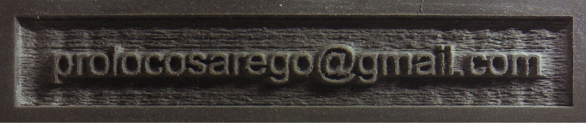

Sure, i’m doing lot of works with this setting on rubber stamp, and results are greats (as you can see in the attachment, considering the text is 2 mm height). The only problem is about data transfer speed.

I’m not questioning if you’re getting good results or not. I’m questioning whether or not your results are actually in the level of 1700 DPI. They may be far lower either from laser limitations or material limitations. If that is the case then you’re making the file larger than necessary or desired.
Looking at your sample I’d estimate that you’re getting an actual 153 DPI. I based this with the assumption that height of letters like o, c, s are 2 mm. But if the height of the complete design is 2mm then DPI would be even less. It looks like there may be some overburning occurring which may be actually reducing the perceived DPI. You may be able to get higher perceived resolution by reducing the DPI setting in that case. Again, I encourage you to run an interval test to test for this.

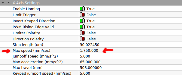

This is mine, with the max set for 1750mm/s. It was originally set to 500 or 600mm/s, can’t remember exactly. My machine will run 1650mm/s because of it’s modification. I had to change the controller settings to allow the machine to use that value.
Screenshot from 2022-07-18 11-09-47
You should check yours and see what your maximum speed is and that will tell you what your maximum speed is.

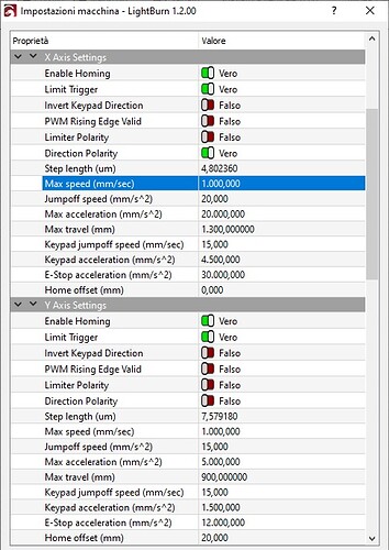

Hi guys,
i’ve checked actual settings on Ruida controller, and maybe can be done something better (watching @jkwilborn picture). Any suggestion about how and what modify?

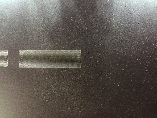

But at the same time i’ve seen a problem on change direction in fill mode as you can see in the picture below: starting from the bottom, you can see in the right side when the head change direction from right to left the end of the line is distorted, and same thing appends on the opposite side when head change from left to right.
(this appends only at slow speed, under 400 mm/s… over this value lines are perfect)
I think this also reduce my stamp quality, but i don’t have any idea how to solve this.
I suspect the head is oscillating (resonance) a little after it changes direction.
As you increase the speed the overscan probably hides it.

As you can see in the picture below, nothing changed: at slow speed we can see a distorted line. When i increase speed, the problem will reduce.
I’m checking if evrithing is tight, and nothing appears loose
The only other thing I can think of is that it’s mechanical. It still looks like harmonics to me…

  2. The wobbles on the return pass in engraving are from the ‘bounce’ due to the gantry inertia as the steppers try and accelerate the Y advance after each X pass.
    They’re clearly a dampened or shock-absorbed wobble.
I solved it by editing the Y scan acceleration low, and the speed to about 2 mm/sec - since it is only moving 0.08mm per pass, or whatever you have set it at, then a low speed is not going to be trying to force the gantry at a high oomph and immediately slow it down all inside of 0.08mm.
