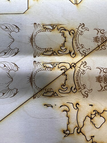

I have a StingRay from TTP Laser running a Ruida 6445G controller.
Several issues occurred tonight. The first time I thought I did something wrong, the second time I know I did nothing wrong.
The first time I tried to run my project the laser suddenly went all the way to the front of the machine and started burning the Honeycomb grate even though it was set for user position and I set the Origin for the back right corner.
The second time I noticed that there were random horizontal lines being engraved, in addition the cut lines were completely off from where they were supposed to be and then suddenly while the machine was cutting it suddenly moved diagonally across the whole project to the back right corner and beyond, I ended up hitting the emergency stop button. I am not sure whats going on but something is not right.

Talked to TTP this morning and ran the same file in RDWorks and zero problems it engraved and cut fine so its not the controller its definitely Lightburn
In Lightburn the laser head would move left to right horizontally then suddenly stop burning go way out of range in a square motion of the area to be burned and then would resume. Basically it was like someone hitting the frame button but it was not going around the actual perimeter of the file.
In RdWorks the laser head went left to right line by line it never did what was happening in Lightburn

I bought the file from a reputable laser file seller on Etsy. The file came in multiple formats Ai, SVG, PDF and the Corel file format.
I ended up pulling it into Adobe Illustrator and exporting the file as. DXF file then pulling it into RDWorks. I did not use Lightburn conversion.
The SVG file ran in Lightburn failed the first time by going way out of bounds even though I checked the frame and the frame was correct.
The second time it did the wonderful diagonal across the workpiece for no reason. So something is happening with Lightburn. What I do not know.

Running a DXF of a file in RDWorks and an SVG of a file in LightBurn is not the same, unfortunately. Unless you take an RD file exported from LightBurn and run it from RDWorks it isn’t really a true test because:
  • Converting an SVG to a DXF changes the structure of the graphics themselves, very likely converting curves in the SVG to short line segments in the DXF
  • Unless you are extremely careful, the settings between the two will be different
  • RDWorks will order the graphics differently than LightBurn will
I’m not trying to say there’s no chance it’s our fault, just that there are too many variables at this point to say that conclusively.
If you can take the LightBurn project file you’re working with and email it to our support, we can try running it on a system here, and look at the file to check for settings issues.
You can also try changing from “Serial/USB” to “Packet/USB” in your device setup (or vice versa), as some computer systems seem to do better with one or the other, though I’ve not found a pattern as to why.

Something I would like to know is…did you start the job at your machine using the ‘Start’ button within LightBurn?
If so, I’d be curious if you could reproduce your issues if you use ‘Send’ instead?
Using ‘Send’ is a more robust method since you will receive feedback if the whole file makes it such as, “File send successful: 914 Kb @ 314.6Kb/sec”
…which is what I saw when sending your “winebox_” file to my ruida controller as a test. I didn’t run your job file as it’s bigger than my laser allows, but the job itself looked fine, and looked fine at the preview on the control panel screen also.
Worth mentioning here, is that (for DSP controllers) if you hold Shift when clicking ‘Send’, that will auto-start the file after it is fully uploaded to the laser, as opposed to ‘Start’ where the controller will immediately start the job as soon as it has received just enough of the job in it’s memory buffer - with no regard to consequences if the tail end of the job doesn’t quite make it!
Speaking of memory, it is also good practice to clear the ruida file memory from time to time, because when the controller memory gets too full it becomes slow and glitchy.
