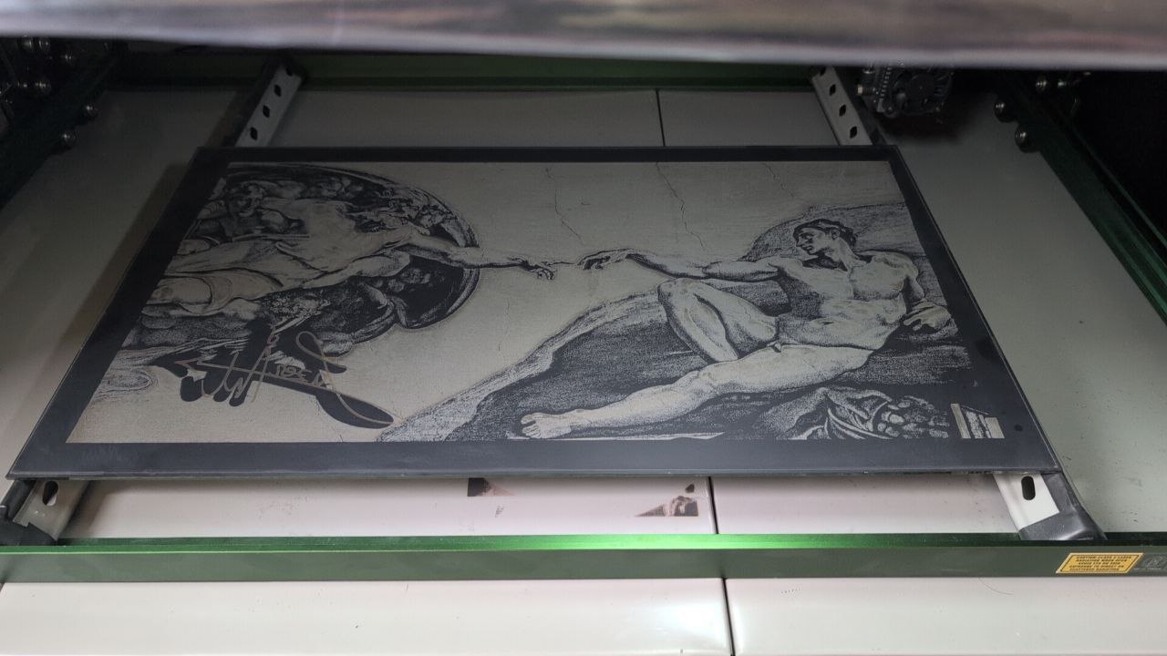

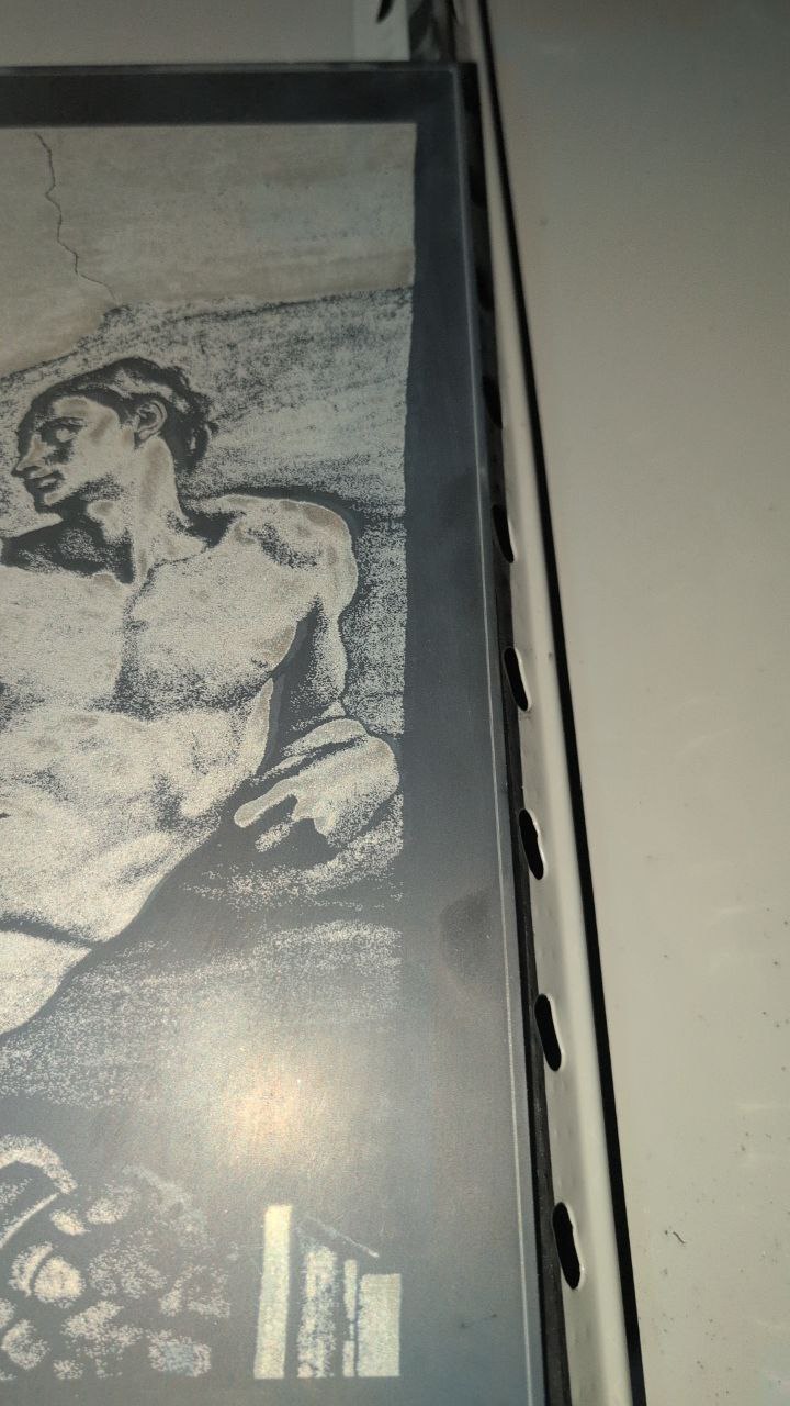

Here is the engraving, it’s an image run on mirror with Lightburn Atkinson algorithm (as negative). You can see the external engraved rectangle (running close to the external edge) and that’s a STRAIGHT rectangle, nothing strange about it; it’s made before any other engraving for later/eventually need to realignment. Engraving is run after it and it starts from the correct offset (bottom part) and then going always skewed to top right (see second image for detail). You can even see (first image) my signature made after image, it comes offset from initial image mask (it’s supposed to be right in the middle of mask).
After this first engraving, I’ve reset my machine (NEJE MAX 4) and then re-aligned (with big rectangle) and re-run the engraving with 0,5 power to just see if the ending point will be the same and… IT WAS ! Same final offset, signature would have been done again in the same offset position.

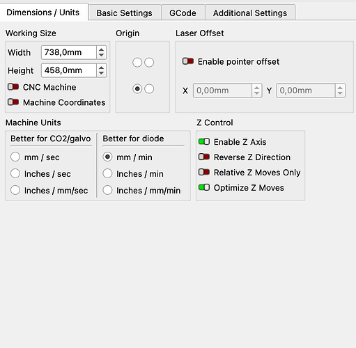

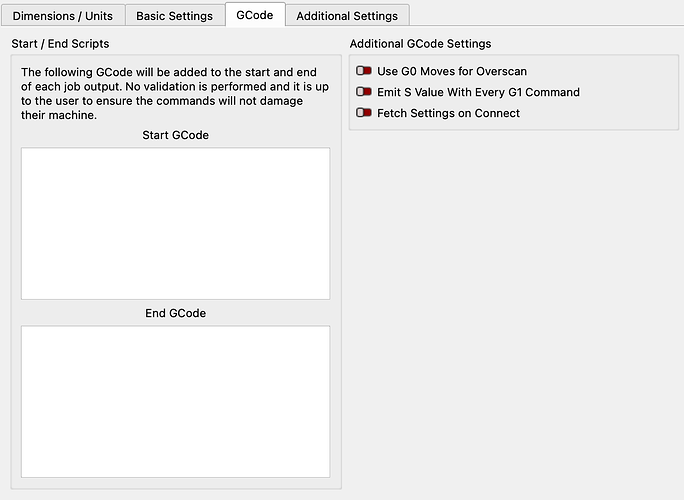

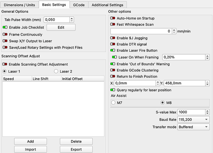

Question, could you share your Laser Tools > Device settings
Screenshot of all tabs please
Try this for me please
disable “Query regularly for laser position”
This basicly keeps sending ? queries to the controller, which might be causing some latency on the serial port.
I’m sorry to say, but it didn’t solve the issue, G-code remains the same. I’ve also installed the Lightburn 2.0.02 but didn’t help aswell… I’m from a Mac btw

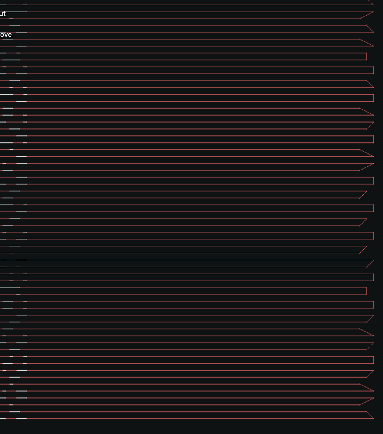

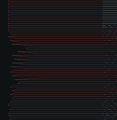

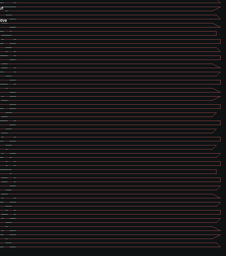

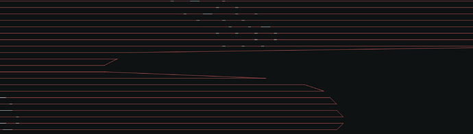

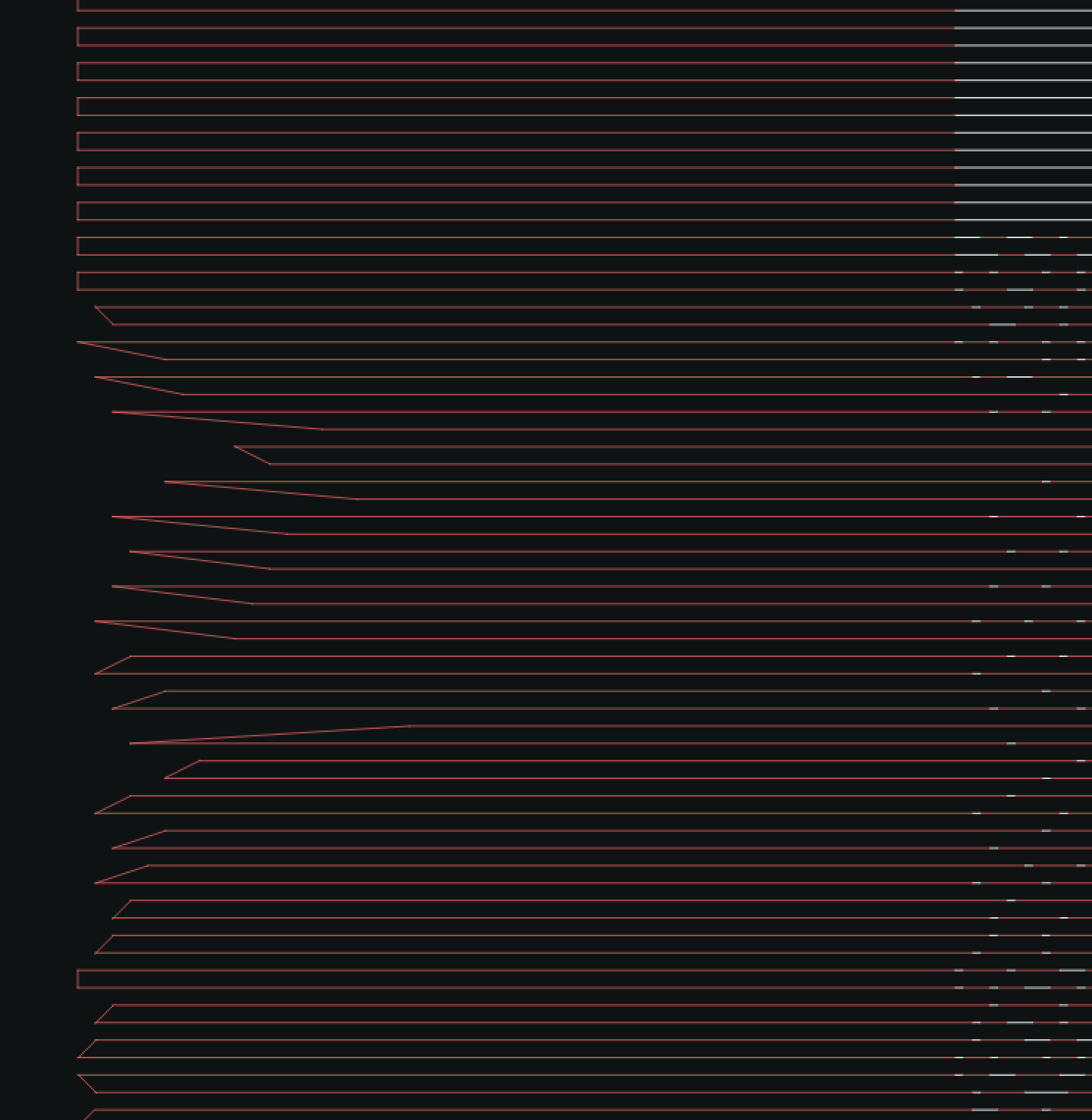

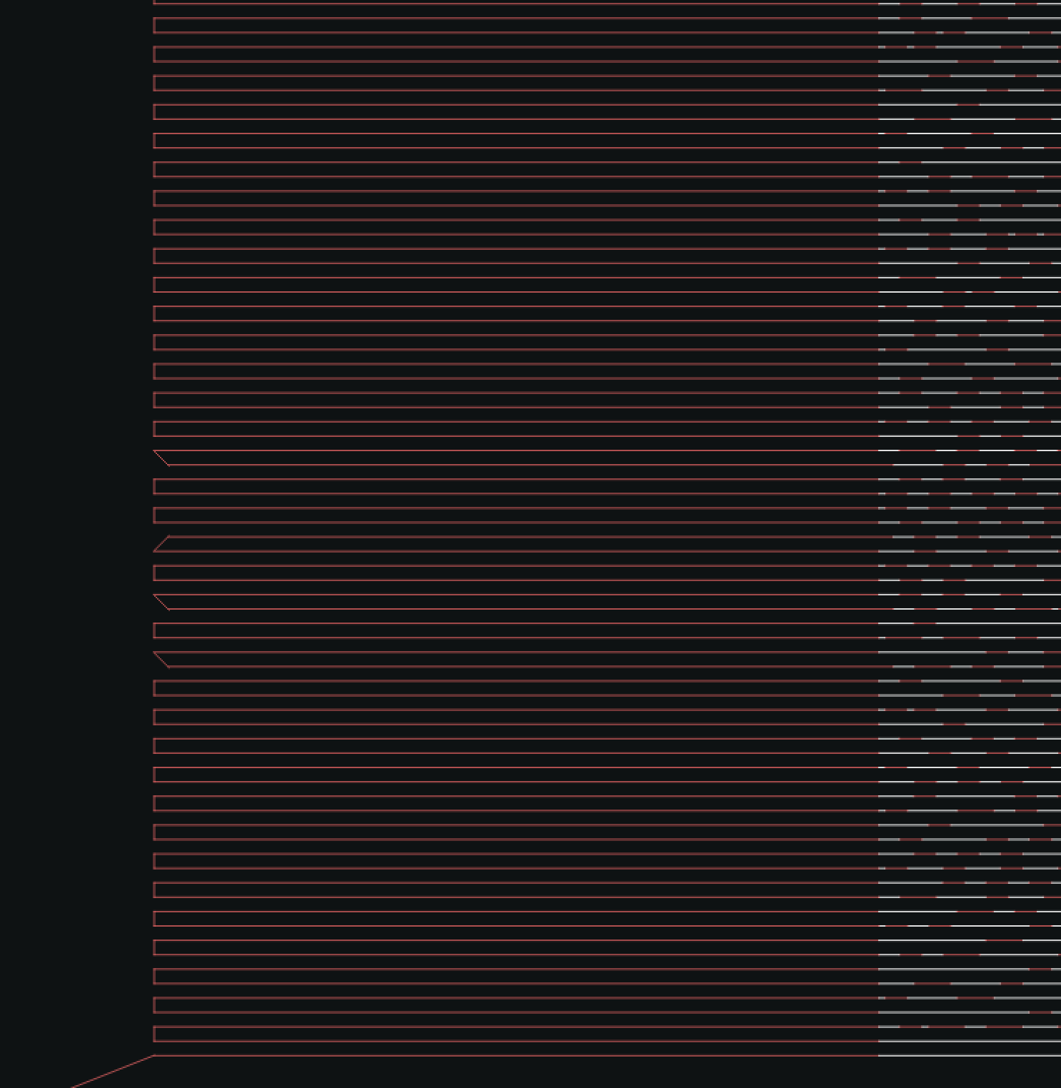

I’ve opened the preview with traversal moves and it is really made like that zig-zag … is that the correct way? Moreover I also please you to notice some really oblique lines here and there
I feel like the Y movement computation is blend together with the next line delta, you can see where lines start at same point (X) the corresponding Y travel is correctly 90°
I’m thinking about that query / latency … it should affect both ways left and right, shouldn’t it?
