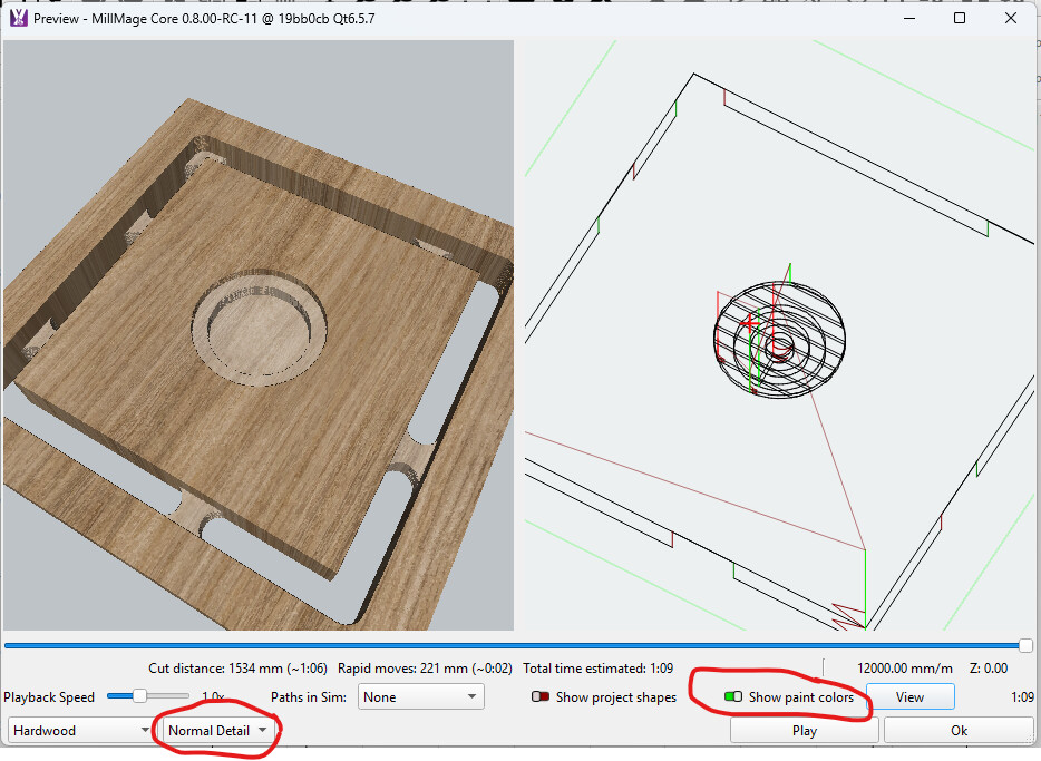

Preview is very crude. It does not enable a true 3D viewing capability, you can barely see depth especially in default wood mode.

Experiment with the various options on the preview window. The ‘show paint’ color toggle and level of detail drop-down options might help with the contrast. I’m sure the developers will add additional choices here over time.
