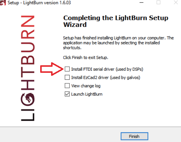

Why can’t my RD software connect to Lightburn? (RD8445s version),I need help。
RD 8445 only supports USB at this time.
TCP Ethernet is coming.
How are you connected to the laser ?
yes USB,But the device cannot be detected in the software. Is my Lightburn software version wrong?
You must have a Pro License… or are you using the trial ?
You may also need to install the FTDI serial driver during the LightBurn installation.
