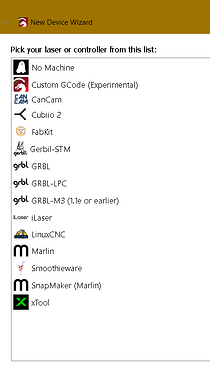

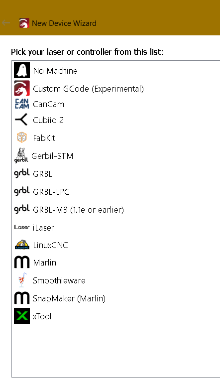

You could try creating a new Device (Snapmaker (Marlin based)) and check if it works. But keep your current one!
Ok, it seems to work with a new Device. Why? I don´t know :smiley:
Check if everything works. If all ok stay with that device.
