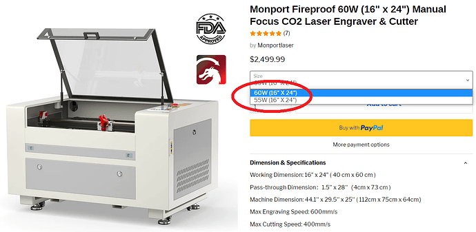

I like how the “Product Details” picture (next to bottom) touts its “55W Powerful Laser Tube” … :grin:
The overall cabinet is 112 cm = 1.1 m wide, which means the tube probably isn’t even 1 m long, so it’s barely 50 W and might even be a 45 W tube amped to a dangerous chattering whine. FWIW, OMTech did the same thing in my “60 W” 700×500 mm red-and-black laser with a 1 m tube likely rated at 50 W.
On the plus side, the cabinet looks like it has a front pass-through hatch which you can use as an air entry port to get good flow across the material and down-n-out through the rear honeycomb.
They don’t give a weight, but if you’re thinking of casually lifting that puppy out of its crate onto your benchtop, you’d best sign up for physical therapy right now …
I did have a brief email discussion with a nearly English speaking sales rep about the fact that all the documentation says “55W” as well as some of the support files… but he assured me it is a true 60W laser tube. For what it’s worth.

@ednisley is absolutely correct. The tube length will determine power output and a 50W tube is about a meter in length.
My China Blue 50W had an 880mm tube in it. It measured 44W with a Mahoney power meter. One person stated that I must be lucky or over driving it … :frowning:
Good retort from the salesman Trust me, why would I lie?

I think you guys are both right… it sounds like they are just overpowering a 50 or 55 Watt tube to claim 60W. Apparently on their website you can order the laser either way:
Both are the exact same price… the fact that they are, hints to me that there may not be any physical difference between the two either… they just installing the tubes that test better and calling those 60W. Then if you look closely in the further marketing materials:

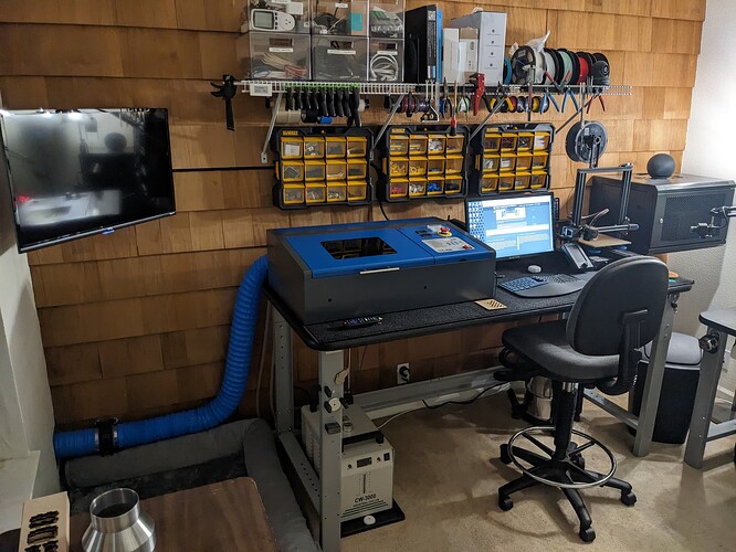

I have modified mine with parts from Russ Sadler and other sources to get a nice working machine. Took time and extra monies. Cloud Ray commercially makes a Russ Spec version of their lasers.
With the exception of the honeycomb, that I pitched, Left, basically new. Right, how it looks now.
This is the actual head assembly. Mine was a 5030, but with the head modification I get an extra 30mm in either X or Y direction. Notice the left photo has a drag chain, the center does not. I can/have run 1650mm/s … Great fun, but it’s academic. It does have a very dramatic effect on the job time as the head turns around very quickly, so very little overscan. I run accelleration values in the 45,000mm/S2, a bit higher than stock.

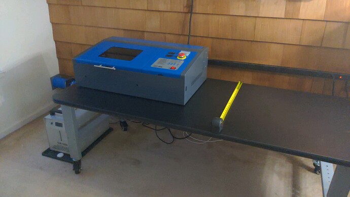

New Monport 60W is going to be delivered today… kinda excited about this.
I’ve cut the legs down on one of my workbenches and put some nice heavy casters on it.
This should put the working height just about right. The tape measure represents the size of the new laser (everything to the left of it) compared to my existing K40.
I’ve got a 120 degree field of view camera to mount (magnetic), and a new 6" duct system with a nicer inline fan to install. Just have to drain my chiller to switch over to the new laser.
