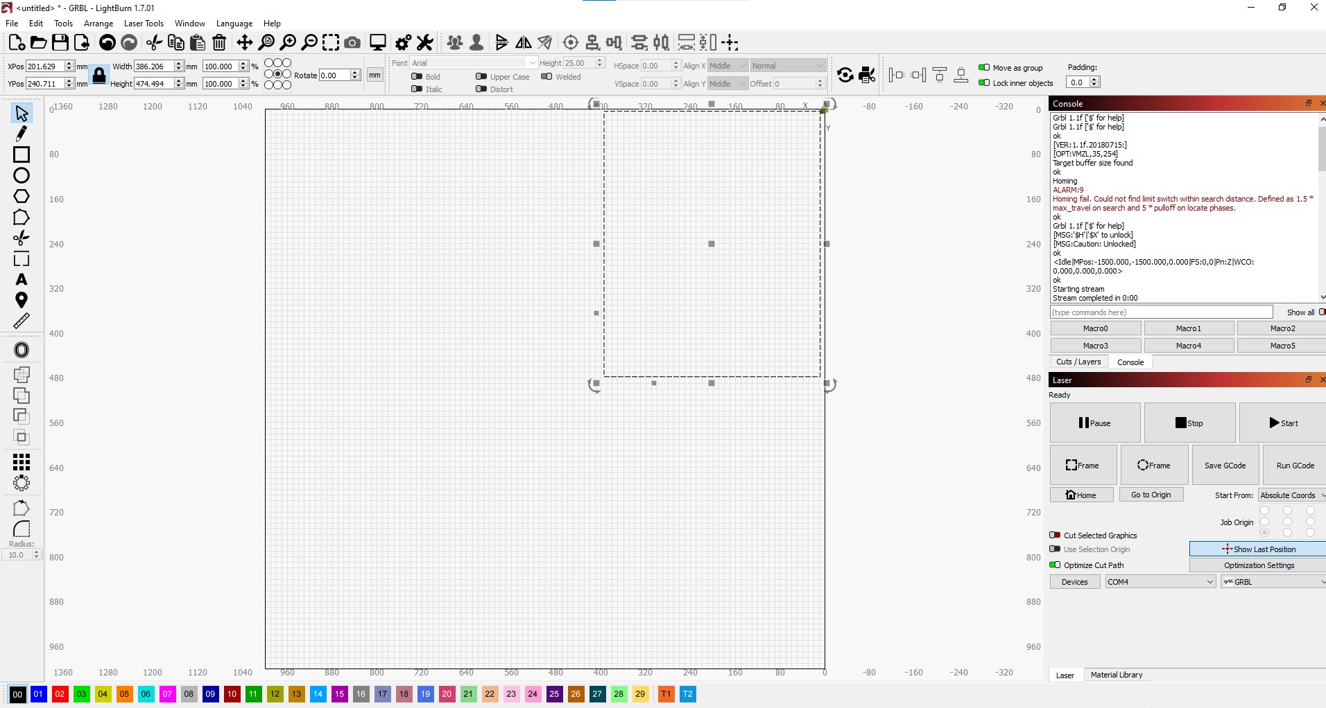

Thank you for the encouragement and because of this I have now managed to do some shaapes and fill them, great stuff, my only problem now seems to be the working area being restricted to the top right of the grid in he space I have lined on the screenshot, if I go outside of those lines the laser bounces on the frame. Is there any way I can line up the grid to correspond with the laser bed so I have a full screen to work on.

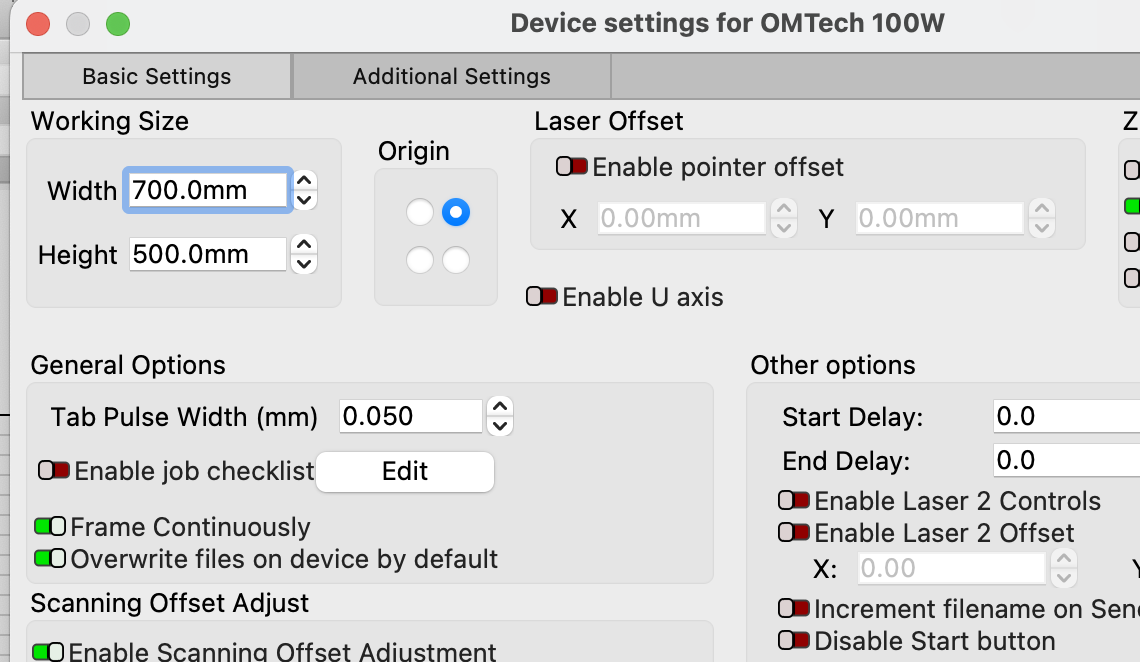

In “With” and “Height” you should insert with and height of your machines laser bed.
This should happens because your are set “Absolut coords” in “laser” window.
If you change for “User origin” or “Current Position” that only happens if the dimensions of your project go thru laser bed dimensions.

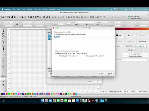

It’s easier for me to make a video than type it out with screenshots. You need to change your work area in Lightburn to reflect the actual size of your laser. i shoiw you how.
You may need to change the dimensions in Device settings also. Wrench and Screwdriver Icon.
