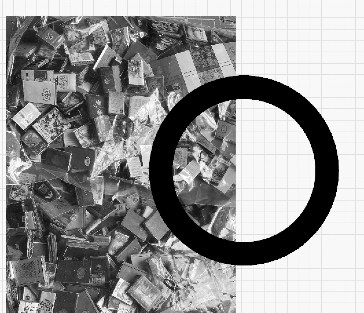

I am trying to place a smaller image that I have traced over a larger image that I have traced and want the smaller image to block out what is behind it. Hope I explained it better
Another lightburn user told me to use the “rear minus front” command and I can not find it
something in this direction?
wan tto remove what is in the circle
First select image then the circle and use “cut shapes” from “Tools”.
Is that what you want?
Thank you so much I was looking for the rear minus front and was not finding it… Appreciate your help
