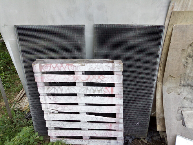

I’d put in a steel bed. Nothing is worse, if you want proper air flow than honeycomb. Air need to flow across/under the material to be useful. A honeycomb bed allows air to bypass the actual working are and just go down the holes…
Besides that, it just wipes off with solvent, you can’t do that with a honeycomb bed.
The supplied honeycomb lasted less than a couple of days, then I changed it out.
This is cutting 5mm sub flooring with a fully open lid and original ventilation fan, which are pretty poor.

Industrial walkway grates are usually “flat” within +/- 2mm tolerance or so when new, and while that may be ok for CO2 in some cases (and such grates are used extensively with oxy-acetylene- and plasma cutting in DIY circles), it’s unlikely that it’ll be enough for diodes.
Those grates aren’t exactly cheap either, at least not over here.
Because these grates are also more than likely hot-galvanized:
a well working fume extraction like You seem to have at the cutting spot is absolutely necessary in order to avoid zinc-fever and other zinc fume related nastiness.
And obviously under-bed extraction as well, just as with any honeycomb for multiple reasons.
There are stainless steel varities of industrial walkway grating available as well, but the flatness tolerances are even worse, and the price is a lot higher.
