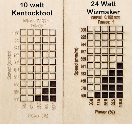

Recent 24 watt diode laser engraver seems to be putting out 14.5 watts on materials test
I received a 24 watt laser from Wizmaker which seemed to be well constructed, not the flimsy 2020 rail construction suitable for lighter weight laser modules.
Once set up I ran an immediate materials test on 2.7mm bass ply and did the same with my current 10 watt. My 10 watt produced a clean cut at 456 mm/min while the 24 watt maxed out at the same settings at 611 mm/min, approximately 1.4 times faster or 14.5 watts worth of cutting power. When I queried support, they stated that that is normal and that their 36 watt laser only doubles the cutting thickness of black acrylic. Since we are talking apples and oranges, their response was meaningless. In prior evaluations of 20 watt lasers they seemed to double the cutting speeds for the same results but I had never done an accurate side by side on the same panel.
I am returning the laser this morning but would like to know if it’s me or the laser. Bottom line is that I need the cutting power of 24 watts for a forthcoming project and the Wizzbang isn’t going to cut it…pun intended!
To sum up I have assumed that doubling the power would allow doubling the cutting speed ± …is that correct?

UPDATE: Duh! If you look at the 24 watt materials test the 47.5% power cuts clean at 300 mm/min and the 100% power cuts clean at 611 mm/min. I ran a similar test on the 10 watt Kentoktool with 100 to 500 mm at 50% and 100% max and got exactly the same results. Double the power, double the speed. So it does look like Wizmaker is pedaling a 24watt machine that actually puts out 14.5 watts.

No outcome…dropped it off at UPS this morning! I may revisit Wiz with their “36 watt” unit. Maybe I can eek 25 watts out of it. I have confirmed above that double the speed, double the power, so if an unknown laser cuts clean at 600 mm and a 10 watt at 300mm, same wood, etc then the unknown laser would be around 20 watts. Interesting discovery…

I feel comfortable that if the only variables are speed and power then speed and power are directly proportional, On the other hand 4 collimated “6 watt” lasers may or may not produce 24 watts at the work surface. I have seen listing for lasers that state 20-24 watts for power output. But regardless of what this laser claims, based on real world cutting speeds, compared to a 2 year old 10 watt collimated laser, the output is 14.45 watts, a far cry from a claimed 24 watts. In retrospect, possibly one of the lasers wasn’t firing and I would have followed up with Wizmaker had they not informed me that my tests were accurate. They were, however, confusing cutting speed vs. power vs cutting depth which then has many more variables. They stated that it takes a 36 watt laser to double the cutting depth of a 12 watt laser…but of course cutting thicker materials introduce a whole different set of variable which a Lightburn materials test does not.
I will revisit the Wizmaker or similar in October when I get caught up on other projects, but for now I feel comfortable that the laser was, infact, defective. Assuming 4 x “6 watt” lasers theoretically resulting in ±20 watts at the work surface but should only 3 be operational, that would explain the 14.45 watts ± at the work surface. Unfortunately Senzhen has gone on their 5 day fall break so I decided to end the process of resolving the issue and simply return the product. I will have to wait up to 5 weeks for a refund.

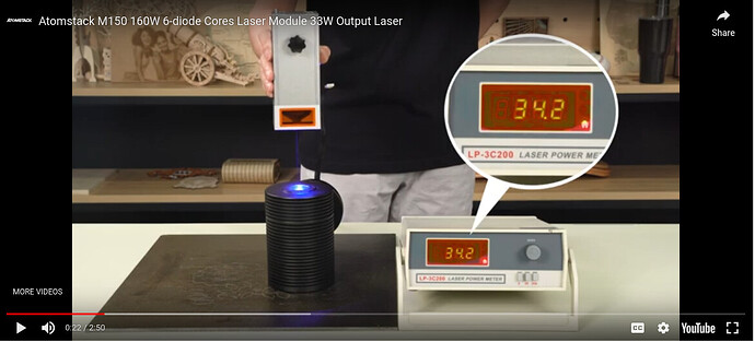

Surprisingly these are pretty powerful and have about a 5% loss…
The module consists of 6 - 6W dpssl (diodes). If you notice they lose 1.8W through the mirrors/combiners. They seem to perform well … Hopefully this one module wasn’t picked out because it had superior performance. :thinking:

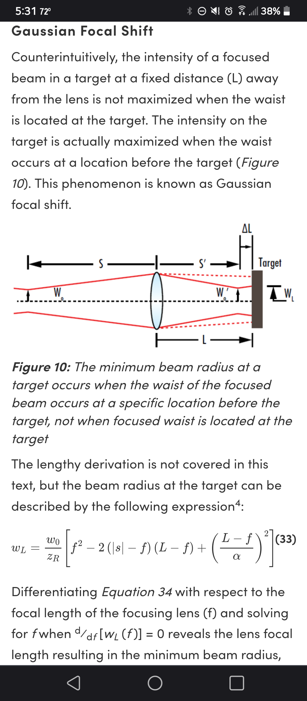

I believe this helps explain intensity vs optical focus… I assume locating the waist at the workpiece surface would be optical focus.
Many maths and words
I think when I burn a line on a ramp test, I can tell where the best distance for focus is…
I don’t think I can do better than actually measuring it?
I’m willing to make adjustments…
I’m sorry, this makes no sense. Is this a coherent beam of light or something else? It certainly doesn’t apply to visible light optics where the focal point is always on the “film plane” (sensor plane, retina, etc) Please elucidate!

It’s from EO Edmund Optics: Laser Optics Resource Guide > Section 2.1 - Gaussian Beam Propagation.
There’s a ton of highly technical details there. Dig in, Professor. My math skills aren’t great, so most of it’s over my head.
