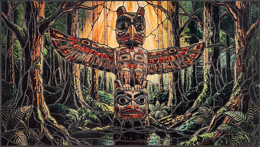

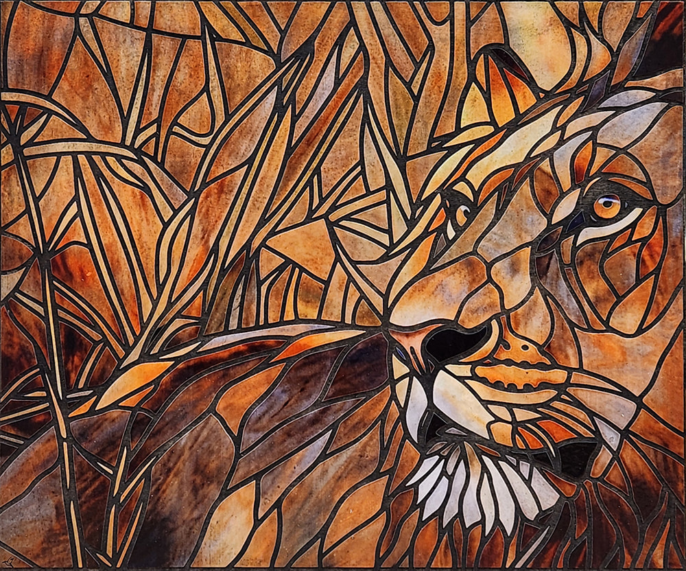

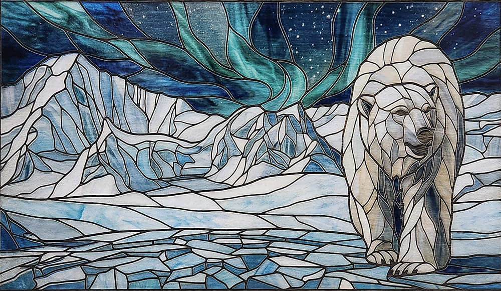

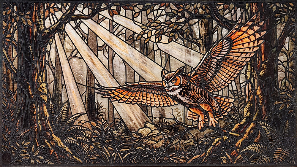

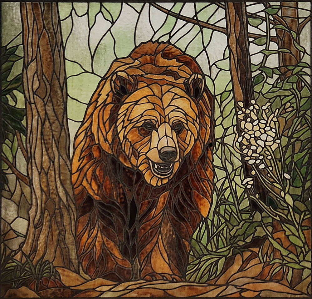

Recent laser cut original designs - faux stained glass effect
These are all laser cut on Okoume 4mm plywood. Original designs are dye sublimated onto the plywood, then the lines are engraved out and darkened.
