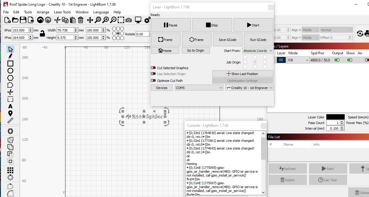

I was able to engrave stuff again, but the center point is now off, and I had to push the engraver head to the location then hit “Frame” from there before running this test.
When I tell it to “Home” it goes into the lower left corner but with the graphic in the center when I hit Frame it runs into the corner as if it is trying to recenter.
My point is down in corner and should be in the center, correct?
Have yet to find the button that lets me move it, but I am also doing other things in the office this morning.
This suggests you are using Current Position instead of Absolute Coords. Can you do a screen capture (WinKey-Shift-S) showing your Move and Laser windows with the workspace and put it in your Reply? Do not change anything first…
You were so correct.
Here was my first selection by default and then Absolute Coords as you suggested,
and it now goes where I was expecting it to.
Reason I guessed right is because Lightburn keeps defaulting my coordinates to Current Position and my Retract macro bangs the frame. I have no idea why it happens.
