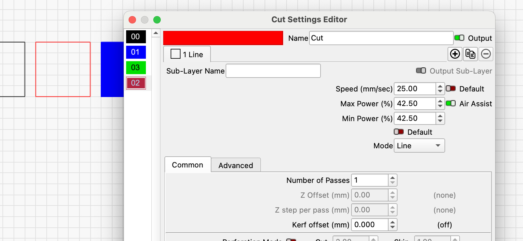

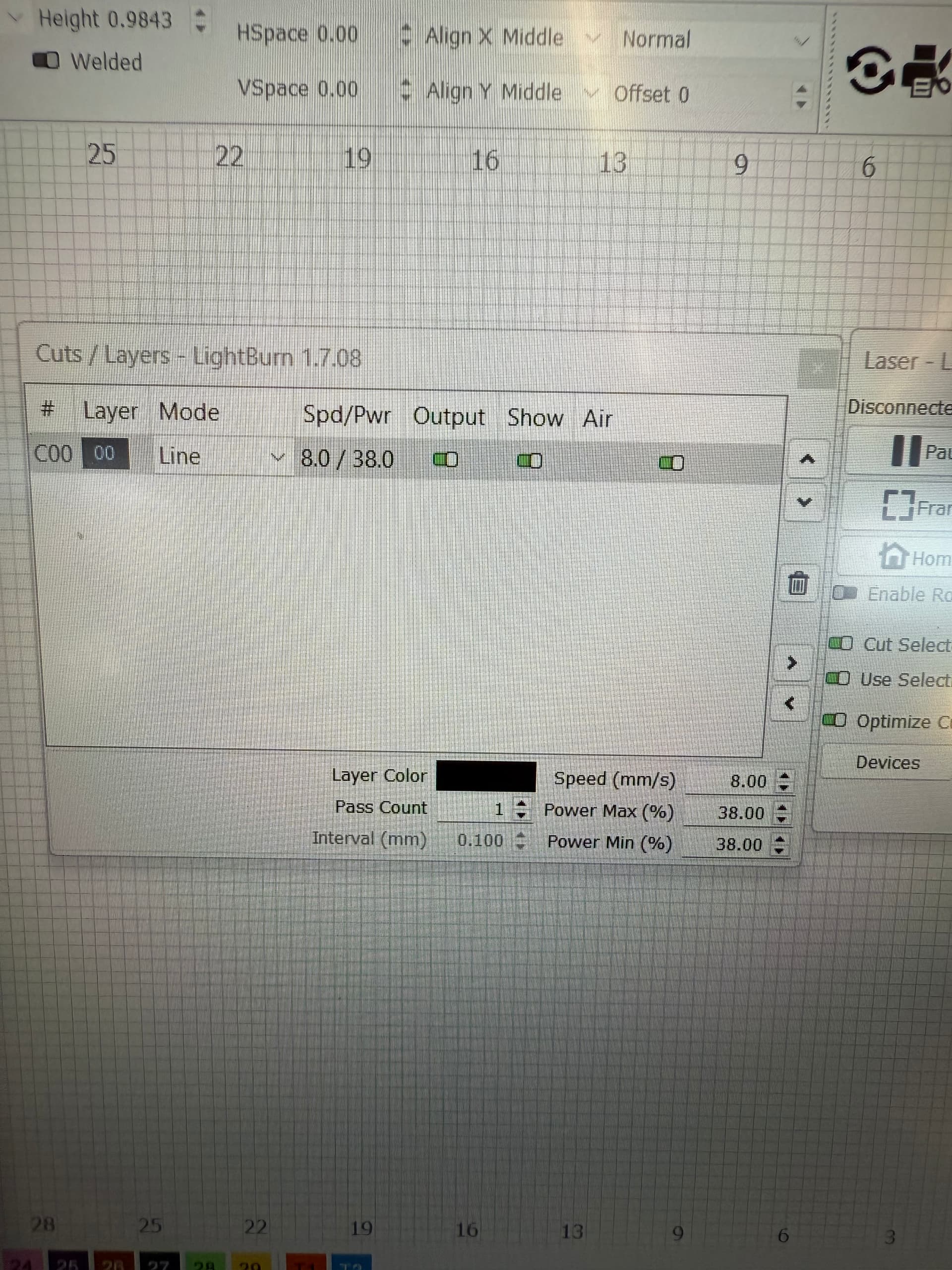

I have OMtech 130 Co2 and for some odd reason if I use the color layer Red or Black to cut through material it will not. If I use any other color, it’s not an issue and cuts normal. Any ideas would be helpful

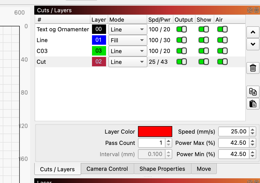

You need to post a copy of your settings.

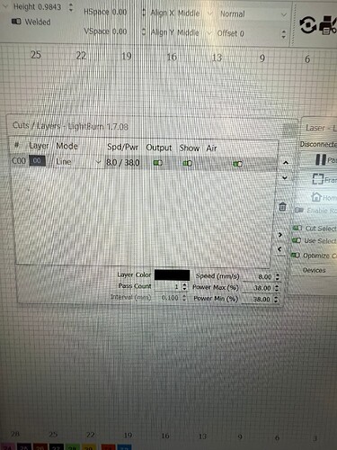

Red and Black do not cut, my settings are set to cut 1/8” birch, power and speed set to cut. Change it to fill and works just fine, cut does not. It’s just these 2 colors.

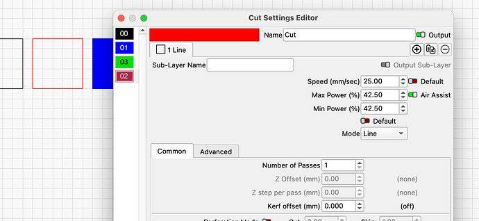

Post up screenshots of your settings and your preview page. The guru crew cannot help you solve your mystery without more clues.

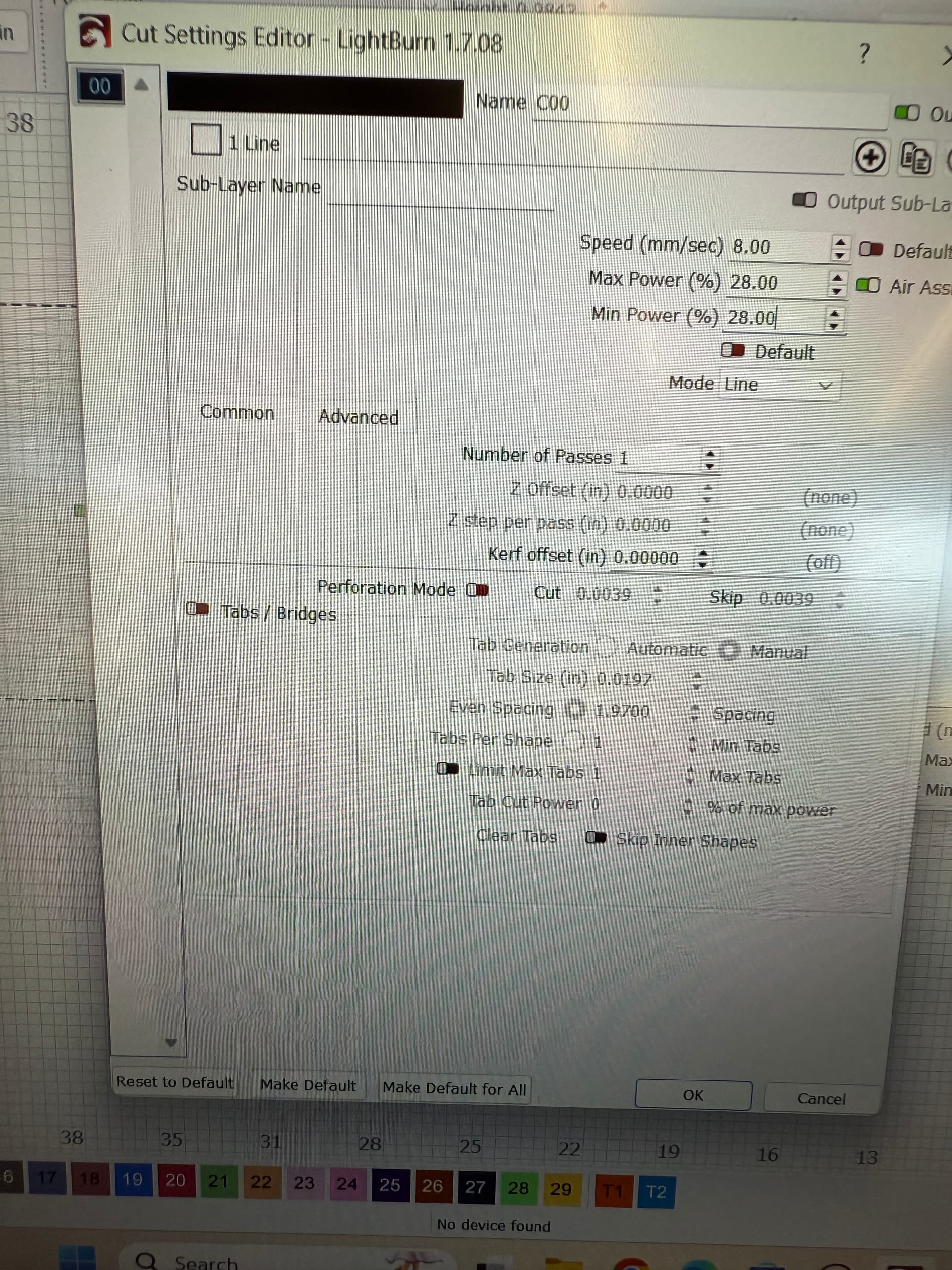

Your common setting appear to be ok, is there maybe something set in the advanced tab that might be causing this issue ?
